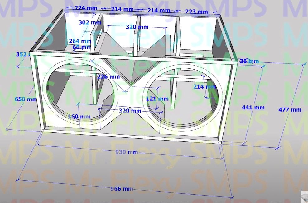

how i can simulate this ports
the design is on you tube it is for dual 15's
the thing is the guy says , use any 15 with big xmax
i think that is missleading as every box is adjusted to a certain driver not one designs fits all , right ?

there is dual BR boxes that are basically 2 single chamber ones melted together
but this design share the chamber with the 2 drivers
is there an advantage to it ?
but 1st i want to know how those triangle vent ports are calculated

resistance of triangles vs round or slot ports,
Maybe it's better to model the port using a kind of segment that hornresp does't use port correction. Check the example in the link below. In your case you can use just the segment H1 where S1 and S2 will be the triangle area (sum both triangles) plus the length to achieve the tuning frequency you need.

If you model using rear chamber port, them you need to follow Kaffimann indication.
maxolini,
One more comment, as highlighted previously, the simulation KaffiMann made for you represents a different Bass Reflex Design compared to what you are going to build, he used Offset Drive witch take into account the driver position in the frequency response, see the link below a similar design (double driver is just about use two side by side placed at S2 position). If you are using that simulation as target and you are doing a new simulation more aligned with your current design, ok, you are doing the right thing.
https://freeloudspeakerplan.rf.gd/pages/vbslot1-b.htm
