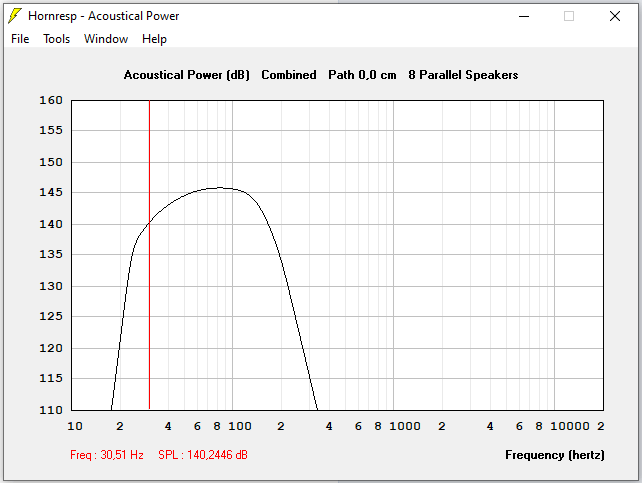

Dilema on what route to take double 18s reflex or TH
sigh Wish I had 8 of those, if only for bragging rights...
I'd say that's a pretty good number for a total of less than 5000Watts of power.

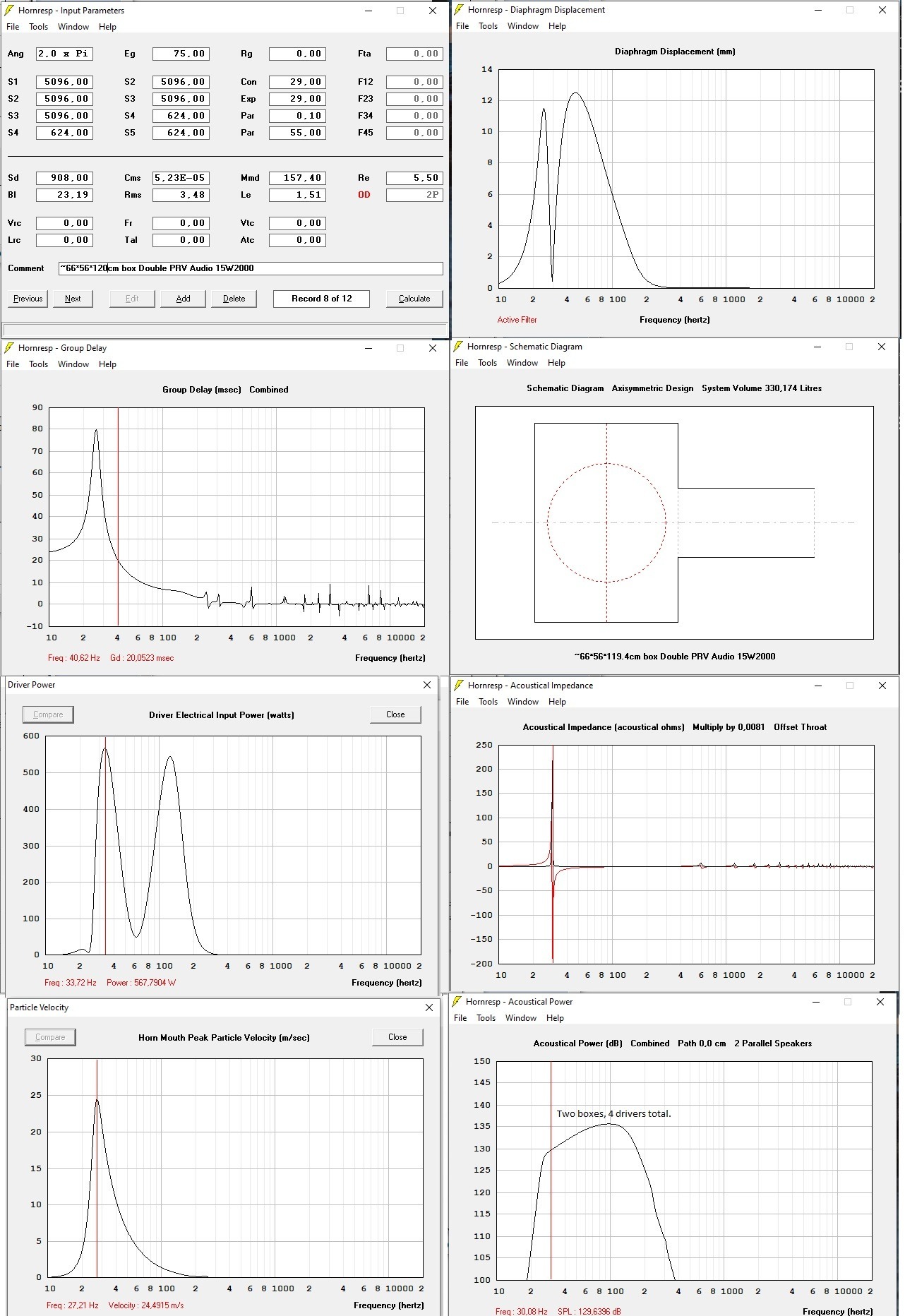

Big thanks to Kaffi who was kind to calculate the hornresp and cut list for the box on his scarce free time gaps , still pending is the assembly layout diagrams
i need help ,somebody with sketchup chops and port knowledge so to sketch the box and layout the port shape size.
lol i dont like tubes, i like bass boss style vents, Lacostics KS28 yeah but cant make those flares, 18sound cabinet vents are nice also, any but ugly tubes
fact is that i dont know how to tune calculate all the acoustics involved, im being guided by Kaffi

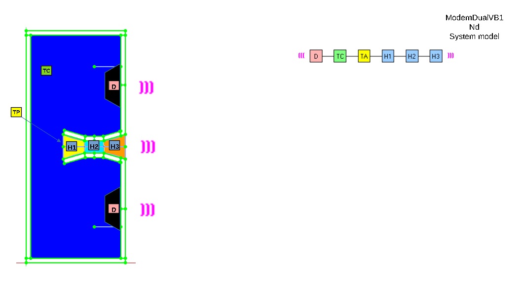

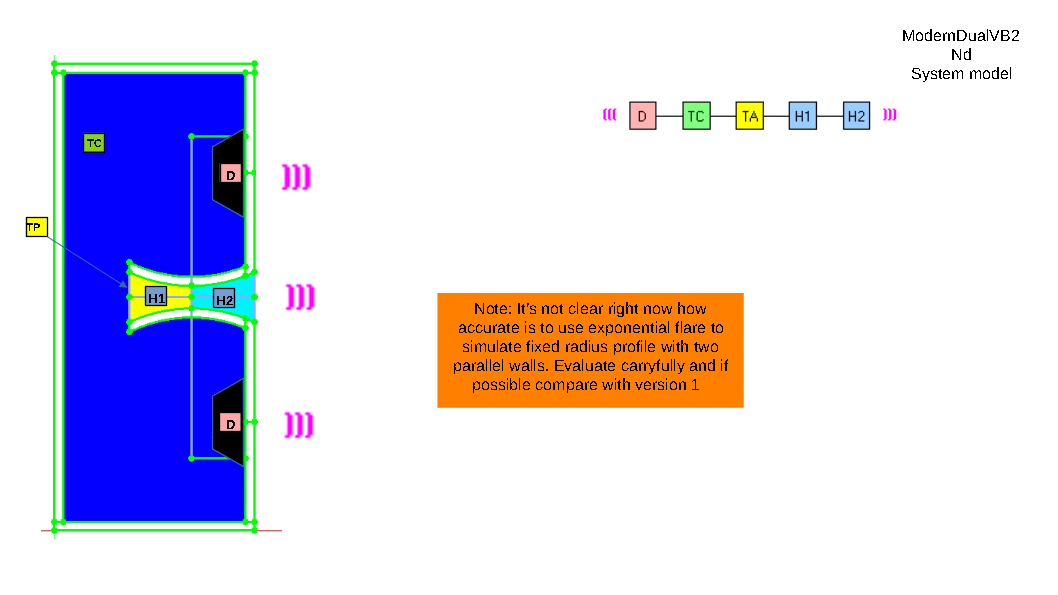

The plan for KS28 is available as the name of ModernDualVB2, The curved flared for the vent is simulated as exponential flare, we don't know precisely how accurate it is, but also talking with David it looks a good approximation. ModernDualVB1 is also an option with 3 parabolic segments which for sure is accurate.

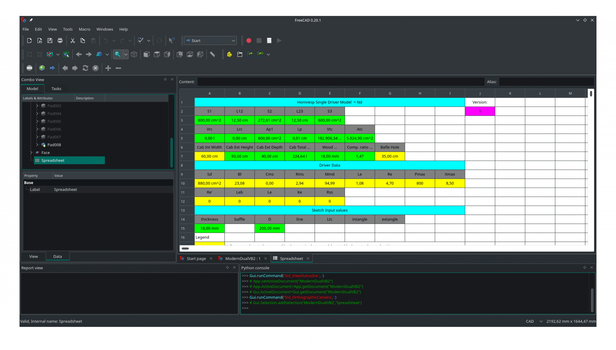

Beside we suggested previously, I would just to reinforce to you to use CAD software to check your Hornresp data. Everything was already done for you, you would be surprised how easy it's to use. Is a kind of step you need to do it before you spend money cutting wood. I don't think other mate would take this risk for you. You just need to adjust the dimensions inside the model and hornresp input data will change automatically, you can see trough the embedded spreadsheet so you compare with your simulation. See attachment #3.

You don't need Kaffi, looking to it's simulation, you can see through the Hornresp inputdata screen that he simulated a offset drive, you can see the OD indication with RED color, and the value is 2P because he use 2 parallel drivers.
You can also see that the Volume of rear Chamber (Vrc) is 0 and the Volume of Throat Chamber (Vtc) is also 0, so he is simulating a kind of transmission line for you. He uses 4 segments , they are:
S1 S2 + lenght + flare type
S2 S3 + lenght + flare type
S3 S4 + lenght + flare type
S4 S5 + lenght + flare type
You can see the he uses constant area (same number repeatably), so the the transmission line has no flare it's straight, in the transmission to the last segment he reduces a lot the cross section area from 5096cm^2 to 624cm^2.
Your first step could be trying to replicate that simulation on hornresp. If you mouse over any input it will give you an indication about what it is.

Lordsansui,
Kaffi calculated a 330 liter dual 15" bass reflex enclosure, we was looking at the yamaha CW218 dual 18 cabinet, i settled for a 15 driver the PRV 15SW2000 , so the horn resp data is that drivers on a 330 liter box, no tapped horn or anything, just a dual 15 front firing box, since i do not want to use round vents , kaffi is doing some square vents, that are not posted yet, hope this clarify some your questions, all is in the thread but is getting long now.
i will post the real life freq response and build pics on another thread when i get the final plans and start the assembly.
right now i just need help to check that all match , you guys have many hours of flght time with horn resp, to me looks ok but im not expert.
