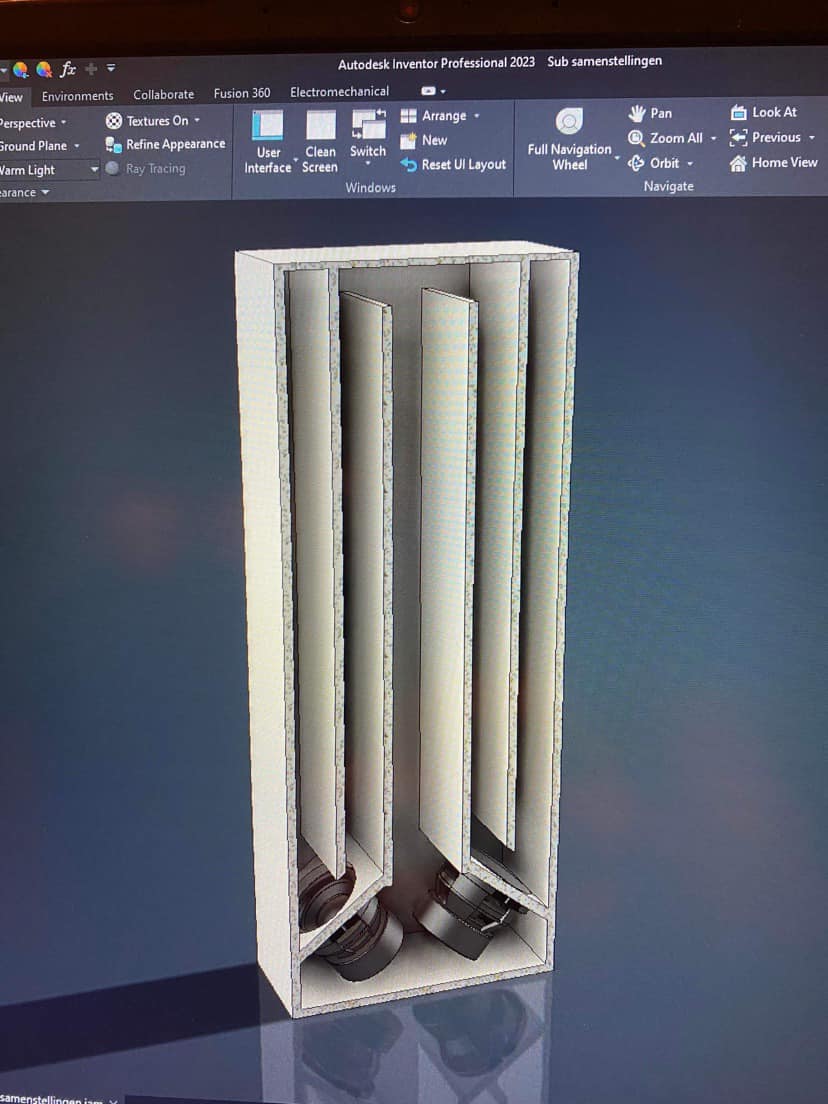

Hey Kipman,How low are you looking to go? there is a size/output/lf corner trade off.
freq is my second goal, i mean my 1st is the materials i prefer one sheet of ply instead of 2 or 2 and a half to crank up a cab,
from all the info i really liked the SS18, one sheet of plywood and budget 18" driver up to 130db with 2 of those with a 1500 power amp , that click all my boxes !!
, by the comments on people who made it , it is very good for what is it.
it goes down to 38Hz, so i am ok with it.

I'd suggest you to do your simulations first, check if the design and size matches well the driver you choose, them check if the panels really fits the single sheet plywood.
18" driver requires larger baffle size, and lower frequency requires longer horn length, both increases box size, so.... compared to SS15.... someone maybe made a trade off that you need to carefully check.
For instance, my personal project started from jbell SS15 but due to the driver I choose I end up with larger box.
