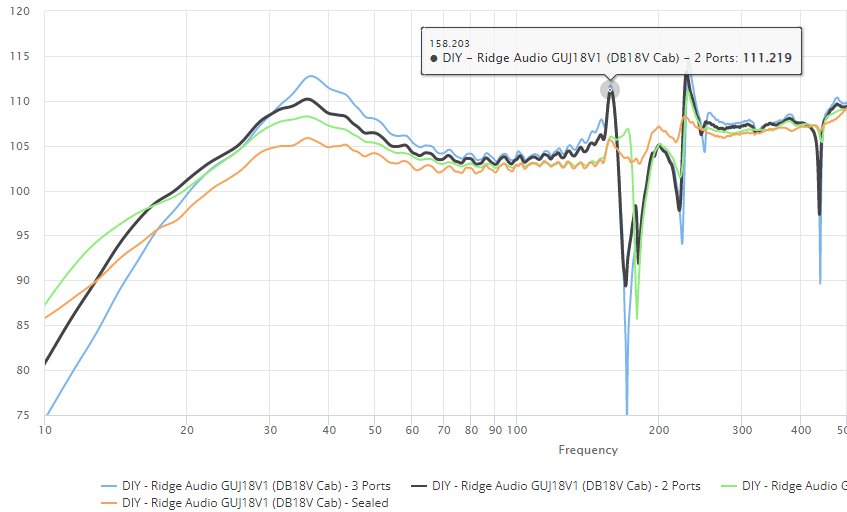

Noted.This box on databass illustrates port compression quite well (even though it has a relatively large port)
Not sure if they even sell this thing anymore, the Ridge Audio GUJ18V1 has an fs of 19.9Hz, qts of about 0.41 and claims 30mm worth of xmax, the driver is being pumped with up towards 183 volts in the review. Also claiming they went over the 30mm xmax some times.
As far as I can tell, it's a slightly undersized box combined with a woefully inadequate port, these are the most common reasons why I get myself worked up over these things.
It does not help that you take a box that might work well for one driver and decide to throw in some 30mm xmax monstrosity in it for giggles, these things have to be considered carefully before making sawdust, as we all probably know.
I was starting on a long winded reply here but it serves no purpose, the resonance shows up just fine in Hornresp.

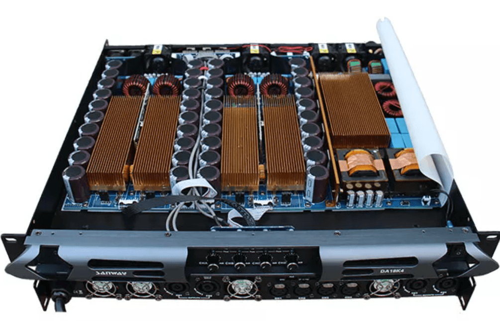

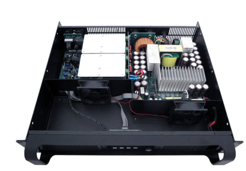

The gisen looks more like the internals of a XLS2500 but doubled for 4 channelsI don't have a specific box design but the B&C 18TBX100 is great value and Gisen K21x4 is also good value. As for designing a port you should read this paper: https://www.diyaudio.com/community/...potential-own-vibrations.391145/#post-7147379
Look how the Sanway look inside (they shadowed the Po..So... design )
kind of what Behringer did with QSC with the RMX series long time a go
this is the internals of the 1U rack mount 4 ch amp from Sanway

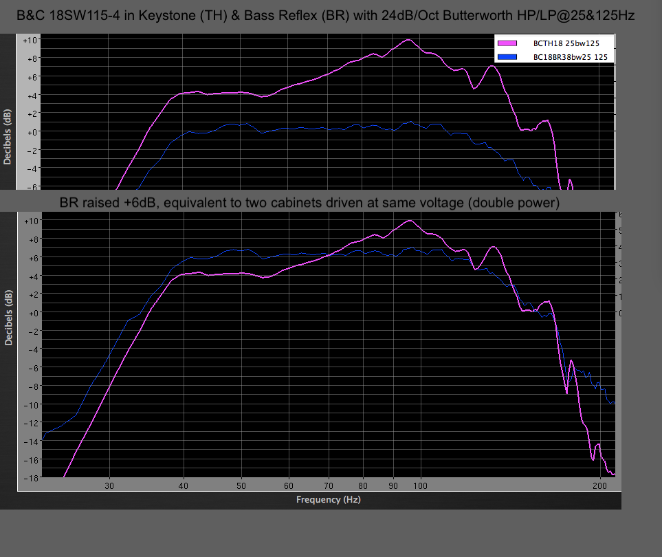

KaffiMann,Just a quick recap of the dirt-cheap double Thomann driver vs the Keystone using a quite expensive single 18":
To be fair, the difference varies between nil to just under 6dB, I bet that 80-100Hz boost is the main reason you feel it has "significantly more output", I'll play nice and pretend like thermal and power compression does not exist for a small moment, and if we just roughly average out the difference it's around 3db.
How much power did you use again? 1700W? And the other one is using max 800W?
So the difference in power is roughly about 3dB, and the difference in SPL is roughly about 3dB.
You cannot possibly claim that the Keystone 18" has a 6dB advantage against similarly sized double 18" BR boxes.
It. Just. Does. Not. Add. up.
Now... If we do add problems like thermal and power compression I am willing to bet hard earned cash that the difference between the Keystone running@1700W/driver vs the cheap double Thomann 18" BR would be negligible at best, except the indisputable fact that the cheap design needs smaller amplifiers as well.
I completely agree that an amplifier that can deliver 100 volts without current limiting at 2 ohms will cost more than one that delivers 50volts at 4 ohms, and that drivers with twice the performance capability will probably cost at least twice as much.
My claim has not been that a single 18” Keystone would be louder than a double driver BR using B&C18SW115-4, just that it requires the same voltage and a single driver to achieve approximately the same level as the 2x18” BR of the same volume. This is an actual outdoor measurement of the raw response of the Keystone and a single 18" BR:
The BR is quite flat- pretty much optimized, a bit more bottom, a bit less top.

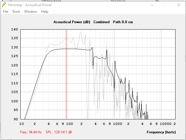

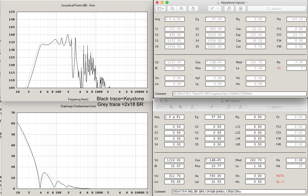

Here is what Hornresp shows using a 340 Liter dual 18" BR compared to the 340 Liter Keystone:
As you have shown in post #18, the B&C 18SW115 has nearly double the excursion (and displacement) of the Thomann 18-500/8A, by whatever mechanical derivation of Xmax you choose.
B&C also includes “Xvar” in their specifications, the excursion when the magnetic field seen by the voice coil, or the total suspension compliance, or both, drops to less than 50% of their small signal value, producing high distortion levels, strong variations from small signal behavior and power compression.
I have usually used 15mm for simulations with the B&C 18SW115, between the Xmax of 14 and the Xvar of 16, as it performs with low distortion to 15mm.
Your simulation is not showing the output potential of the Keystone using the 97volts required for 15mm excursion, you can see in the above it has >134dB potential 40Hz and up, compared to 128dB for the Thomann 18-500/8A.
A six dB increase is equivalent to achieving the same level at twice the distance, or using half the boxes to achieve the same level.

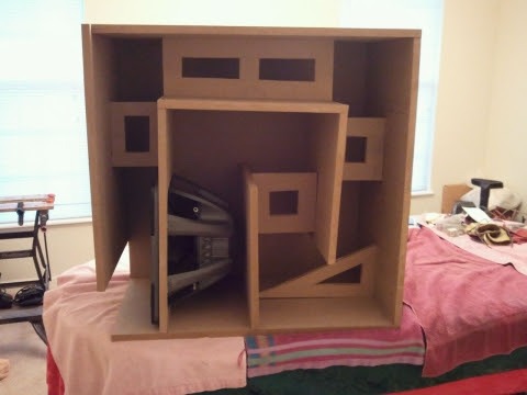

My home theater sub is a Tapped-Tapered Quarter Wave Tube/Pipe. I chose small and low... Hofmann's Law...loud, low, small...pick 2. Even though I chose the least efficient TH, I was still able to crack multiple walls with less than 200 watts of old AVR power.
The enclosure was built in 2012 and finally painted this past summer.
