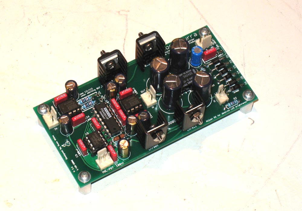

Kooky
I'm spreading myself thin into lots of projects these days. Here is what I just soldered together tonight. Took an hour to do it and I must say that the Pear Brothers make a fantastic kit! I still can't get over the attention to detail in the packaging method.
I'm off to see a cabinet maker tomorrow about putting some wood into the metal enclosure I purchased.
I have a funny feeling I'm really going to enjoy this kooky little thing. I'll be back when it is together with some more comments. I have all the parts to assemble it so I hope it won't be too long.

Re: Bright Blue Cap
Brian does all the hard work, and yes he rocks.
As for that cap, it will be just fine. That particular cap acts as a reservoir for the relay. Just about anything would work.
I hope you really enjoy it!
Cheers!
Russ
