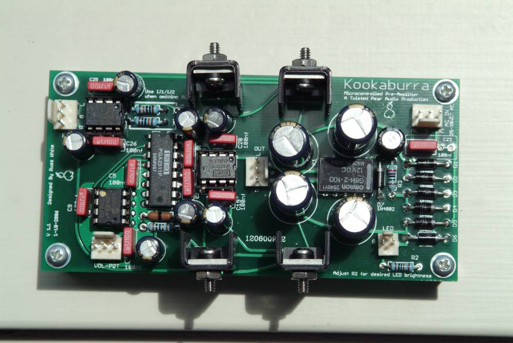

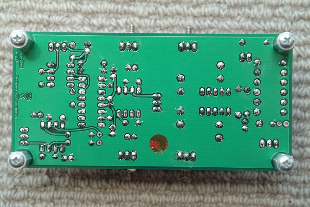

OK, I have noticed one thing, One of my caps (round one next to C20) is the otjher way round to the example on the twistedpear website, mine is soldered as per the PCB detail, has ths been changed in the design at all?
I have also included the image below, any thing obviously wrong looking at this?

OK I do not want to trash this thread by going through how to repair a kook after some muppet not installing the components correctly trashed his, but how might i go about fixing my cooked kook....
The diodes are now installed correctly, I measured the output voltage on the voltage regulators and two read 19V +- and one 12V one 5V so i assume two are trashed, these i will replace but what else is likely to have become fit for the bin?
Am i better getting another kit at this point and learning to read?

I well I think the worst case would probably be that you would need to replace all the other ICs. That would be the PGA, two opamps, and the PIC. You would also want to test each of the caps to make sure that they have not become a short.
Sorry for your bad luck, I have made many similar mistakes myself.
