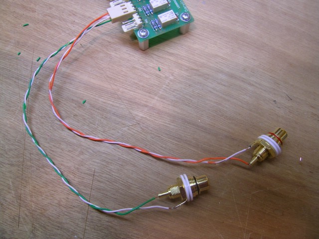

I succeded at building a Kookaburra pre+ Darwin source selector+Ampslab active crossover for my active system.
(It is too "dirty" to be shown, though)
It ended as a very versatile unit that can work as active CX + preamp or as preamp only, thanks to the dual output.
I choose point to point soldering instead of the little connectors.
I was adviced to use only one ground "bar" for all the connectors (input and output) and that bar connected to the active units at one point, to avoid ground loops. I can say noise level is very low with my highly efficient speakers (>100db)
Regards.

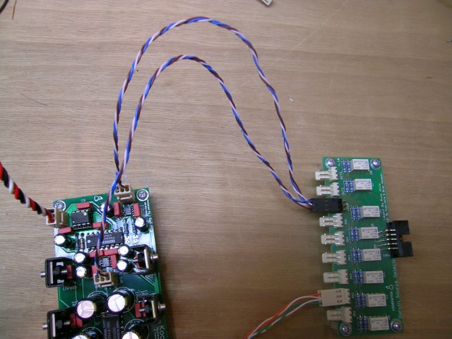

This what I'm trying to do. Put an active crossover in with the pre and have switch wired in so I can switch the crossover in and out.
Great! What crossover?
If I recall well:
signal->darwin inputs 1, 2 ,3...->darwin's loop output->kookaburra input-->kook output->Darwin's loop input-> darwin outs: 1 for crossover's signal input and 2 for direct preamp out, choosing with darwin's own output selector.
Just follow the signal.
If anyone knows a simpler way to do it, I'm all ears...I mean eyes.
Good luck.
M

Almost finished my new preamp based on the Kookaburra and Darwin
Layout:
I still need to get the aluminium finished as its just raw at the moment, but here it is when powered up:

Congratulations, maxw
Very good looking!
I wish I had access to better machines to get that kind of exactness to the cuts...
Tips that worked for me, soundwise:
* direct solder wire to PCB and avoid these tinny connectors.
* make one "ground bar" to connect all ins/outs connectors and then from there, only one connection to PCB ground. That avoided hum on my crossover+preamp (>100dB efficient speakers )
