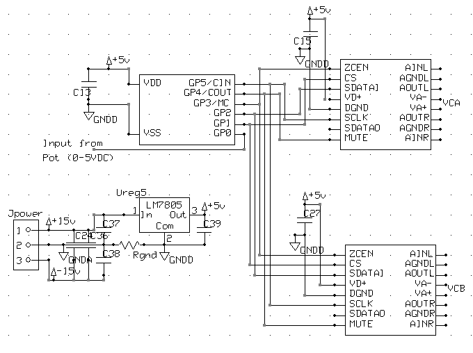

Here is my schematic. I left off the audio stuff cuz it's really just some opamps that I'm using for buffers. I really hope you can help. I'm getting a very VERY distorted output (seen on scope.)

If you don't mind asking, how did you implement the sleep/wake up with PIC? I can't think of an easy way to wake up on pot turn.

The PIC now sleeps until the pot is moved at which time it wakes up, sends the serial data to the PGA2311 and goes back to sleep.
Referring to this comment early from this thread:
Keep in mind, I was a complete beginner with PIC programming at the beginning of the thread. 🙂
I think I was simply mistaken when I posted that, as I can tell you with certainty it is not possible without modifying the circuit significantly or using a different PIC controller. What I probably meant was that no serial communication to the PGA was happening unless the pot position changed, which is true.
You would use a comparator and a change notification pin, if you had one available for input.
There is also another newby mistake I made regarding the zsen pin in my initial design, but its pretty harmless. 🙂 The astute will see it right away (As some already have). The pin that is supposed to be driving it is an input only pin. Rookie mistake.
Cheers!
Russ
