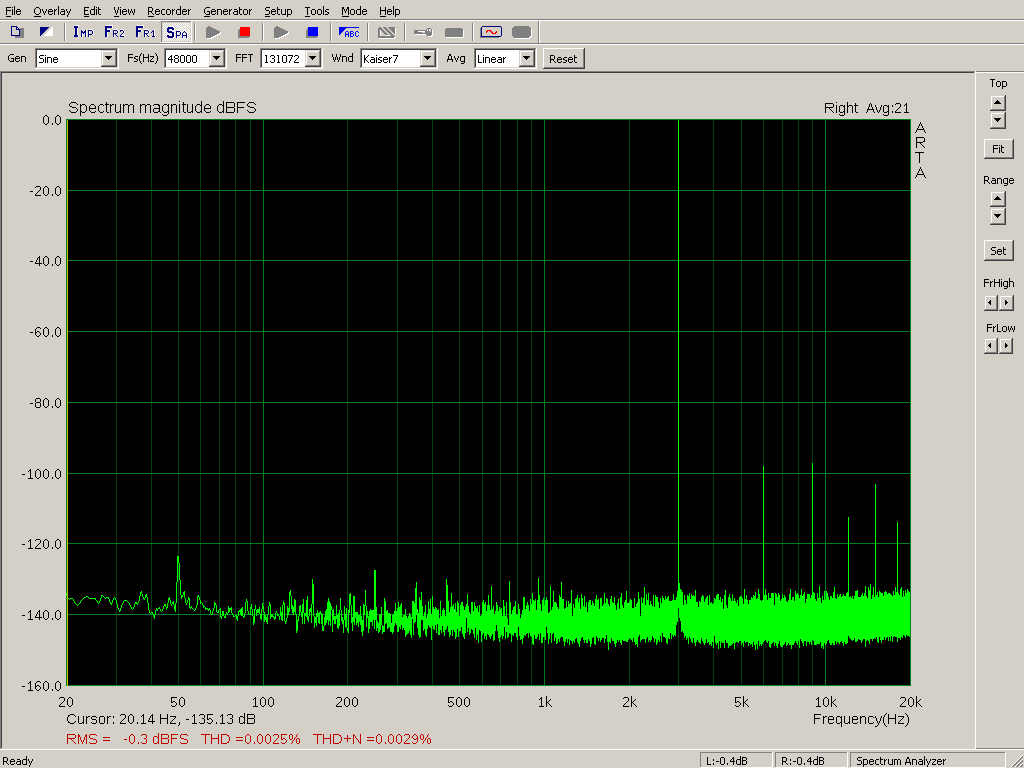

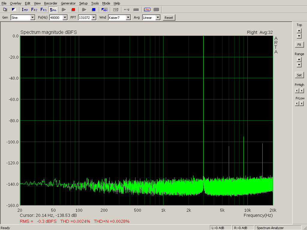

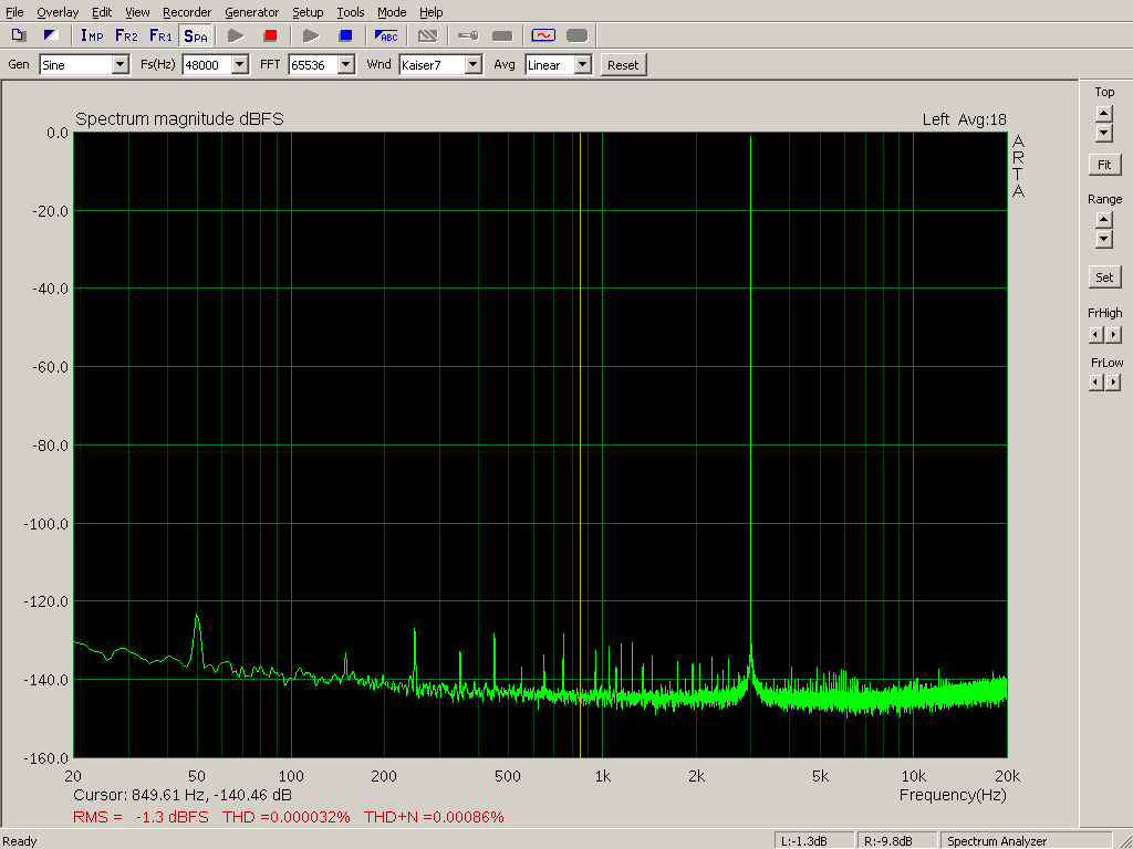

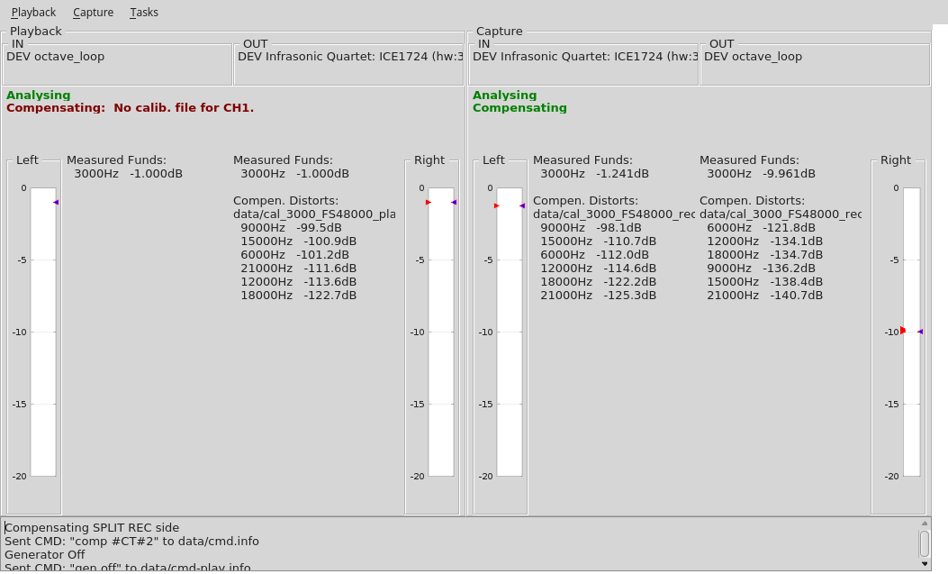

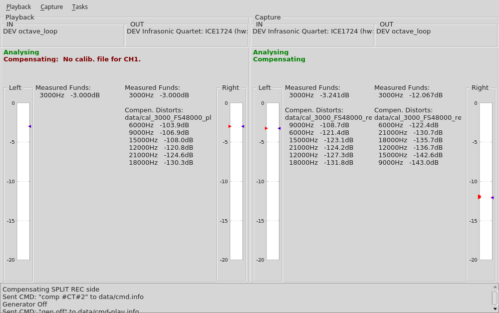

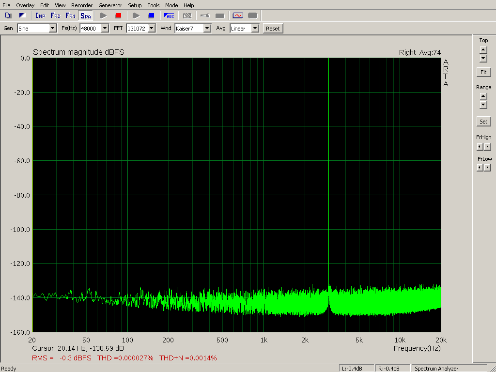

Finally the split-sides calibration is implemented into the workable version of the tool, stilll utilizing a manual calibration adapter with switches and potentiometer. Next step is finally some real measuring - an opamp distortion.
Examples of split-sides compensation at output (DAC) levels of -0.1dBFS and -1dBFS. Listed harmonics on each side (play/capture) show how much distortion the tool is reducing down to the levels shown on the Arta spectrums.
I chose output level close to 0dBFs intentionally so that both sides were forced to distort at max. Still the tool seems to compensate the overall distortion. For -3dB the compensated distortions are much lower - images attached.
What sort of limit would this process have you think?
IMO the limit is HW stability of the soundcard and of course its noise floor.
For instance, suppose you have an opamp that distorts like -150dB, would that come out?

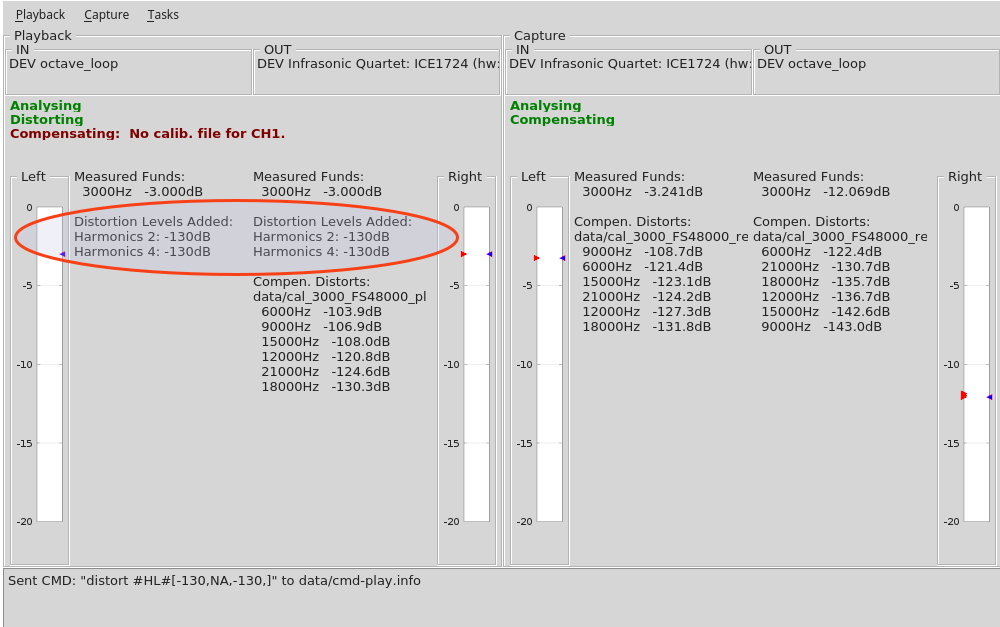

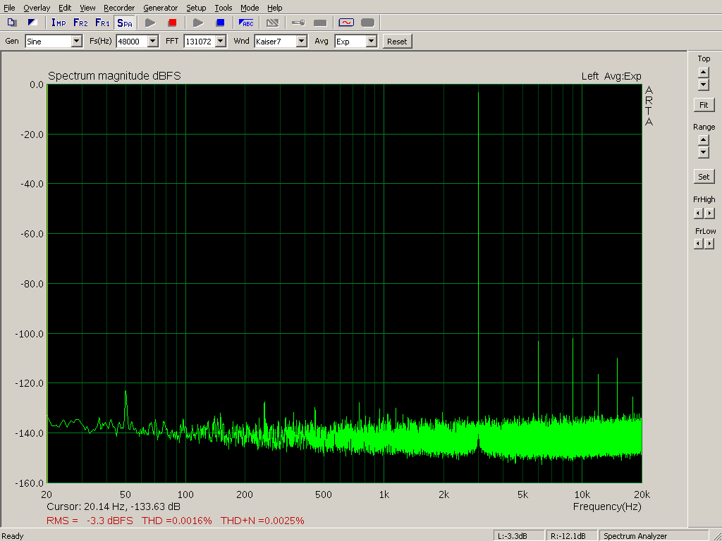

Well, I have not done any real measurements yet. But the distortion must be above the noise floor of the soundcard. The soundcard I use for development is quite noisy, does not go below -140dBFS. A very good device (RX6000) - I can imagine that. Since it is a regular soundcard, it should work with this tool. But for best results it must have output and input clocks linked to single master so that the exactly integer Hz frequencies can be generated, after the AD conversion. Non-integer frequencies will have their FFT smeared since I use FFT with binwidth exactly 1Hz.
This is spectrum with artificially added distortion on DA side -130dB for second (6kHz) a fourth (12kHz) harmonics. The spectrum lines are clearly visible, correct level as measured by Arta cursor.
What makes this even more interesting is that it can work with a nonlinear source. normally these ultra low distortion measurements require a "perfect" sine wave. However being able to extract added nonlinearities with a less than perfect source may tease out issues that are normally invisible.

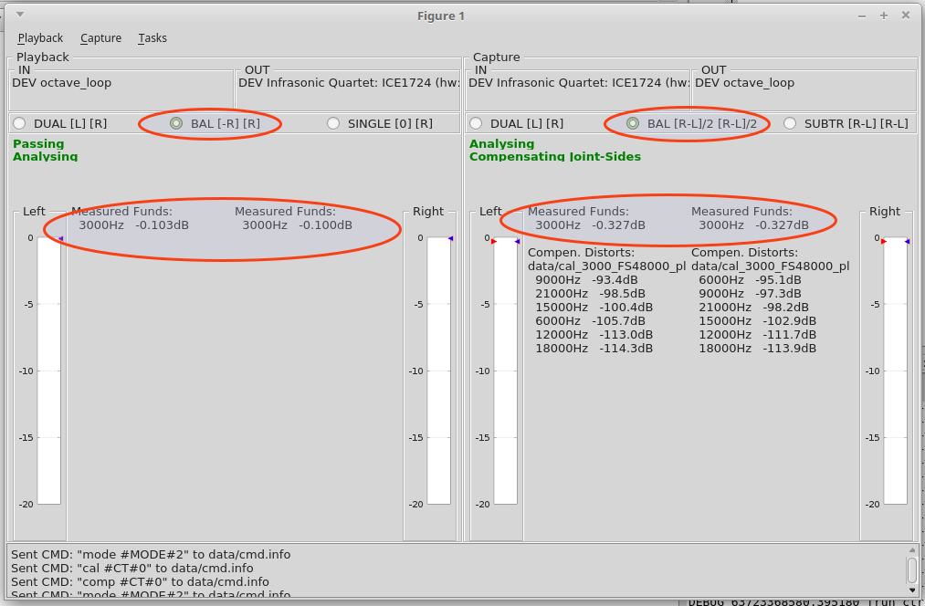

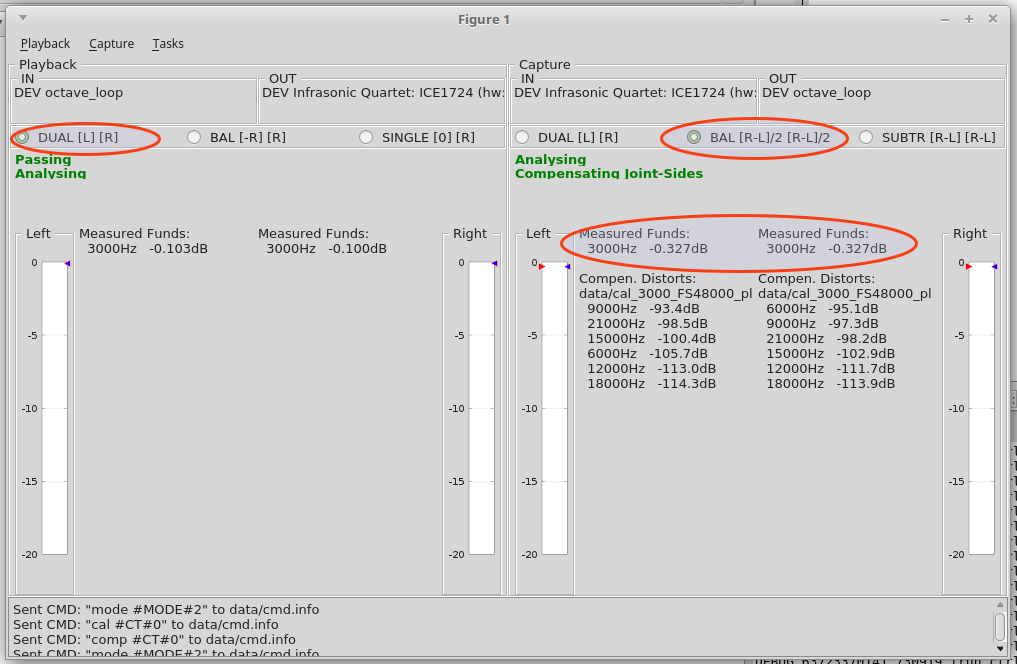

Implemented initial support for output/input configurations
* dual/unbalanced
* balanced
* single channel
Playback/capture configurations are indepentently chosen directly on the main panel.
Balanced mode has calibrated levels for proper balancing (for now manually copied from fundamental levels in calibration files for each channel). On the panel screenshot the different levels on playback side are due to level calibration, capture side measures equal incoming levels.
All compensations are joint-sides performed on capture side.

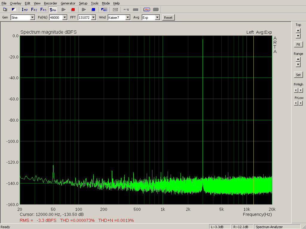

Spectrums of stereo loopback:
A) DUAL -> DUAL (unbalanced), no compensation
B) BAL -> BAL, no compensation
C) BAL -> BAL + compensation
I compared two options:
1) subtracting before the compensation
2) compensating both channels before subtracting
The second option yielded half THD of the first one, therefore chosen for final implementation. On the panel you can see both channels compensating, each with different harmonic levels.

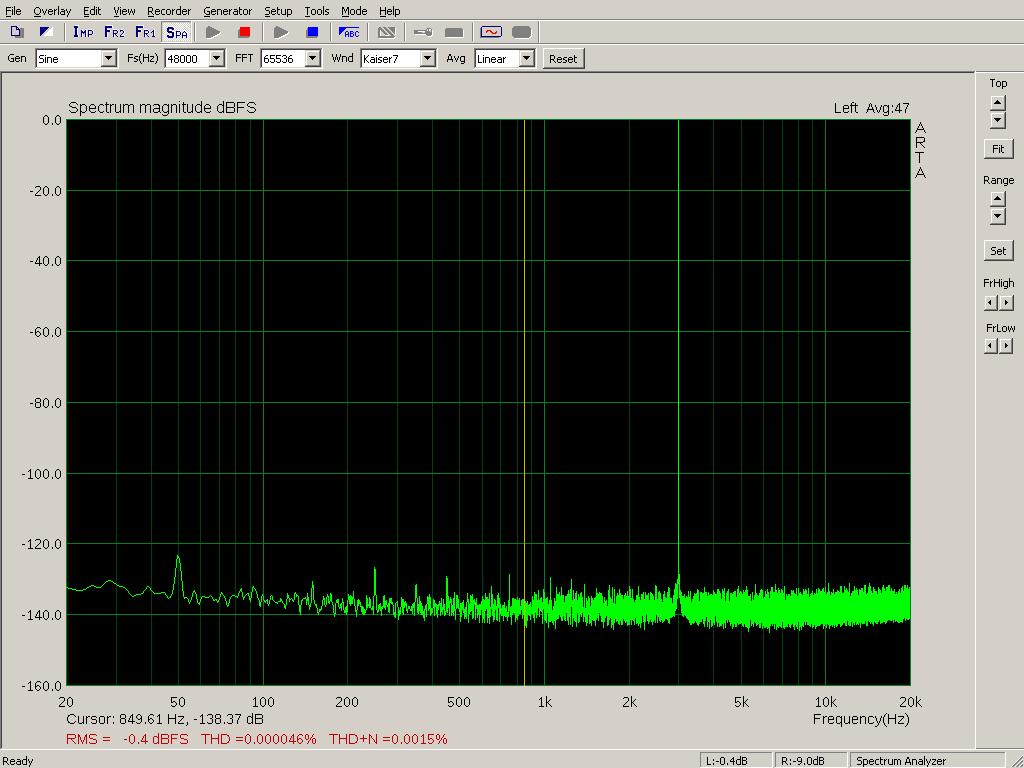

CMRR measurement of the balanced input mode at the same 3kHz/-0.3dB. Just flip the playback mode from BAL to DUAL. Both input channels keep compensating, receiving same signals, without phase inversion. Arta measures RMS of the output -90dB.

Right, joint-sides compensation is nothing complicated. Even though I have not seen it used in any setup yet. But maybe I have just looked at wrong places
For splitting the distortion contributions - https://www.diyaudio.com/forums/equ...ensation-measurement-setup-7.html#post5645750
When you separate output and input and put a 3rd non-linear piece in the middle, with gain, it seems everything must go out the window because you cannot anticipate how the various non-linear black boxes will interact with each other.

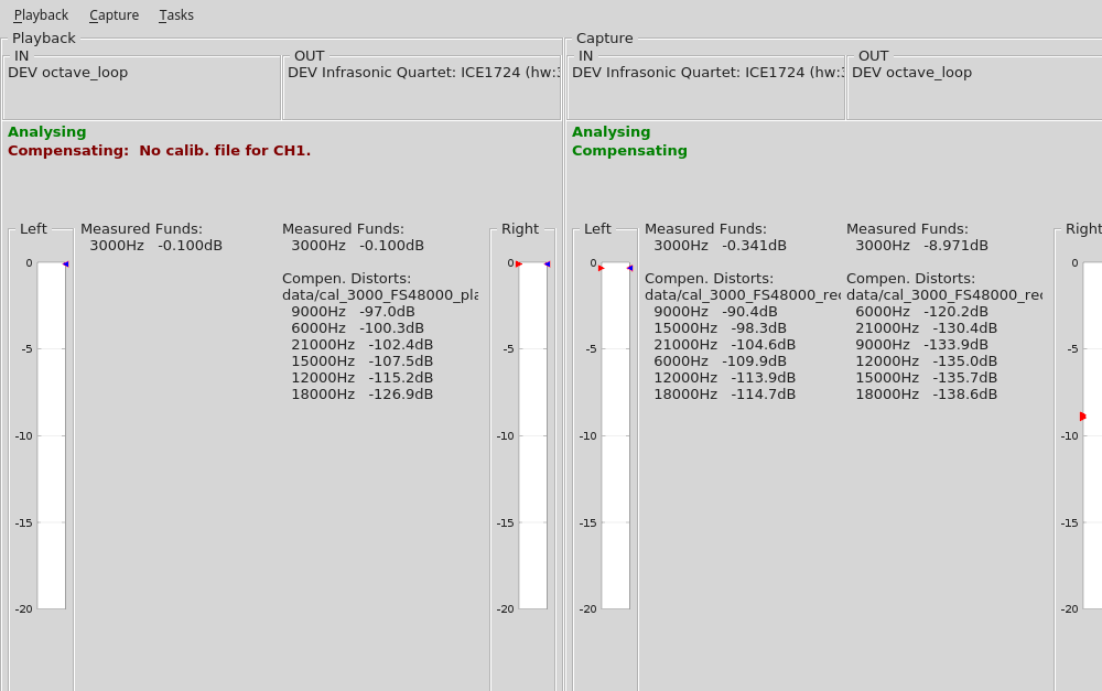

First start the DUT chain without compensation, just passing. This will provide you with input levels for calibration. Calibrate the inputs at these levels with a calibration adapter and start compensation.
Output levels through the DAC are basically fixed, it can be attenuated with minimum distortion with resistor voltage divider at the output, no need to calibrate at various levels during measurement.
Cleaning DAC side is important because the DUT will rotate harmonics (non-flat phase response). Therefore no harmonics from the DAC should enter the DUT. DUT will create its own harmonics - those we want to measure.

I have not tested an external device. But theory says it is not optimal. The FFT uses limited number of bins (1Hz binwidth in my current version) and cannot measure fundamentals/distortions precisely for non-integer frequency.
On decent CPU (fast cores) the whole loop (incl. FFT in the analysis module) can run every 50ms, always providing updated phase measurement. But if you add 2,000Hz correction to 2,000.1Hz distortion, even in 50ms that will create a measurable error. When compensating harmonic from -100dB down to -140dB, every error/suboptimality stands out.
If DAC and ADC run from the same clock, the frequencies on both sides always fit exactly, for unlimited runtime.
Of course when distortion products match there is an add/subtract potential for them. That can create cancellation that is not real.

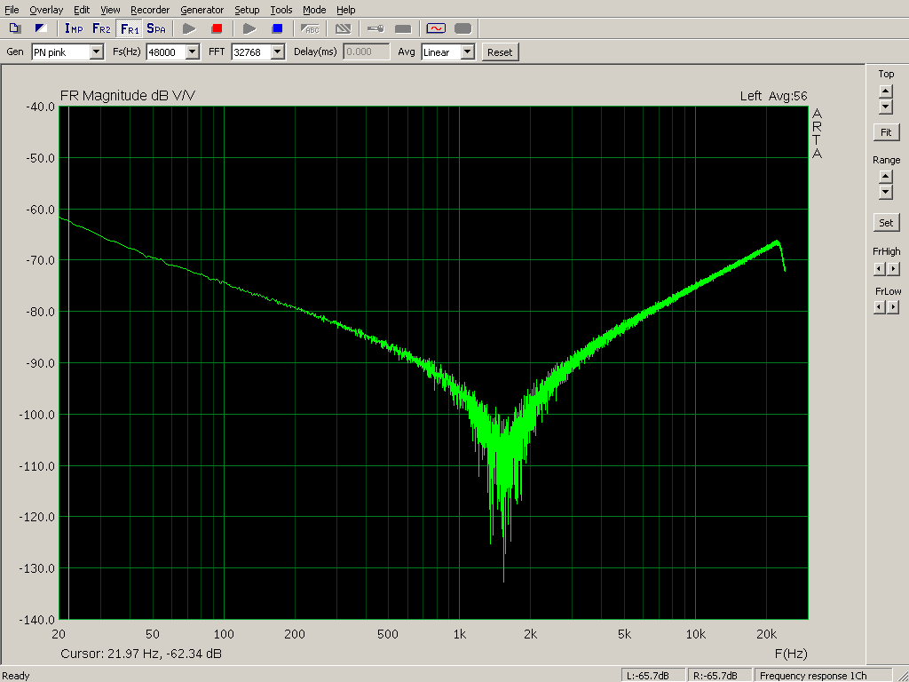

OK, let's suppose the DAC distortion cancels out with the ADC distortion in direct connection. The calibration will not yield any harmonic.
But if you run the same DAC distortion through the LP filter, it will be rotated differently than the fundament (different frequency) and will not cancel out with the ADC side anymore. The ADC distortion is created by the passing fundament and will be rotated differently than the DAC distortion. That is how the LP filter is used in splitting the contributions.
A simple test shows the effect:
Compensate joint-sides (regular phase subtraction) at voltage divider - clean spectrum.
Switch the path from voltage divider to LP filter producing the same fundament level (i.e. ADC will operate at the same distortion profile) and distortions appear - not compensated properly anymore.
Whereas the properly split compensation produces no distortions in the spectrum (up to HW limits) no matter which path is selected. Flipping the switch makes no change. The only conclusion I see is there are no DAC distortions to rotate.
Of course I have no other equipment to measure the DAC output precisely. But I have learnt a regular 24bit soundcard makes for a very sensitive device in this respect.
