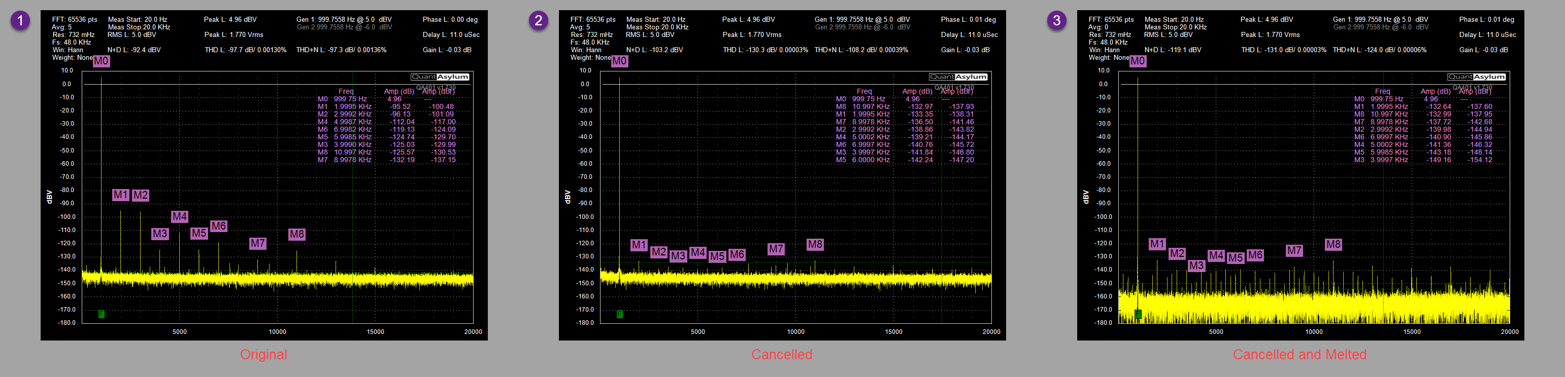

Yesterday afternoon I attempted a simplified first try at building what phofman has built and the results are, to me, staggering.
In this implementation the Dd and Da terms are calculated from the two measurements X (pass through) and Y (through LPF), but all the cancellation is currently put in the DAC. As a result, re-inserting the LPF doesn't hold. But I'll fix that in the coming week.
The LPF is a 3.3K and 33nF NP0. The filter was swept and exported. System was configured for pass through, a single cycle was run. And then that measurement was captured as "phase 1". System was configured as LPF, and then another single cycle was run and that was captured as "phase 2" using the previously exported filter data.
In the attached, you can see 3 plots. Plot 1 is the QA401 at 0.5 dB away from max output limit and thus harmonics are growing. Harmonics are around -100 dB. Plot 2 is with cancellation active. Harmonics are -138 and lower. Plot 3 is with cancellation and melt active. Melt is an experimental mode on the QA401 that was prompted by a discussion with Demian years back after he'd sent a paper on paralleling ADCs. It basically sums N coherent time-domain acquistions, and then performs FFT on the average. This drives noise to zero. If you wait long enough, the THD+N will converge to THD because you have "melted" the noise. Here, it's useful to peel back the noise and see where the harmonics are.
Some interesting observations to bolster what phofman has seen. First, the filter only needed to be swept once. That one capture has been used over and over to reproduce this. Second, the results held over night. IOW, the coeffs determined 12 hours ago still "work". There is a fairly large temperature sensitivity, however. If I hit the DAC or ADC with cold spray, all is lost: the harmonics come back up and don't ever really go back to where they were. The input/output opamps don't seem nearly as sensitive though.
Implementation details:
This is all polar math and ham-fisted at this point. Phase 1 is capturing pass through value of X = Dd+Da. Phase 2 is capturing with LPF inserted Y = LPF*Dd + Da. This is a slight simplification of phofman's solution that will only hold (I think) if there's no gain in DUT.
For each step, the waveform is aligned to give the same alignment as the DAC output buffer. Post DAC, there are a few sources of delay, on the order of 10's of microseconds. The shfiting is done by a well-known FFT property such that you can take a time series, convert to freq domain, add a linear phase to every point, and convert back to time domain. This permits precise sub-sample shifting if needed. With Phase 1, it's shifted to the correct location and then the amplitude and phases of each harmonic are noted. Amplitudes are stored as relative to fundamental. Phases are absolute. In phase 2, the same is done. At this point, Dd and Da for each point can be computed and you get the values needed in both the ADC and DAC required to offset the offenders. From that point on, the DAC and ADC corrections are applied ot the DAC output. As noted above, that needs to be split in order for anything other than passthrough to work.
I cannot emphasize enough how clever I think the measurement through the LPF is to allow these the dac and adc components to be learned. Phofman, that exploit you shared is awesome.
I am glad it works for you. Honestly, I still do not understand why such solution has not been used for many years. Computer-assisted analyzers have been produced for decades. To use LPF was not a random idea, it was the first obvious answer to the question how to change harmonics in a controlled manner against the fundamental so that two independent equations can be obtained and solved.
Yes, measuring the LPF and VD at all required frequencies precisely takes some time. In my latest version the transfer measurements are separated from the much faster splitting calibration.
I have the same experience.
That is why the actual calibration must be fast and easily repeatable at any moment of measurement.

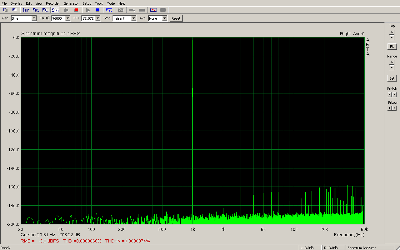

I have finally managed to compile a working playrec on Win10 for ASIO. No WASAPI/the other many windows sound systems yet, There are constant problems with header files of Win10SDK/of mingw coming with windows port of octave/of mingw coming with portaudio.
ASIO itself would be OK, but I could not find any ASIO-based loopback tool. So no go for now anyway. I really hate this dumb inconsistent OS.
Finally managed to compile playrec with ASIO + WASAPI + MME:

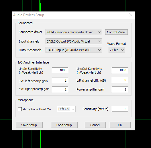

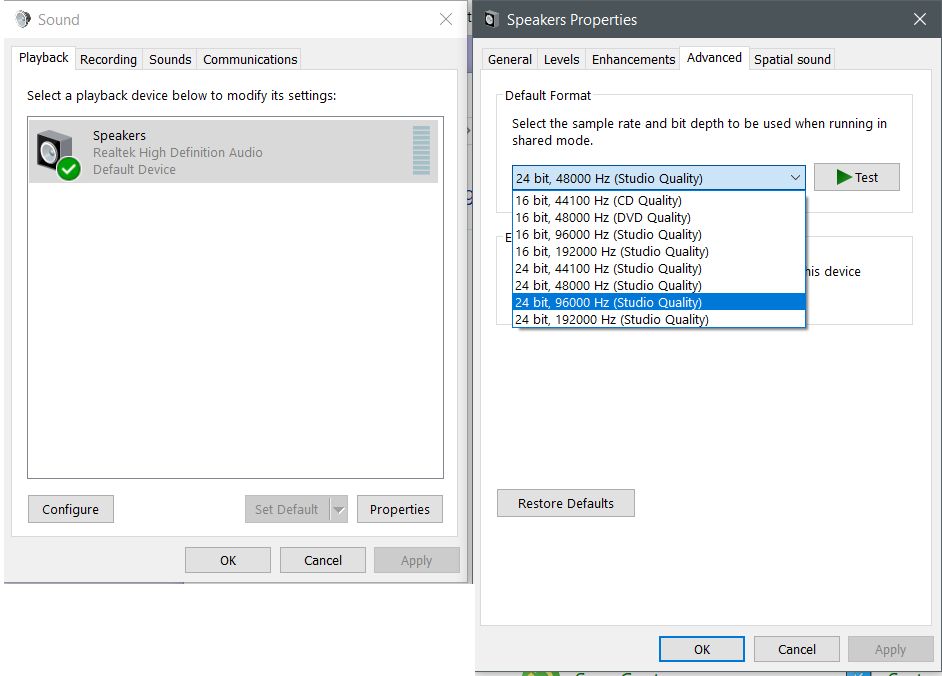

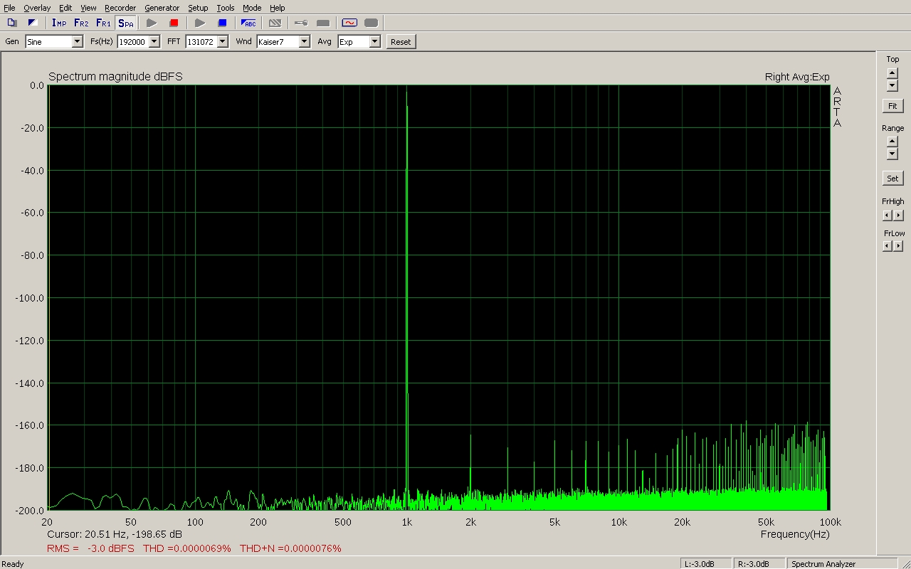

Next step was testing Arta + Virtual Cable VB-Audio Virtual Apps

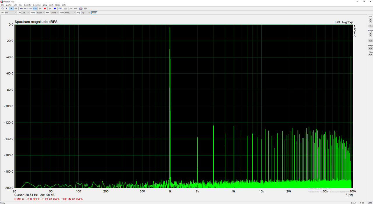

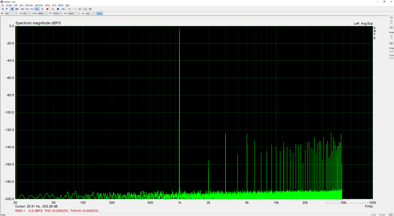

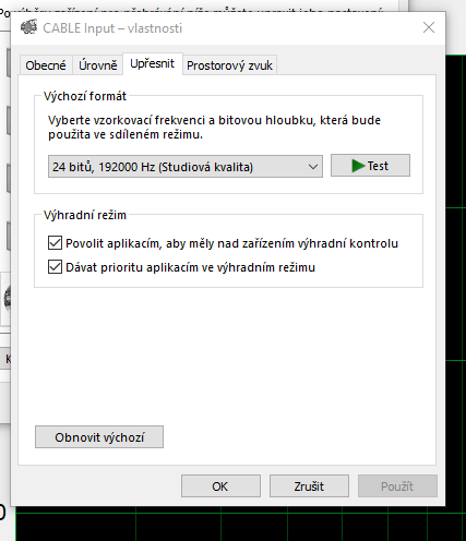

The device is configured to run at 192/24 - see the settings screenshot. Arta is configured the same - see the screenshot
The digital loopback spectrum - see the screenshot. Complete fail, distortion at -120dB, far from bit-perfect.
I tried hooking Asio4All to the virtual cable device and configuring arta to use Asio4All - no change in spectrum. IMO the Virtual Cable is doing something to the signal, no idea what.
At 192kHz the virtual cable fails even more - there is a -40dB peak at 95kHz exactly.
For comparison - the last two screenshots are linux alsa loopback at 96/24 and 192/24 - bit perfect path, as it should be. I am not used to fighting the infrastructure - it is supposed to work 100% correctly.
Should someone try the virtual cable loopback in arta and share the results, I would be very grateful. Perhaps my windows arta is the culprit, I do not know.
Another option for the loopback would be compiling the open source virtual audio wire GitHub - HSpear/virtual-audio-wire: The Virtual Audio Wire (VAW) is an open source Virtual Audio Device (VAD) project its function is to provide Virtual Audio Devices for multimedia applications. . Unfortunately that is outside of my options since I do not own/have never used the required MS Visual Studio (playrec is compiled directly in octave by the included mingw compiler).

The default behavior of Windows sound engine is to resample any audio it wants to without warning. For each sound device, in Windows control panel there is a default bit-depth and sample rate. If they exactly match your audio then it shouldn't be resampled. Please see attached jpg.
The only way to let an application control the bit-depth and sample rate is to use an ASIO driver AND make sure that the sound device you want to use does not show a green circle with a check mark in it next to the sound device name in Windows control panel. A check mark would indicate it is a default device for some purpose. Best to make some unused sound device the default sound device for every purpose (right click for menu), and then only use an ASIO driver for some other device which is the device you want to use.
