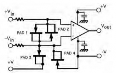

overvoltage protection with low-leakage clamp diodes to +/-3V
This is a minor point, but low capacitance is more important than low leakage (in practice they go hand in hand). The capacitance presented by the steering diode will be very sensitive to voltage and for low-distortion you need to remove as much voltage-dependent capacitance everywhere you can (use C0G caps, thin film resistors, etc). A BAV199 is around 2 pF. USB3 TVS protection diodes get even better (0.5 pF), but you don't get the range of voltages to pick from. The 2 pF is a reasonable place to be.
Also, a lot of modern opamps have built-in ESD steering diodes from the inputs to the rails, and if you just parallel those with an external over-voltage steering diode, you run the risk of the opamp IV transfer function being lower than your external IV function (eg opamp diode Vf is 0.30V and external Vf is 0.35), and the first over voltage event results in the opamp taking far more than you expected--they can only take 10 mA absolute max. So, rather than dump to a rail, dump to a TVS set several volts below the rail. That way, the opamp will never see any input excursion beyond the rail.

I have used BAV199 in my previous project Balanced Amp Outputs Measurement Adapter and it is my candidate. Also, I do not want to dump the diodes to rails, that would be too large a signal for the soundcard input. My original plan was +/-3V using simple zener diodes from the rails. Serial resistors before the clamping diodes should limit the dumping current sufficiently even for high overvoltage.

This is exactly the way I did it in the autoranger. For low noise, while still having enough current limiting, I used a series R of 3.9k.
But I found that it is hard to completely remove the effect of the diodes from the distortion generation. Your BAV's may be better, I used FDH300's for their extremely low leakage.

Thanks for the confirmation. Actually I spent quite some time looking for a diode with minimum leakage and BAV199 turned out a reasonable compromise.
Another option is JFET as a diode - typically much better leakage than a diode but rather low max. voltage (40V).

The recommended JFET MMBF4117 https://www.tme.eu/cz/Document/e64ad415c5ade62bf707a72c1988bad6/MMBF4117.pdf has max reverse voltage 40V, max. Igf 50mA (serial 1k should be OK), leakage current for 3V about 200fA.

Jan, thanks for the offer. But MMBF4117 costs 7 eurocents from my supplier MMBF4117 ON SEMICONDUCTOR (FAIRCHILD) - Transistor: N-JFET | TME - Electronic components.
I think I already have them too, from the previous project. In the end I decided for BAV199 which has twice the max voltage. For the amp speaker output measurement adapter I preferred the BAV199s higher voltage to the presumable lower distortion of the JFETs. For this adapter I may try the JFETs. Definitely on the opamp output side towards soundcard input where the possible overvoltage is only +/- rails.

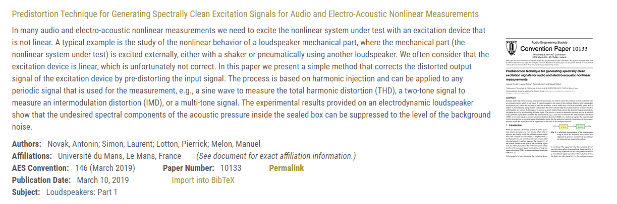

Jan, thanks for the link. Actually, I do not follow the AES library. March 2019 is a bit newer than this thread Actually I do not have any subscription - would please anyone have a copy?
Honestly, removing the distortion by applying the reversed-phase harmonics is common sense IMO, I do not find it much novel. You measure the harmonics and add the opposite phase. Works great though, components are surprisingly stable with this respect and the calibration holds quite well for hours/days.
But splitting the distortion parts for DAC/ADC sides, thus cleaning the DAC and ADC sections separately, is IMO the key for successful single/dual tone measurement. DUT always changes phases of harmonics (LP/HP filter) and if the measuring signal is not harmonics-free (ish), the joint-side compensation on the AD side will not clean the rotated harmonics properly.
It is true some side may contribute more to the overall distortion. In my case the DAC by a factor of 10, in my initial tests. Simply compensating with the joint-calibration on DAC side would clean the DAC output considerably. But that is not a general rule, a different setup can have the ADC part distorting more. Until determined by measuring with a precise device (unavailable to most people here) or splitting with calculation (available to anyone, hopefully), one cannot tell.
Also, the actual implementation counts. IMO the layer between the soundcard and any abitrary measurement software is the way to handle this.

The principle of the researchers is basically the same. In each frame (what I call a cycle) they do (in my terms) calibration (measure complex amplitude of distortions) and compensation (subtract the distortions from the incoming signal). Since the compensation is applied to the same signal immediately in the same frame, they do not have to care about fundamental phases, interpolation of levels etc - FFT results apply directly to this frame data. After a few cycles they get a very clean harmonic pneumatic (air pressure) signal used for measuring speaker characteristics. Actually a very clever use of negative feedback.
It is analogy to cleaning the DAC signal with an auxiliary constantly-running ADC with zero distortion (distortion of their measuring microphone is considered zero). Unfortunately we do not have zero-distortion ADCs (or at least of negligible distortion compared to the DACs)...
