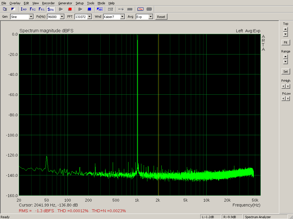

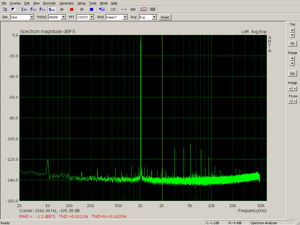

FFT samplerate samples long, i.e. precision 1Hz. Works reliably.
Just an example of joint-device compensation (on recording side, contributions not split to DAC/ADC) of 1021Hz/96kHz at full level -1dB. The cursor is placed at second harmonic 2042Hz to show the measured level.
The soundcard noise < 2kHz is very likely caused by a fan near the card in the PC case. For final application a soundcard must be located outside the PC case, preferably hooked to a notebook e.g. via expresscard -> PCI-e adapter ( V8 EXP GDC Laptop External Independent Video Card Dock Mini PCI-E for Beast | eBay on the way for testing) running on batteries to avoid any ground loops.
Newly implemented:
* continuous tracking of incoming signal with FFT (1 second of continuously update samples, 1Hz resolution, the FFTW library used by octave is very fast)
* ignoring short-time glitches of FFT results when the incoming signal changes frequency/arta changes FFT length etc.
* automated selection of calibration profiles -> compensation or passing unchanged samples if no supported input signal fundamentals are detected or corresponding calibration profile unavailable .
* compensation decision is handled for each channel separately/individually. This change will support the planned virtual balanced mode where one channel may hold the main signal (compensating the fundamentals), while the other channel may hold only the common-mode noise to be subtracted from the first channel (no fundamentals, only passing samples to the subtraction=balancing stage)
* calibration profiles are stored for each channel separately.

Interpolation for calibrated levels is basically finished. It seems to behave OK, 1 dB calibration step will be probably enough (of course depending on the soundcard).
Distortion peaks are averaged across several 200ms cycles to avoid storing externalities.
The feature took quite a lot of changes, storing multiple levels into calfiles, optimizing the interpolation code to minimize CPU load, handling missing values for some level/distortion frequency combinations, handling extrapolation for levels outside the calibrated range.
The splitting code is not modified to handle the new format of calibration files yet, I will fix it after the format becomes stable.
Measuring peaks with 1Hz FFT bin + compensating 40 distortion freqs of dual-tone 4 + 4.5kHz/48kHz takes under 70ms in every 200ms cycle on my older 2.4GHz Xeon core - quite safe margin for avoiding buffer underruns.
I guess time to start working on the GUI - probably some chart depicting calibrated levels vs. current level will be the first. This requires implementing duplex communication between octave processes - not decided about technology yet, probably plain files for start.
Should anyone be interested in testing the joint-device mode in linux + wine + Arta, it would help towards checking real usability/repeatability of the project. I would write the installation/operation readme in case of interest.
