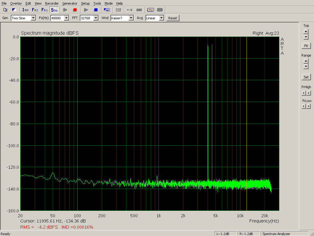

I just added support of the virtual loopback which allows to show some real-time screenshots taken directly from Arta.
Now the next step is trying to split the overall loop compensation between DAC and ADC sides. I want to try to calculate the contribution of each side to the overall distortion harmonics on every frequency using a low-pass filter with precisely known (measured) transfer function. Distortion components generated by DAC are attenuated and rotated by the LP transfer at their respective frequency, while ADC components do not go through the LP filter, they originate instead from the fundamental frequency as it goes through the AD stage - hence attenuated/rotated by LP transfer at the frequency of the fundament. Hopefully the measured harmonic values will allow to determine the amplitude and phase of both components by least-squares estimation of function parameters which has proven very powerful in octave.
Github repo Commits * miero/nonlinear-compensation * GitHub (outdated readme, a few commits behind my master).

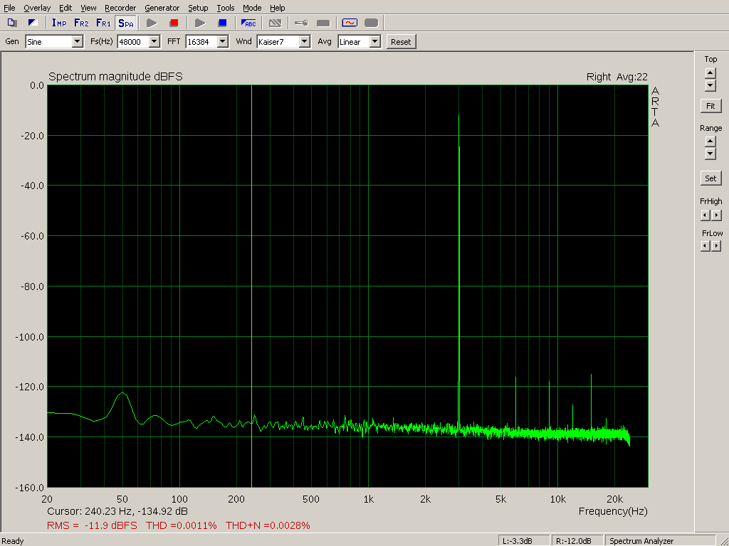

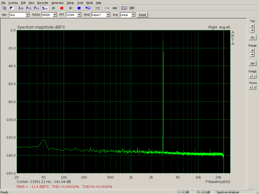

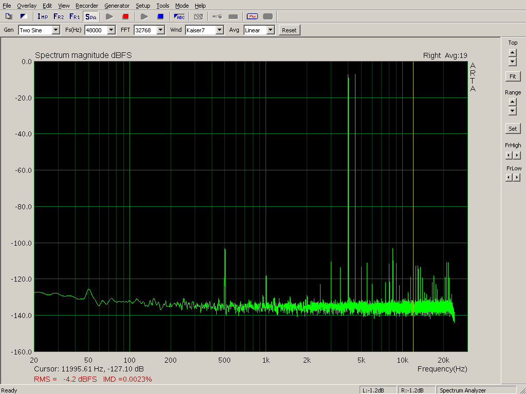

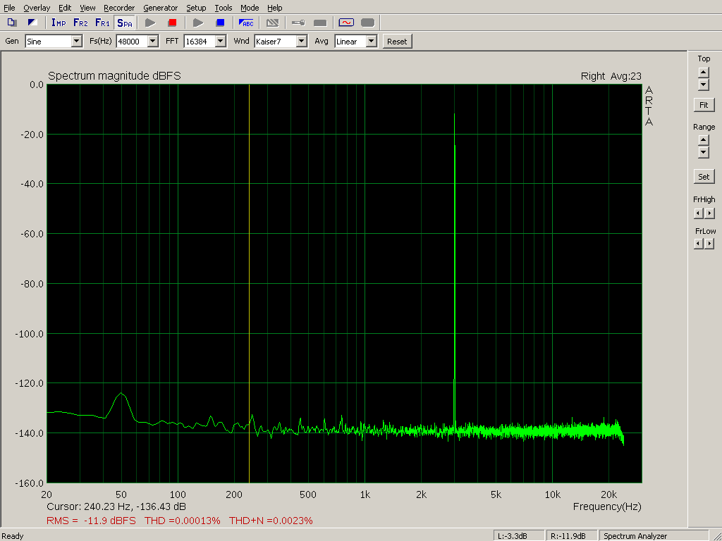

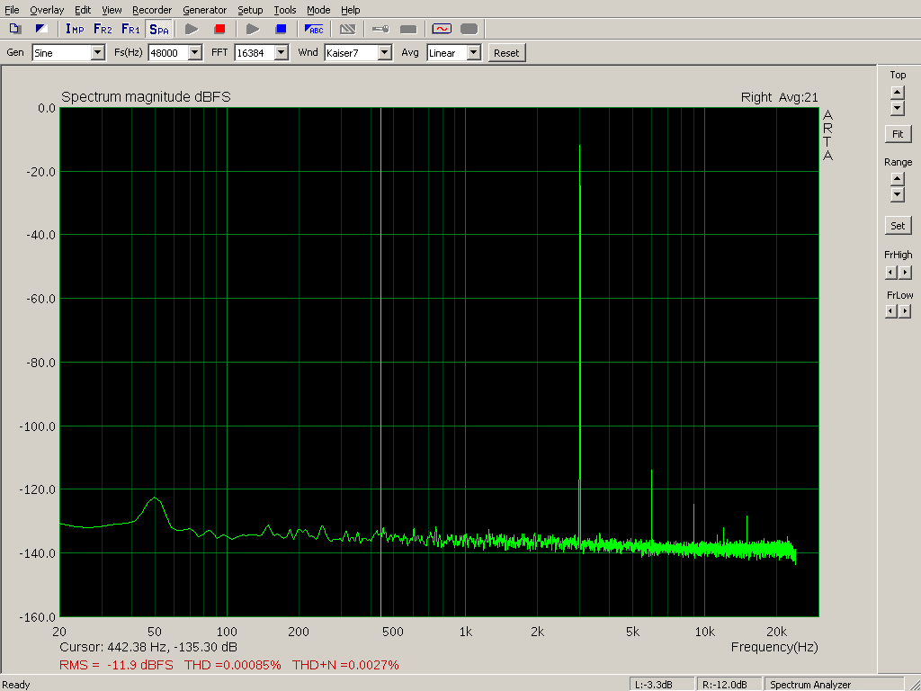

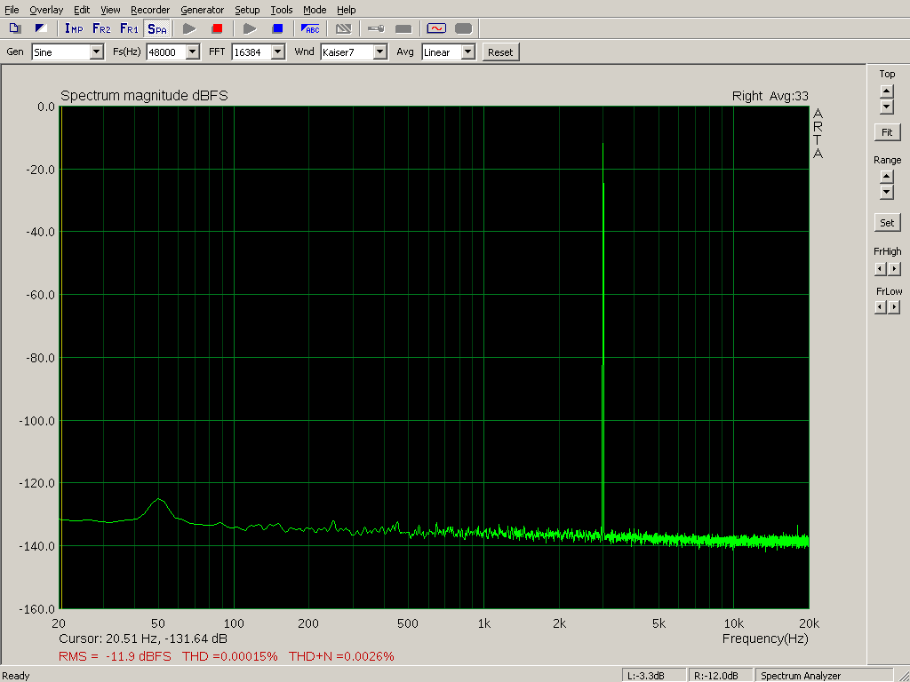

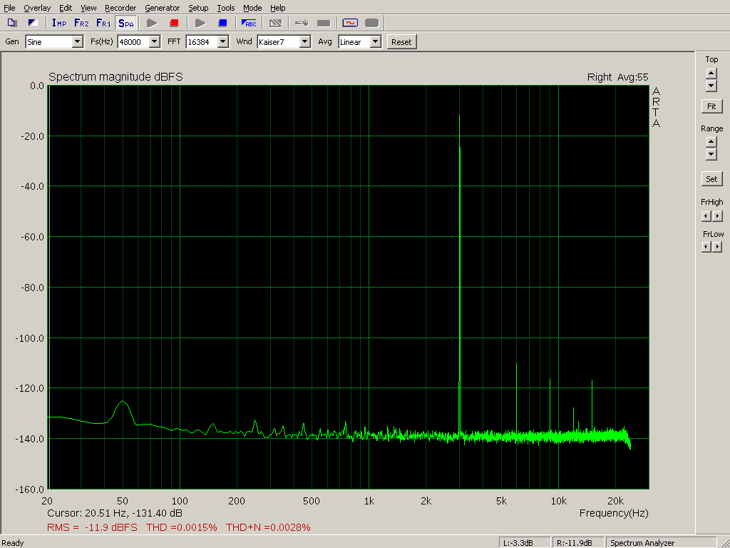

Attached screenshots - single and dual tones in mode PASS and COMPENSATE for Infrasonic Quartet, an older but still decent PCI soundcard similar to ESI Juli.

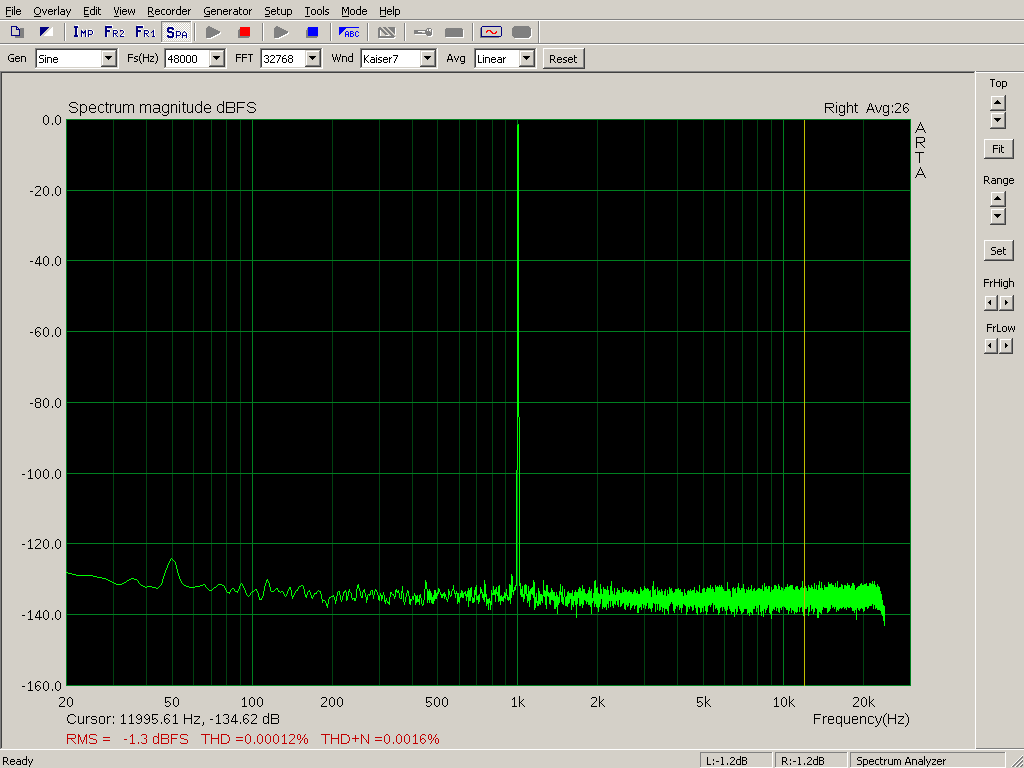

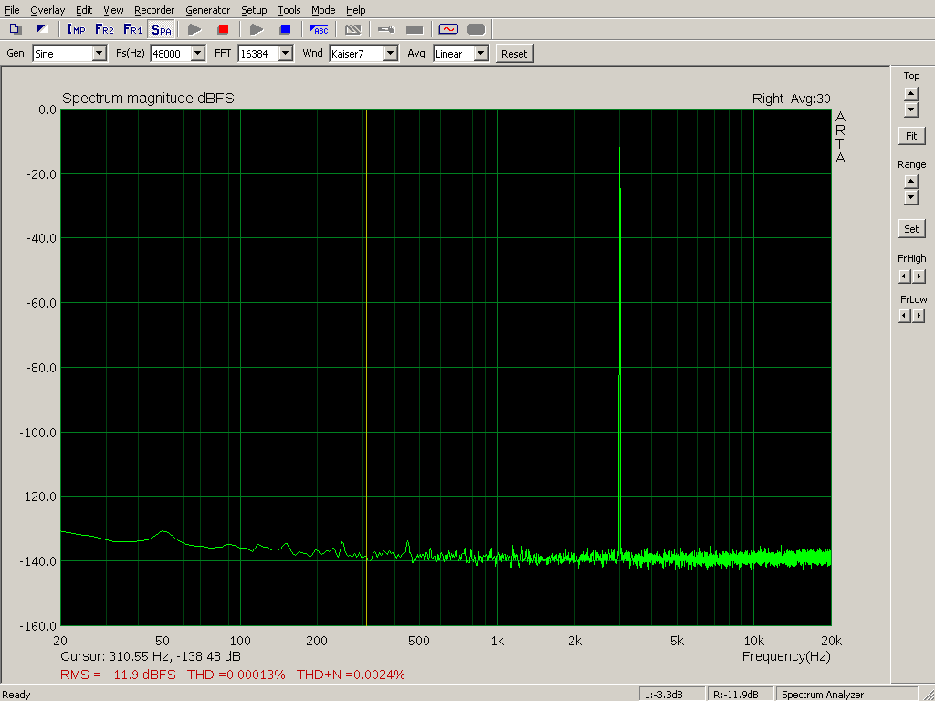

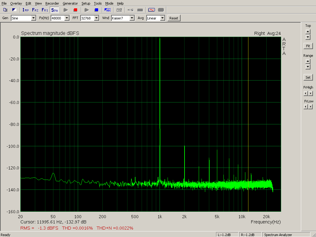

How about this...
Screenshots:
No compensation:
1. PASSING (no compensation) direct loopback through voltage divider
2. PASSING through LP filter (RC) tuned at approx 1kHz - no compensation. Nice to see how the filter attenuates the distortion harmonics
Single-side joined compensation:
3. JOINED-COMPENSATING direct loopback, compensation of the whole loop on ADC side, cleaned
4. JOINED-COMPENSATING through LP filter. The filter changes DAC distortions which corrupts the compensation.
Split compensation of both sides:
5. SPLIT-COMPENSATING through direct loopback. The measured distortions of direct and LP filter loops are split by parameter fitting of two equations between DAC and ADC sides.
6. SPLIT-COMPENSATING through LP filter. Apparently (almost) no DAC distortions to be affected by the filter to corrupt the compensation on ADC side.
The two split-compensation screenshots are only one switch flip apart - switching from voltage divider to RC filter on the soundcard input while the compensation is running, no change to configuration/restarting the chain etc. There are still minor distortion artefacts on the LP filter spectrum (meaning the DAC signal is not 100% distortion-free) but I hope these can be eliminated by more careful handling gains in the calculation.
I dare to say it works 🙂

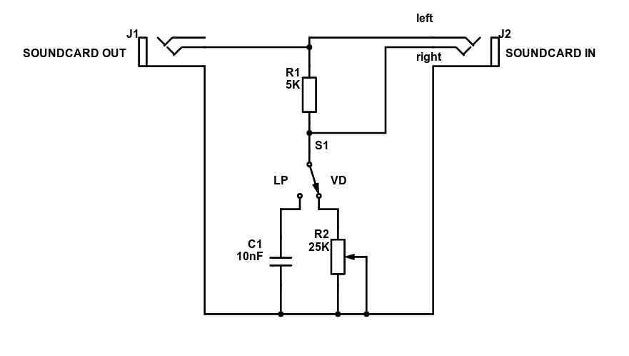

How about the output of the DAC and the input of the ADC, does distortion depend on load or source impedance?
For now I only use my testing tool which has fixed impedances.
