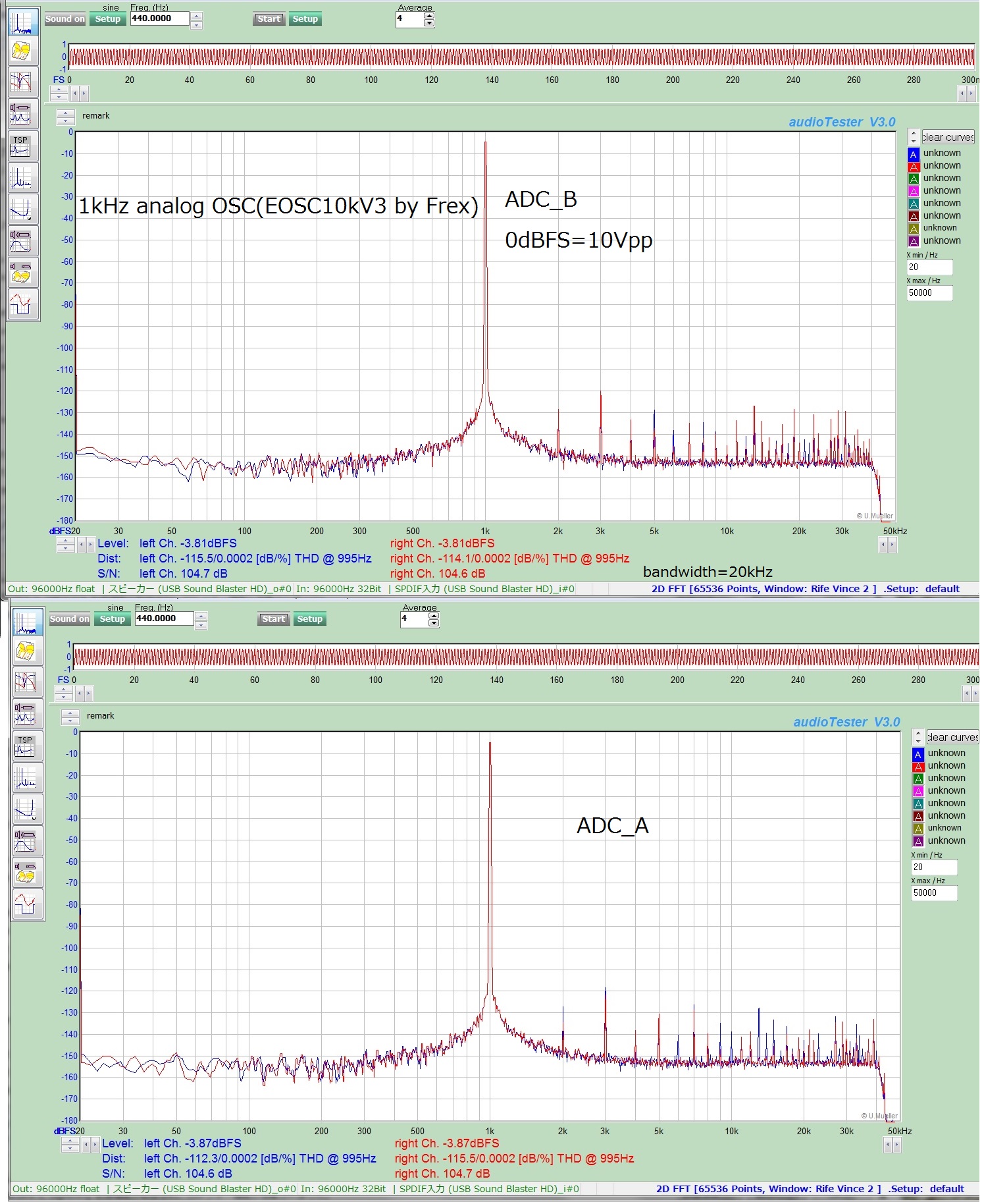

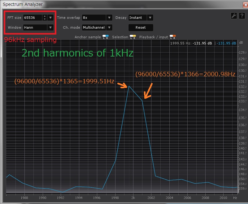

You should use a larger FFT window if you want to see the distortion buried by the noise.
Or use DiAna:
DiAna, a software Distortion Analyzer
You can vary the record settings to check if the harmonics detected are steady harmonics or if they are unpredictable. Chaotic unpredictable harmonics would be the end result of a good distortion correction.
Excellent results!

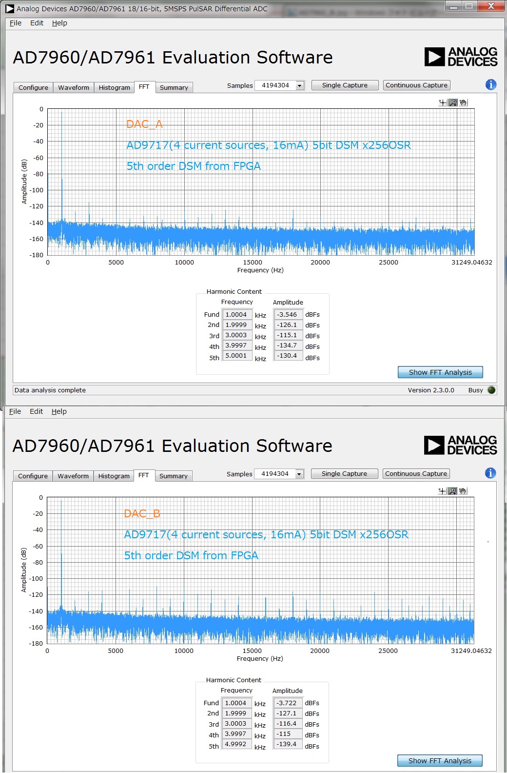

Thank you for your cooperation. My current DAC can calibrate relative accuracy up to almost 120dB THD. However, if the same coefficients are loaded next day, It can't have the same values after adequate warming up time. I don't know it comes from DAC or ADC. I would say it's almost impossible for a DIYer to guarantee 120dB THD though I sometimes have better THD than the value just after calibration. I highly appreciate your approach because there are very few real projects which have a successful result. SIM may exist but it's not real.🙂
I've read your project thread. Honestly, I do not understand all the details, not really able to help you with that.

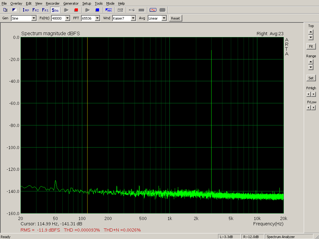

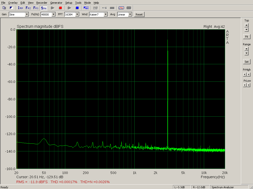

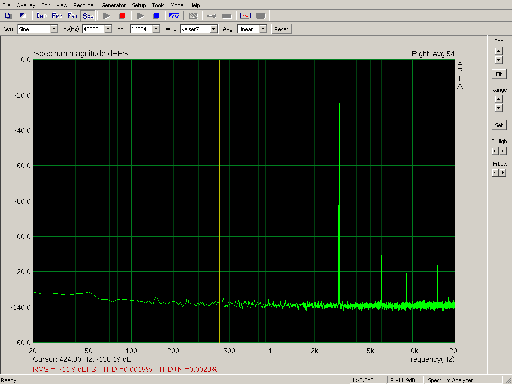

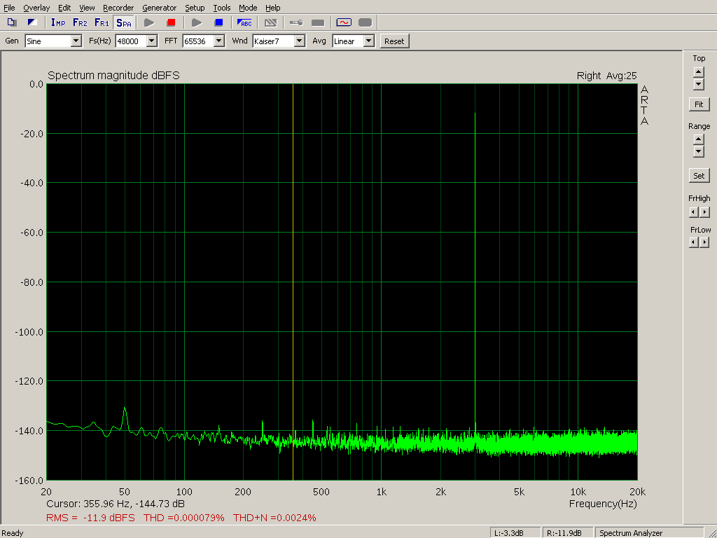

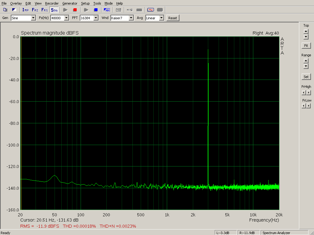

Cold boot, compensation only, calibration profiles from yesterday:
1) voltage divider
2) low-pass filter
3) pass mode - no compensation.
I would say the hardware is rather consistent.
Recalibrated, increased FFT in Arta:
4) voltage divider
5) LP filter
I guess the limit of the technology is reached. Cleaner spectrum will need virtual balanced inputs, on the todo list...
1) voltage divider
2) low-pass filter
4) voltage divider
5) LP filter

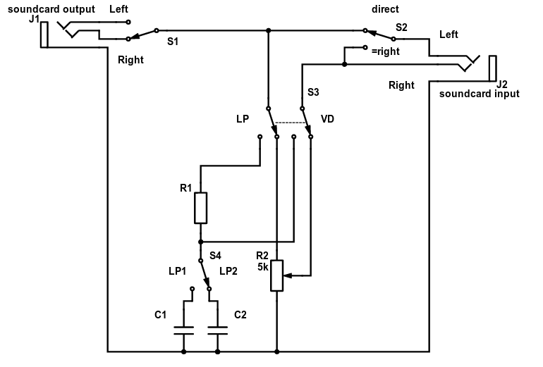

Thank you for the elaboration. I have understood what you mean and why split-compensating can be realized! I couldn't imagine the true meaning of voltage divider and LPF. I respect the inventor who used them as a discriminator. The scales fell from my eyes. We use the phrase exactly as it is in Japanese because the original was translated from English.😀
Calibration sequence plan for frequency F, current output level Ao, input level Ai
1) Measuring LP Filter Transfer
This step does not require any preliminary calibration as it uses only relative values between channels.
* Switch S1 at right output channel
* S2 (left input) at direct
The step involves three substeps:
A) Measuring/remembering attenuation and phase shift at harmonic frequencies of fundamental F, using left/right ADC channels
* S3 at LP
* S4 at corresponding capacitor as needed
Measured using sine fitting, a few seconds for 10 harmonics of 1kHz fundamental
B) Measuring phase shift between ADC channels for at harmonic frequencies of fundamental F, using left/right ADC channels
* S3 at VD
C) Subtracting the interchannel phase shift from the filter phase shift measured in A, storing transfer to file.
This rather lengthy calibration step should not be required often as it measures only two passive components, calibration should hold.
2) Measuring Gain of Each Output Channel for Calibrating Virtual Balanced Output
* S1 at right output channel - measure left ADC channel amplitude
* S1 at left output channel - measure left ADC channel amplitude
Since both DAC channels are measured with one ADC channel, DAC gain coeffs can be directly calculated for each DAC channel. The DAC gain correction makes sure both channels output exactly same levels, allowing for correctly balanced output.
This step requires capturing only a few amplitudes of fundamental to measure the amplitude, should take a fraction of second.
3) Measuring/Calculating Split Distortions of both ADC and DAC channels
* S2 at =right - both input channels will receive same signal
Plan - fitting Rout -> Lin & Rin at the same time
Step A) Measuring fund/distortion peaks for voltage divider equations
* S3 at VD at fundamental F
* Potentiometer at level corresponding to filter attenuation at fundamental F
* regular calibration sequence resulting in joint-sides params on both channels - approx 1 second
* since both input channels are fed from single output channel, the measured fundamental amplitudes provide directly interchannel gain difference for gain correction of virtual balanced inputs.of fully compensated
Step B) Measuring fund/distortion peaks for filter equations
* S3 at LP at fundamental F
* regular calibration sequence resulting in joint-sides params - approx 1 second
Step C) Calculating split calibration values for Rout, Lout, Rout
* 4 equations with 6 fitted parameters (3 x ampl&phase), no delay
Step D) Measuring fund/distortion peaks of Lout with ADC channels split-compensated
* S3 at VD
* regular calibration sequence at any of the output channels. Since both ADC channels are already compensated at this step (for the incoming input level), the measured distortions correspond to yet uncompensated DAC left channel. Takes approx 1 second.
Summary
The relatively long step 1 measuring filter transfer should not be performed often.
The standard calibration steps 2, 3, 4 measure only at fundamental freq and should not take more than a few secs when fully automated (relays, relay-switched R-2R network). They result in:
* split calibration of all output and input channels at current frequency, current output level and closest current input level
* equal-level calibration for virtual balanced outputs and virtual balanced inputs
The balancing of outputs/inputs (when enabled in GUI) will be performed by inverting (DAC side)/subtracting(ADC side) split-compensated and equal-leveled single channels. This should yield maximum performance from the available hardware.
Time to rewire the existing tool and start coding the steps...
* S3 at LP
* S3 at VD
* S3 at VD
Summary
Does your compensation algorism handle four harmonics(2nd,3rd,4th, and 5th order)? What I mean is DSM ADC and SAR ADC apparently have a different pattern of distortion. AFAIK, distortion of DSM ADC is usually up to 5th order. That's why you have a successful result with compensation up to 5th order.
Distortion of SAR ADC has wide deviation than DSM ADC(my post #69). The evaluation board by AD also has such performance (attached pic). This is probably because of its architecture, where internal C2C DAC may be the dominating distortion source. Analog components, irrelevant to R2R or C2C, can't be ideal like DSM ADC which has no analog ones in a conversion process. The reason I use SAR is that they have better SNR than DSM though they are inferior in THD.
Anyway, I have a plan to design DSM ADC(AD7768) which probably doesn't have high order harmonics more than 6th.
The harmonics-detection code (by miero) covers all harmonics up to fs/2. The dual-tone code looks for all the by-product combinations too. At dual-tone 4k+4.5k example of https://www.diyaudio.com/forums/equ...ensation-measurement-setup-5.html#post5622372 the code compensates tens of harmonic/by-products distortions simultaneously.
The splitting code is still hard-coded for 3kHz and 5 harmonics. TBD, as almost everything 🙂
The calibration and compensation code can work with any frequency of distortion (whole Hz). However, there must be a way to determine correct phase when generating the distortion compensation sine. Distortions related to the fundamentals (both single and dual tones) have their current phase calculated by determining the time offset between stored calibration profile and current time from the fundamental params. That is not possible for unrelated distortions, e.g. 50Hz mains, 1kHz USB frames, soundcard oscillator by-products, etc. We can measure them, generate the compensating sine, but do not know what phase to use which renders it useless.
I thought your algorism uses 5th order polynomial to compensate distortion. But If you generate the distortion compensation sine with the opposite phase, It doesn't mean polynomial calculation but sum between the input signal and the opposite phase sine. If so, it seems to me that all harmonics can be treated(multiples of 1Hz) and have a promising future. Am I correct?
Well, my previous post started with "the harmonics detection code covers all harmonics up to fs/2" 🙂
The polynomials are long gone, they were a good start but proved incapable of inverting all distortions to opposite phase. The hard-force (measure -> generate opposite) is reliable and works for (limited) two-tone signal too (splitting does not support two tones, hopefully not yet).
great!
I'm very happy to know your successful results was done by the hard-force. Honestly speaking, I'm doubtful about the polynomial solution because it's too complicated and can't handle large numbers of harmonics. Generating opposite phase sines(the hard-force) is simple and effective. It's a mystery why nobody(including me) designed such compensation algorism so far both in software and hardware.
The scales fell from my eyes again. I can't find a negative issue about the hard-force besides some limitations(amplitude and frequency) which are usually not fatal for a DIYer though it's not preferable for a commercial product. My current DIYed ADC isn't ideal because the same two ADCs can't output the same results with the same input signal. I can say they are ideal up to 110dB THD. If I implement such compensation algorism into my ADC, I'm sure I can guarantee up to 130dB THD. I have decided to design the firmware of FPGA to do the hard-force next spring. It can achieve a successful result like you in hardware configuration.
I would not want to program all the math in FPGA, but if you are skilled in that, it is certainly doable. The calibration profile holds surprisingly stable, you may even not need calibration often. Unfortunately dependence on signal level is strong, the calibration must involve multiple levels.
