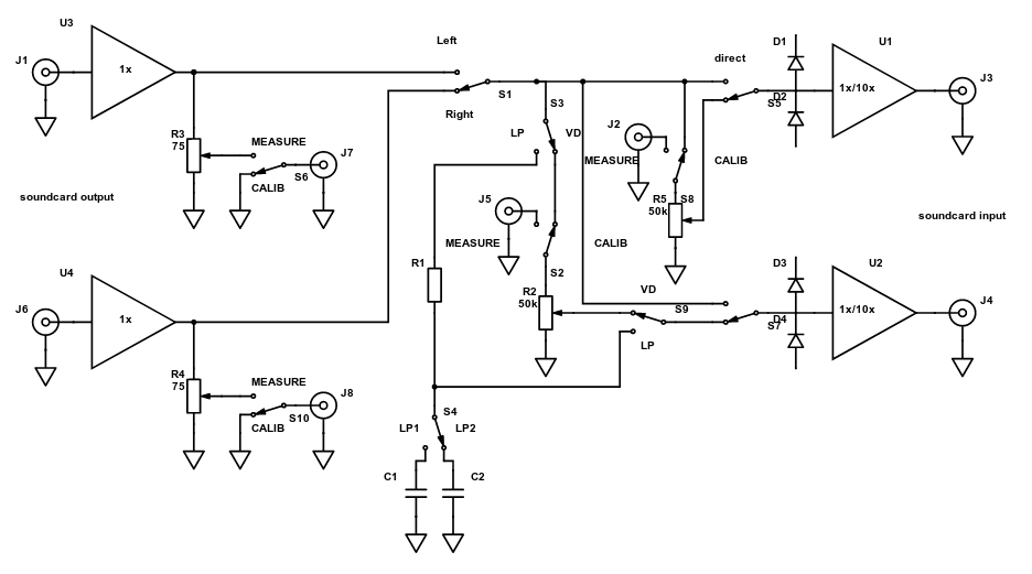

The next step now is coding the actual calibration process using real soundcard measurement adapter. For that either a more complete version of https://www.diyaudio.com/forums/att...mpensation-measurement-setup-tool-diagram-png with switches and potentiometer can be hacked.
Or a proper/final version with arduino-controlled relays is designed/built/written support for in octave.
I would like to ask those experienced with soundcard adapters for comments on this plan:
DAC Side:
soundcard stereo output -> stereo opamp unit buffer with decent output power -> stereo output voltage divider (75Ohm resistance?). The voltage divider will be connected permanently, even during calibration, to keep the distortion constant. Output terminals relay-switched between divider outputs (measuring) and ground (calibration).
The output divider made of 4 DPDT relays, yielding 16 steps, 3dB each, max. attenuation -45dB. Each step for each channel pre-calibrated in software (no need for precision resistors) to allow for decent balanced output with each branch (in fact L/R channels) distortion-compensated (enabled/disabled in the GUI control panel).
ADC Side:
stereo input voltage divider (50kOhm?) -> overvoltage protection with low-leakage clamp diodes to +/-3V -> stereo opamp buffer relay-switchable gain1x/10x -> soundcard stereo input
Calibration Loop
Loop taken from output of the output buffer -> one channel of the input voltage divider used for calibration at exact current input level -> input buffer
Distortion of the output buffer will be compensated as part of the DAC side, distortion of the input buffer will be part of the ADC side. Thus no expensive ultra-low distortion opams are needed.
Since calibration is very sensitive to input level, the voltage divider must attenuate the calibration signal to fit the measured signal level very closely. Analysis keeps measuring current level at all times, relay-based attenuator is easy to control. 9 relays = 9 bits = -51dB attenuation at step 0.1dB which is small enough as tested. Again, no precision resistors required since calibration does not require precisely defined steps (interpolation works OK) and virtually-balanced inputs will have each step of each channel automatically pre-calibrated. Regular E24 series will do.
During calibration: adapter outputs are grounded, adapter inputs are disconnected/NC.
Total number of DPDT relays about 20, assumed TQ2/5V, 20 pcs at 20USD. Octave -> arduino package -> USB port -> Arduino with built-in usb-serial adapter (2USD CH340, 5USD FT232) -> ULN2003 drivers -> relays.

I am attaching a simple block diagram of the planned adapter. I would like to get rid of the output buffers, good soundcards already have decent outputs. Would e.g. 300ohm output divider hooked directly to the soundcard make sense?
OK, adding one or two extra chips on the adapter board is no complication. Please any suggestion for the output buffer opamp? The buffer will be part of DAC-side compensation, output power is more important than ultra-low distortion, IMO.
For input I am thinking of OPA2134UA, I already have those.
I wonder about input coupling caps - film EPCOS 10uf/100V (2USD each)? They will not be part of the distortion-compensated ADC side, thus low distortion is important. I already have the epcos from an ebay seller with good references on eevblog forums.
I see some soundcard adapters use 100kOhm input divider. I want to keep noise as low as possible - would only 50k do? Or even less, similar to input impedance of soundcards (30k)?
Thanks a lot for any hints.
For the output buffer I tend to go with OPA604. Max. current 40mA is OK for max 2V to 75ohm output divider = 26mA, unit-gain stable, inexpensive. Single version for better PCB layout and separate power filtering. I do not want any additional interchannel distortion which is impossible to compensate - in the virtual balanced output mode each channel will run in the opposite phase.
Unfortnately the OPA604's distortion may be a limiting factor even if you try to correct it. For low impedance drive there are some new chips designed for headphones that have significantly lower distortion. New Audio Op Amp - OPA1622 Or add a buffer for the current. Even if you can correct for distortion its probably better to minimize extra sources.

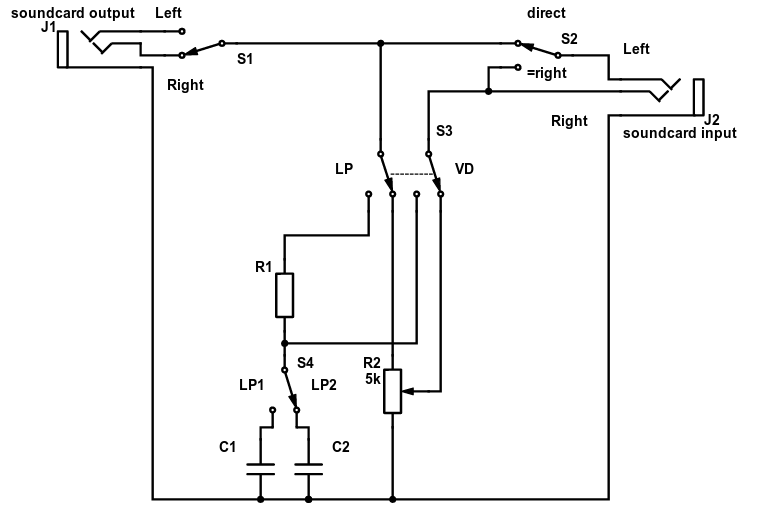

For the input it depends on what you are testing. If a preamp can't drive 10K I consider it borderline broken. Most analyzers are 100K in. A divider with 100K should be fine. Use larger resistors. 1/2W through hole or similar thin film SMT. You should not need any compensation caps if the impedances are low (10K or less). 100K may need a samall parallel cap to compensate for the load capacitances.
If testing a power amp you can use the load resistors as part of a divider network.

Hi Demian,
I very much appreciate your info.
OPA1622 - of course I would love to use the newest/most modern components. 145mA output current looks great. The package is rather DIY unfriendly, nevertheless the ebay DIP8 kits may be genuine since they cost slightly more than single quantities of the chip itself from reliable distributors.
Input divider - Honestly I would like to avoid the compensation capacitors. The goal of my project is creating a low-cost very low-distortion measurement setup using decent but still common soundcards (100USD pre-owned). These soundcards are not exactly ultra low-noise. I am not aiming at competing with AP (yet 🙂 ) I would prefer lower input impedance/lower noise/no compensation caps to input stage with high impedance which is difficult to make low-noise/compensate with caps.
As of input amps - do you think LME49710 for switchable 1x/10x gain would be OK? I will design the PCB for mono SOIC8 version and any opamp can be used.
I wonder what is the procedure for setting the compensating capacitor value at frequencies close to fs/2 where no high-bandwidth "rectangular" signal can be transferred to look at compensation effect? Measuring absolute transfer value for various frequencies? That would also compensate varying frequency amplitude transfer for the rest of the ADC chain.
IMO the attenuator could be frequency-compensated mathematically in octave instead of trimming capacitors, likely much more precisely.
