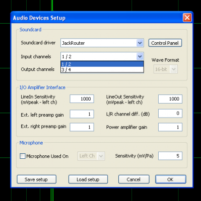

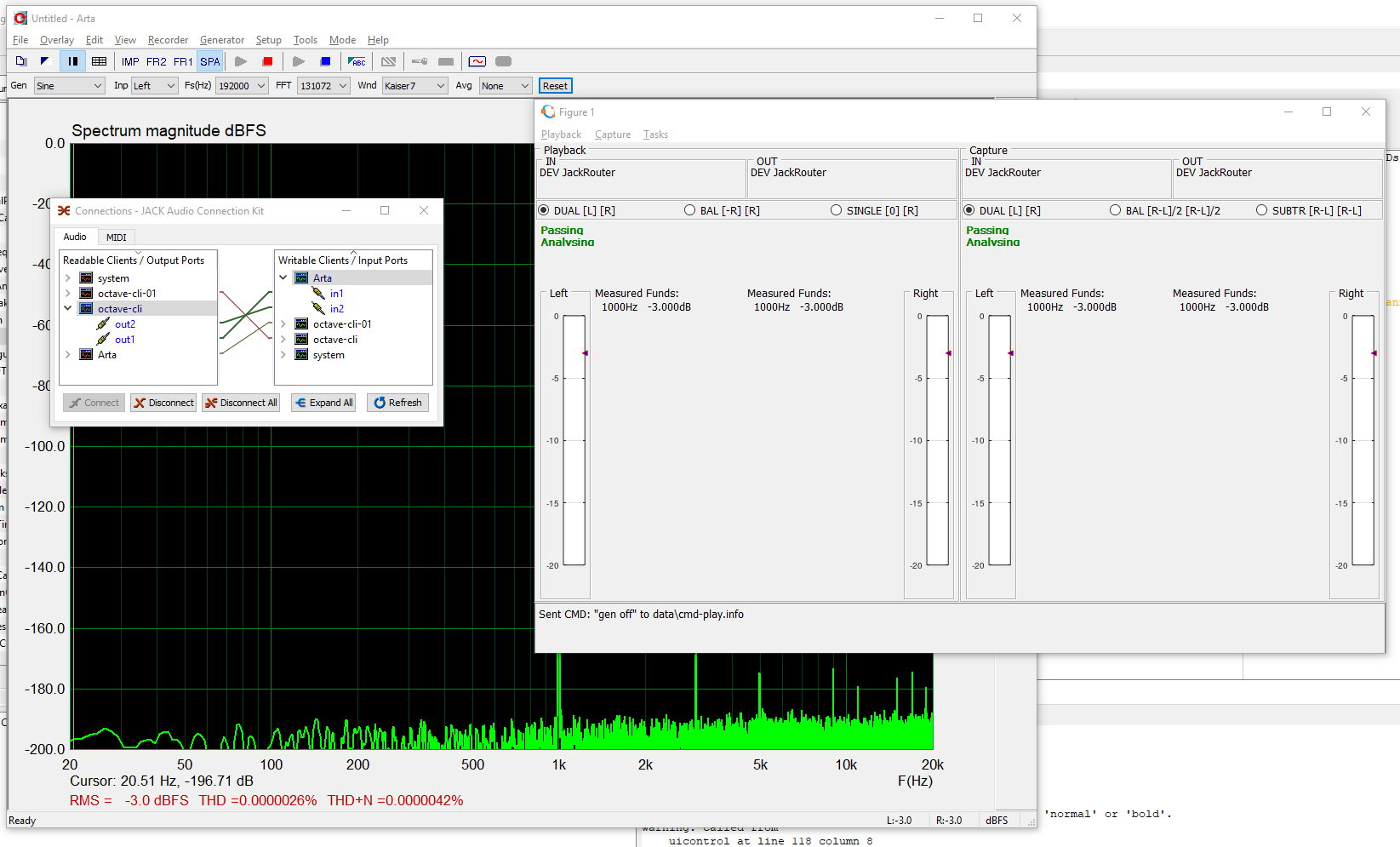

The wonderful Jackd (ported from linux to windows) offers multiple virtual ASIO devices with any number of channels JACK Audio Connection Kit|Using JACK on Windows. The patch configuration is easily scriptable (the GUI is just a layer on top of a command-line program, the whole chain can be started automatically with a script - BTW that is the way to code good software, not like GUI-only driver tools without any automation available that most HW manufacturers sell for windows/OSX).
The attached screenshot shows Arta -> ASIO JackRouter -> playback process in octave -> ASIO JackRouter -> capture process in octave -> ASIO JackRouter -> Arta FFT, 192/24 (jackd uses float32 internally). Again - this is how a bit-perfect chain should look like, but this time natively in Win10.
It will work.
It will work.

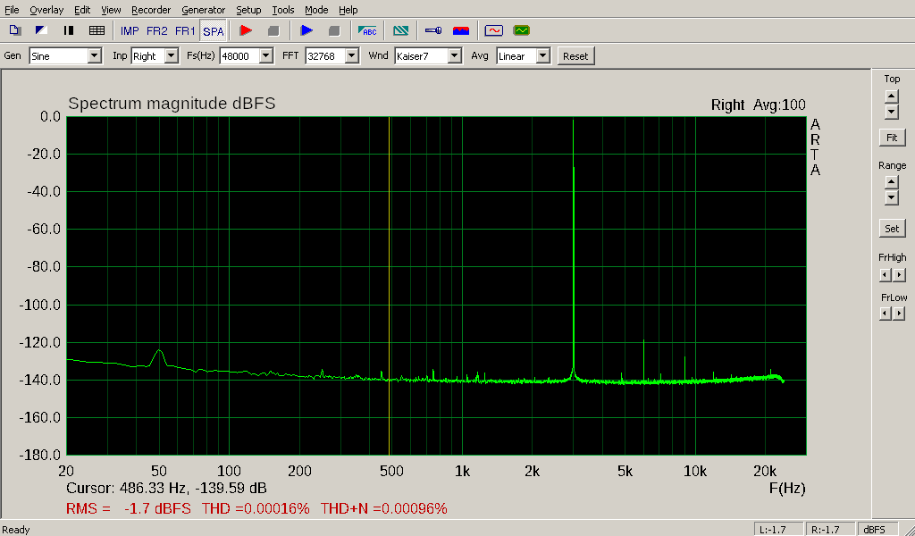

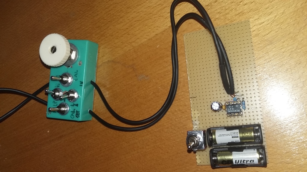

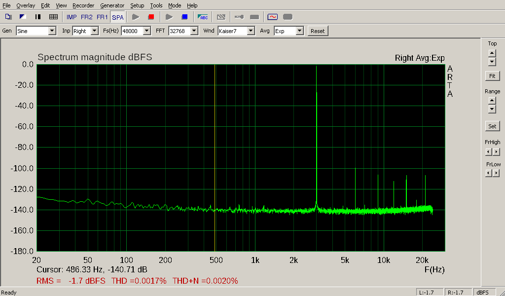

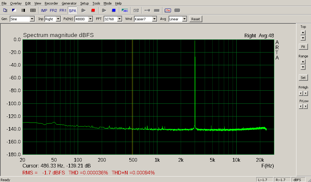

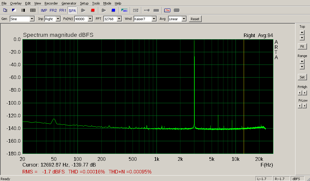

My very first real measurement - opamps distortion. Noniverting, unit gain, output reduced by -1dB with a voltage divider.
Images:
1. The adapter with simple opamp measurement board connected.
2. Non-compensated measurement of RC4556N at 3kHz
3. Split-compensated loopback at the same level as the previous measurement
4. Compensated measurement of RC4556N
5. Repeated compensated measurement of RC4556N
6. Compensated measurement of NE5532P
7. The tool split-compensating both sides during measurement.
Clearly NE5532P has lower distortion than RC4556N. Both distortions are way above the compensated loopback distortion.

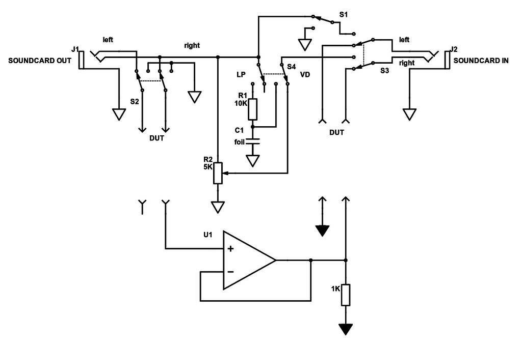

I am glad the dirt-cheap 10-turn Bourns fake pot from ebay does the job perfectly, allowing easy setting down to a few thousands of dB. Since both voltage-divider and low-pass filter transfers are measured and used during the split-sides calculation, the wire-wound pot inductance does not matter.
The 5k pot is connected to the soundcard output permanently to keep same load during calibration and measurement.
The subtracting input mode was used: R input signal minus L input signal while L input is connected to output ground. This eliminated ADC artifacts and common-mode noise, to some extent.
Images:

This simple adapter version is suitable for compensated measuring of non-balanced circuits. No output/input level equalization is available. Only one (fixed) output channel is calibrated/compensated.
Using only one input channel would be too much of a compromise because in single-ended measurements it is also important to subtract the ground-loop noise and/or ADC artefacts. Yet only one input channel (right channel in the diagram) needs to be calibrated/compensated, the non-calibrated/non-compensated left channel is used solely for subtracting the common-mode noise.
In measurement mode both output and input soundcard channels are available for any uncompensated usage.

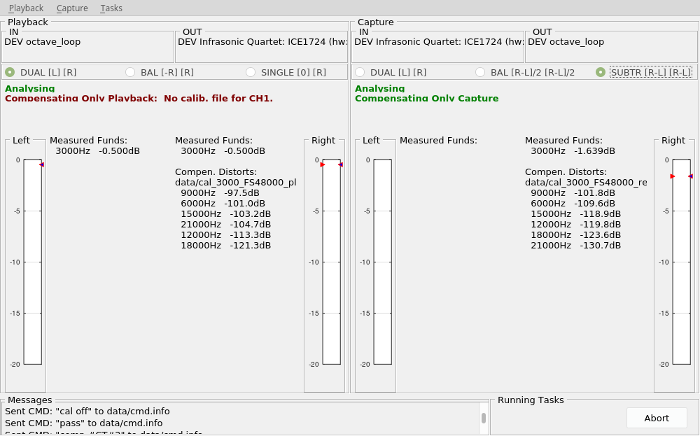

Okay, I have not build your interface box yet but, octave and playrec.mex setup works.
How do I get your gui up ? Via octave --gui ?
Sorry I'm very new to octave
Very good.
Plus:
One terminal - octave mainPlay.m - that is the playback side
Another terminal - octave mainRec.m - that is the recording side
These two processes are sending zeromq messages to mainCtrl which controls and displays UI.
Please update the latest version (git pull).
The configs have been recently renamed to final name - configRec.m, configPlay.m (.example versions are stored in the repo).
First please configure playrec device IDs in nonlinear-compensation/configRec.m.example at master * pavhofman/nonlinear-compensation * GitHub , nonlinear-compensation/configRec.m.example at master * pavhofman/nonlinear-compensation * GitHub + the corresponding devices in the other direction nonlinear-compensation/configPlay.m.example at master * pavhofman/nonlinear-compensation * GitHub (all in .m versions, of course).
What does your octave mainListPlayrecDevs.m say?
