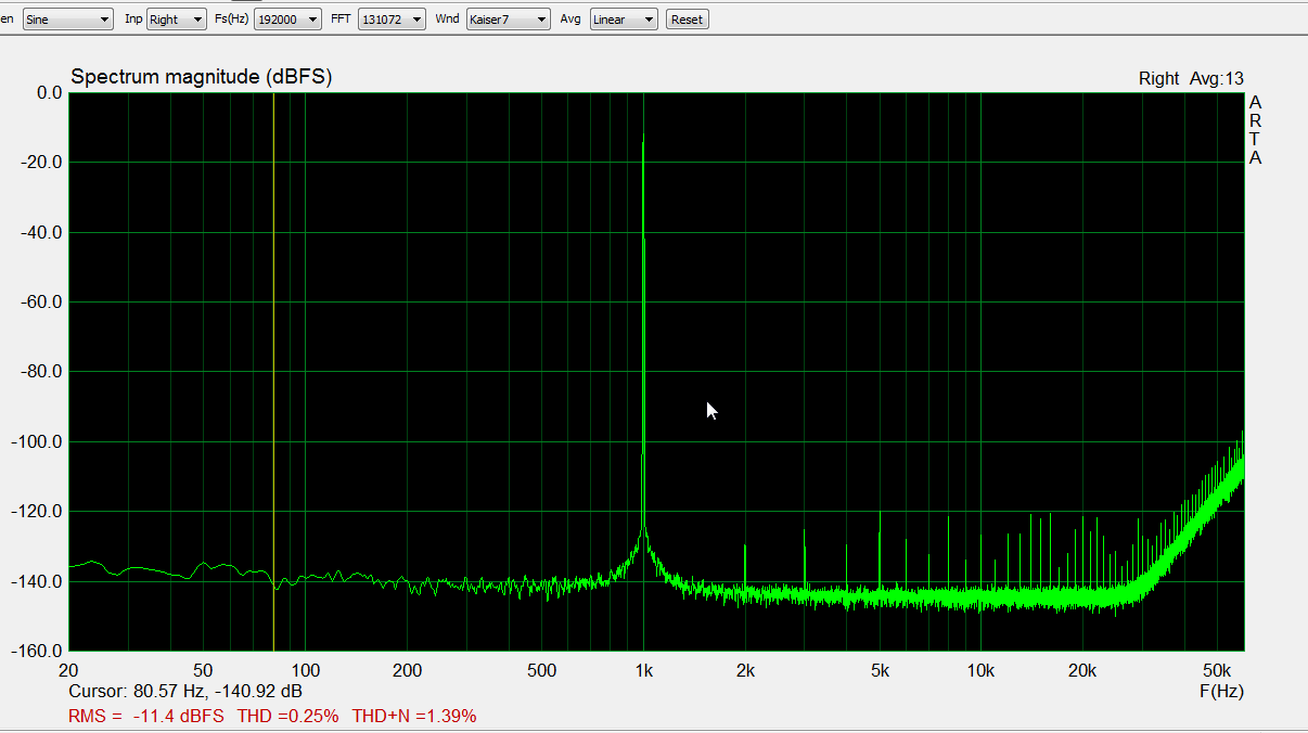

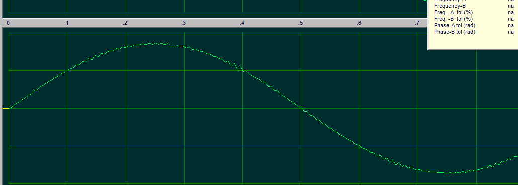

Yes, there are some glitches on waveform at 192KHz with asio4all.
Generally, asio4all have some issues and with other software from my experience.
It is the same with native EMU ASIO driver. Maybe it is all the "Noise" about 30Khz giving Diana problems
@Edmond Stuart I have not yet got 196kHz working with Diana on any setup (xp-win7-win10)
Note on test setup: Lenono T7250 - Win7/32bit - EMU0202

Hi Thumb,
I suppose you also have tried different ASIO buffer sizes/latencies. If not already done, just give it a try.
Please, also be aware that if you run a 32bits program under a 64bits OS, you also need to install the 32bits ASIO driver and not the 64bits version (that is, if I remember correctly).
Cheers, E.
