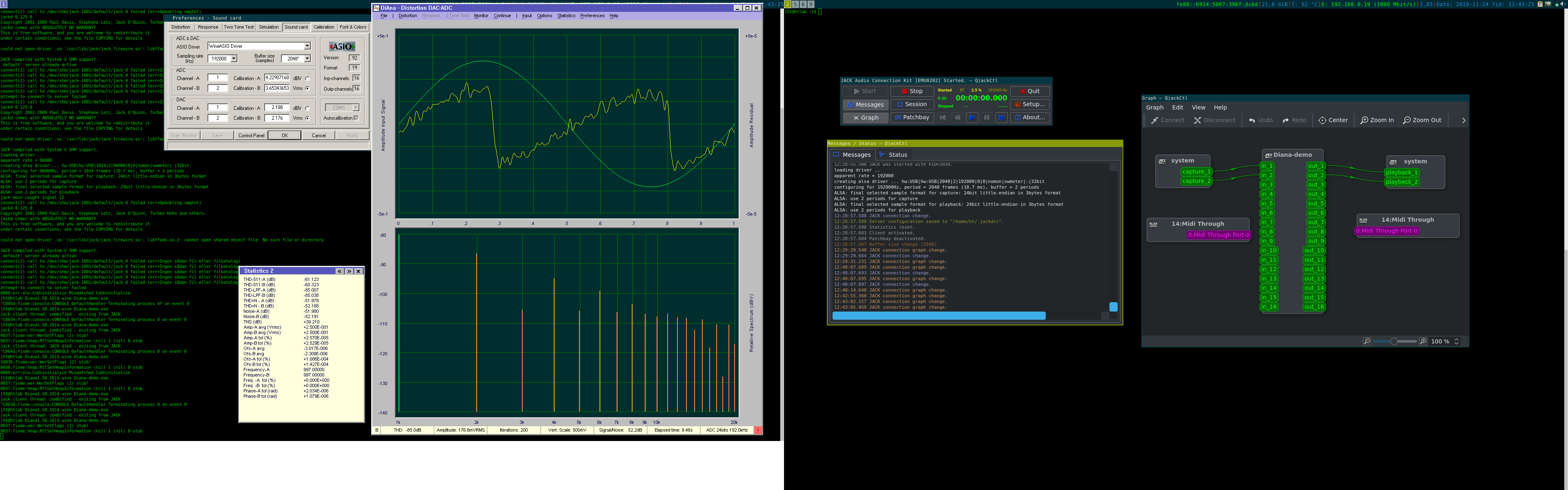

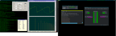

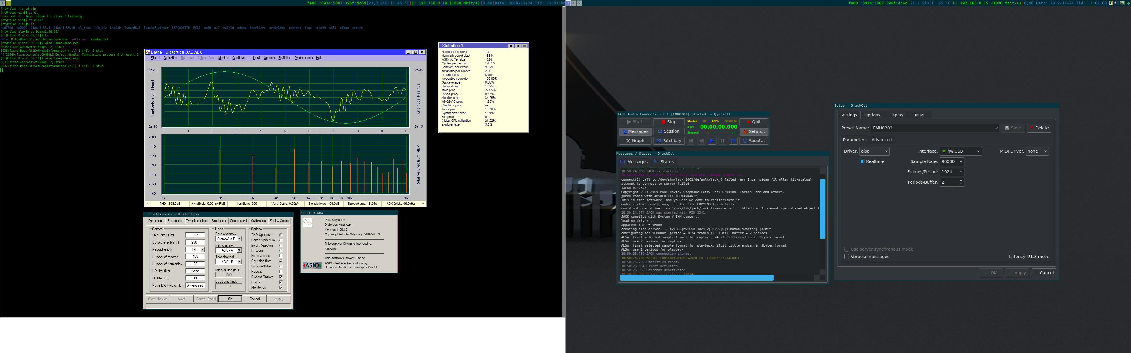

Diana works in a linux setup. Install wine, wineasio , qjackctl. And setup as 32bit windows.
I have done it in archlinux , the "Amplitude" and "Vert.Scale" is not correct but I think everything else is correct.
It feels stable, no problems with "Super user" rights etc.
You did it! Great! As for incorrect amplitude and vert. scale, are you sure you have entered the correct calibration factors?
Cheers, E.
