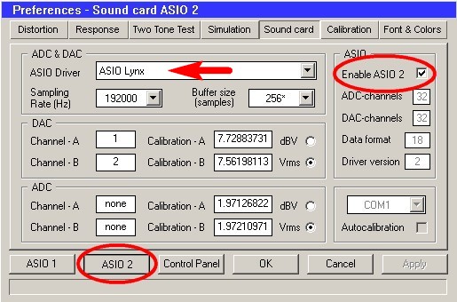

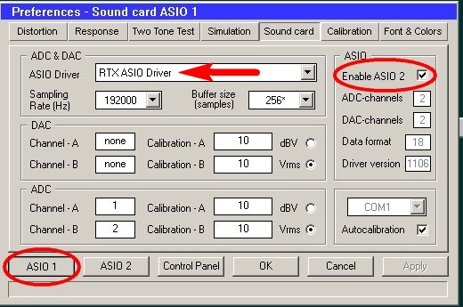

Hi Edmond, is it possible to use two ASIO devices in DiAna? One for source and one for input?
Hi alyks,
Yes, that's certainly possible, that is, with a special experimental version of DiAna.
Please, give me your email address via a PM and I will send you that version to you.
BTW, with this version, it's even possible to specify different sampling rates and buffer sizes for the DAC and ADC ASIO drivers.
See the pictures below how to select the two drivers.
Cheers, E.
