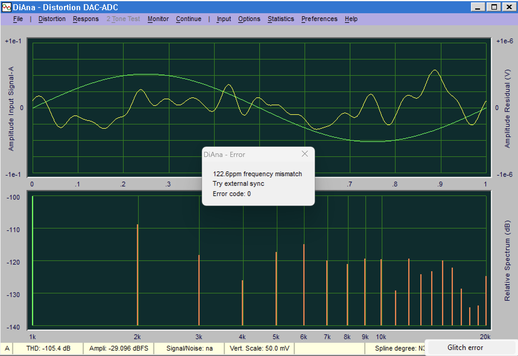

Ok, So I'm running Windows 11 under Parallels 11 on a MacBook Pro M1 Max (so not an Intel chip), and using a UA Volt 2 USB interface.
One note for others with similar setup: In Parallels define your USB interface as default mic and speaker output, not you Mac's mic/speaker.
I've ran "Distortion" got two errors, see attached image.
Any suggestions? Thanks!

OK, I noticed something strange, if I click "Distortion" a couple of times, I will be able to run it without error. As a note, there's nothing else running on my computer that's either taxing its resources, or accessing the Volt interface. The computer is quite fast, with 32GB RAM and a M1 Max CPU, although Windows is only allocated 4 CPUs and 4GB of RAM.
Again, perhaps somebody can share their insights. Thanks!
@ parkerdan,
So DiAna detected a glitch, probably as a result of a drop-out in the audio stream. This turn also affected the frequency discriminator, hence one more error message. Regarding the capabilities of your computer, nothing wrong with that.
Try different settings of your sound card: buffer size and/or sampling rate. Maybe you can find a "sweet spot" without glitches.
E.
PS1: Also have a look at statistics page 4, which lists a bunch of possible errors.
PS2: Try another audio analyzer in order to figure out whether DiAna or something else (e.g. the driver) has issues.
