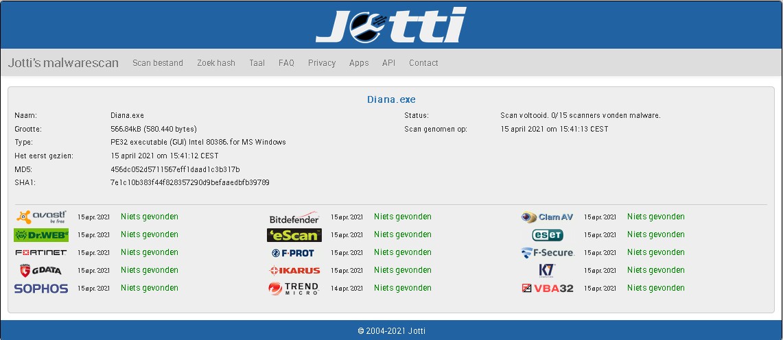

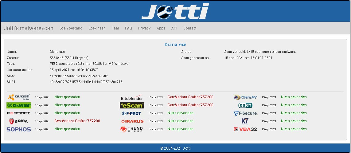

The following piece of code triggered false positives, see fig. 1.
int e;
LARGE_INTEGER QPF; // counter frequency
e = QueryPerformanceFrequency( &QPF ); // get counter frequency
if( e ) cb->IQPF = 1.0 / QPF.QuadPart; // convert to double and invert
else cb->IQPF = 1.0 / 3.3E6; // error and avoid div by 0
When changed to this:
cb->IQPF = 1.0 / 3.3E6; // assume error
then the false positives are gone, see fig. 2.
This clearly demonstrate how stupid some AV scanners are. Even the most simple and harmless lines of code are misinterpreted and mark them as a virus.

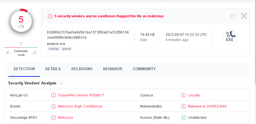

Even the smallest possible Windows program, which does absolutely nothing, triggers some (crazy) AV scanners.
This is the 'program':
int APIENTRY WinMain( HINSTANCE hInst, HINSTANCE phi, char *CmdLine, int CmdShow )
return 0;
And below the five panic-mongers. Just wondering who still takes those idiotes seriously.
