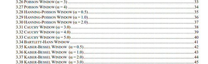

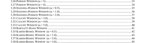

You guy are talking about two different things, all window functions have side lobes that can limit resolution (you can't get something for nothing). This is the best survey of windowing I have found (picture is from this reference). BTW Jan is talking about a method to lock the signal to exact bins needing no windowing, just another technique.
Spectrum and spectral density estimation by the Discrete Fourier
transform (DFT), including a comprehensive list of window
functions and some new flat-top windows.
G. Heinzel∗
, A. Rudiger ¨ and R. Schilling,
Max-Planck-Institut fur ¨ Gravitationsphysik
(Albert-Einstein-Institut)
Teilinstitut Hannover
February 15, 2002
This is also a very good resource:
https://linearaudio.nl/sites/linear...ound Card Instrument Manual & FFT windows.pdf
Characterization of 60 different windows, their transfer functions + example apps.
Jan

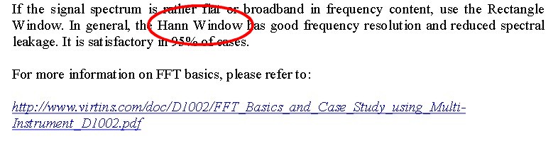

Huh? Those Germans call it a Hanning window? Grrrr. A good reason to not read that stuff. 🙂
More seriously, no window at all (i.e. a rectangular window) gives also rise to leakage (depending on the continuity of the input). Applying windows is just a matter of distributing the leakage in another way over the spectrum. Some windows increase the resolution, while other windows increase the accuracy (of the magnitudes).
The Virtins list talks about a Hamming window, a Bartlett-Hann window and a Hanning window. Different windows.

I do have problems calling it a Hanning window. According this 'logic' one also should talk about a Hamminging, Kaisering, or Barletting window. Rubbish of course.
His name is von Hann period.
Only an illiterate idiot would call it a Hanning window.
NB: Also Richard W. Hamming calls it a Hann window (in "The Art of Doing Science and Engineering") and he knows what he is talking about.
E.
edit: No! See page 4 of your link in post 1041. 🙂The Virtins list talks about a Hamming window, a Bartlett-Hann window and a Hanning window. Different windows.

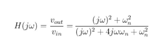

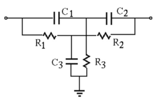

Hi Braca,
Is it like the X-fer function as shown below? This one applies to a passive twin-T filter that I'm currently using.
E.

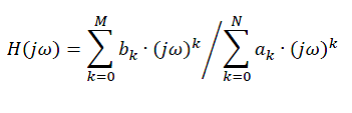

Hello Edmond,
Yes, this is the essence of the idea.
For the data entry, it would probably be easier to use the rational function form attached below.
For a third-order filter, it would be M = N = 3; and the polynomial coefficients would have to be provided by the user.
Using complex arithmetic in your program, it is then easy to calculate the gain and phase at a given frequency.
Braca
Or a combination - using series of user-supplied amplitudes and phases at several frequencies to estimate the b_k, a_k coeffs with nonlinear regression and using the estimated transfer function at any frequency of the chart.

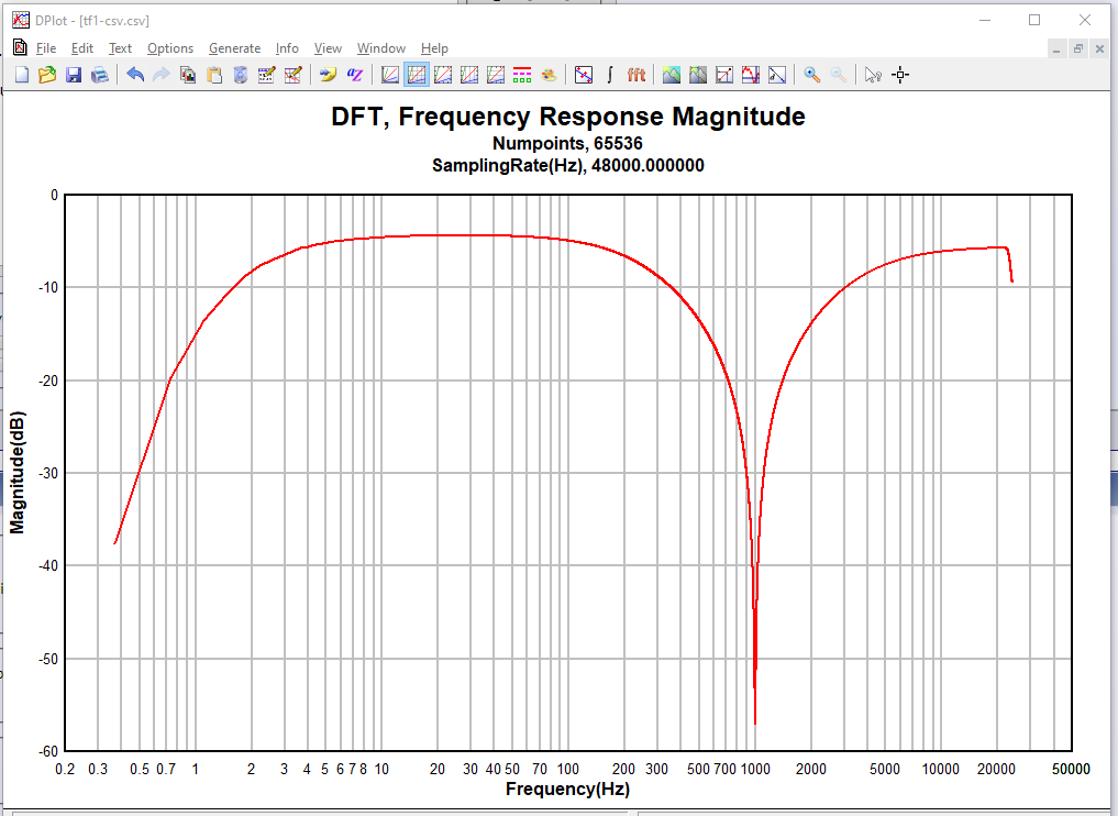

Would it maybe be useful to have 64k points charactersing the notch filter from 0 to Fs/2?
I had ARTA measure my Didden Twin T balanced filter. File attached. Rename extension to TXT or CSV.
Most programs seam to use dB for the magnitude.
Yes.
