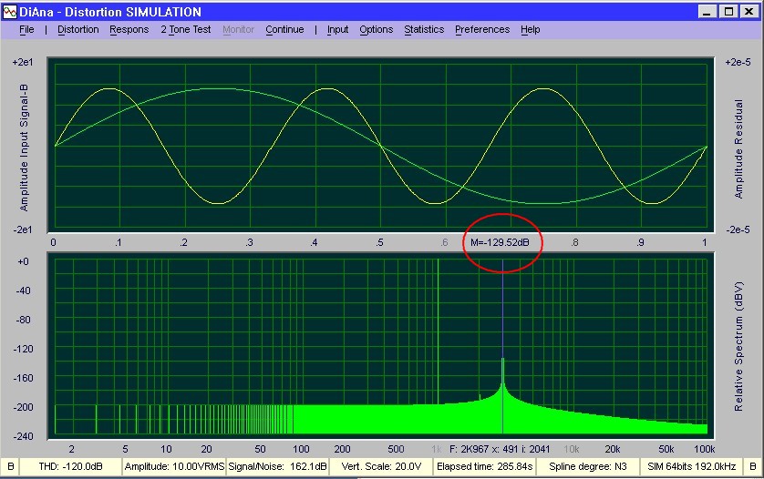

Dear Edmond:
I am trying out 1.59.2 Demo on Windows 7. Having tried most PC based audio SW, I am intrigued by your SW!
A few comments/questions:
1) In Prefrences one can choose HP and LP filters. Say 20 and 20kHz. But when I look at the RAW spectrum it goes down to 0.2Hz and above 20kHz. This is a little confusing. Should the range not be 20-20k?
2) Would it be possible to show what noise BW (A-weighted, or freq range) in the result presentation. That is, -105.3 dBA or -105.3 dB(A), -123.4 dB(20-20kHz)?
3) If I enter 20 000 as BW, what start and stop freq are used?
4) If I use A-weighted BW, should the raw spectrum not reflect that, ie be falling down towards lower freq?

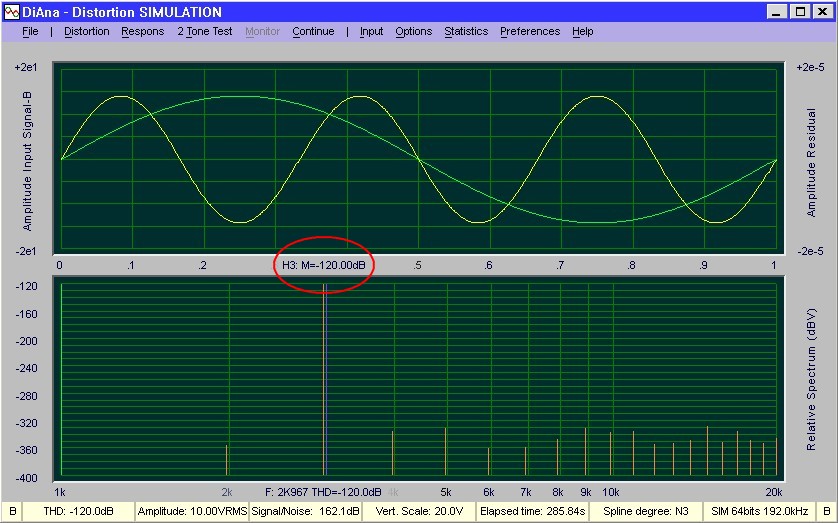

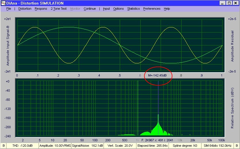

No, it is what it is. The HP and LP filters act only on the signal itself* and not on some scale. However, the bandwidth of the THD spectrum can be set by the Number of harmonics and the kind of filtering by choosing Gaussian or Brick-wall.
As for the raw spectra, they are only meant as a kind of 'treat' and of secondary importance. The main purpose is to detect hum and other spurious signals.
For those interested in the harmonics, just have a look at the THD spectrum. Remember, DiAna is a distortion analyzer (not just another spectrum analyzer).
As for the Noise BW (A/B/C-weighted), these settings have only effect on the calculation of the Signal/Noise ratio and nothing else (as it should be).
Have fun with DiAna,
E.
* To be more precise, the HP filter act on the input signal and the LP filter only act on the residual. Also note that the THD spectrum is based on this residual.

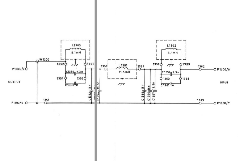

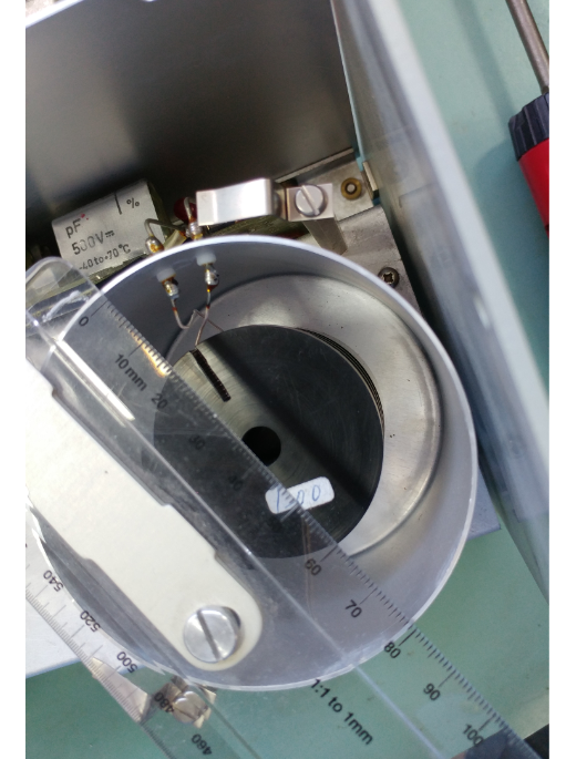

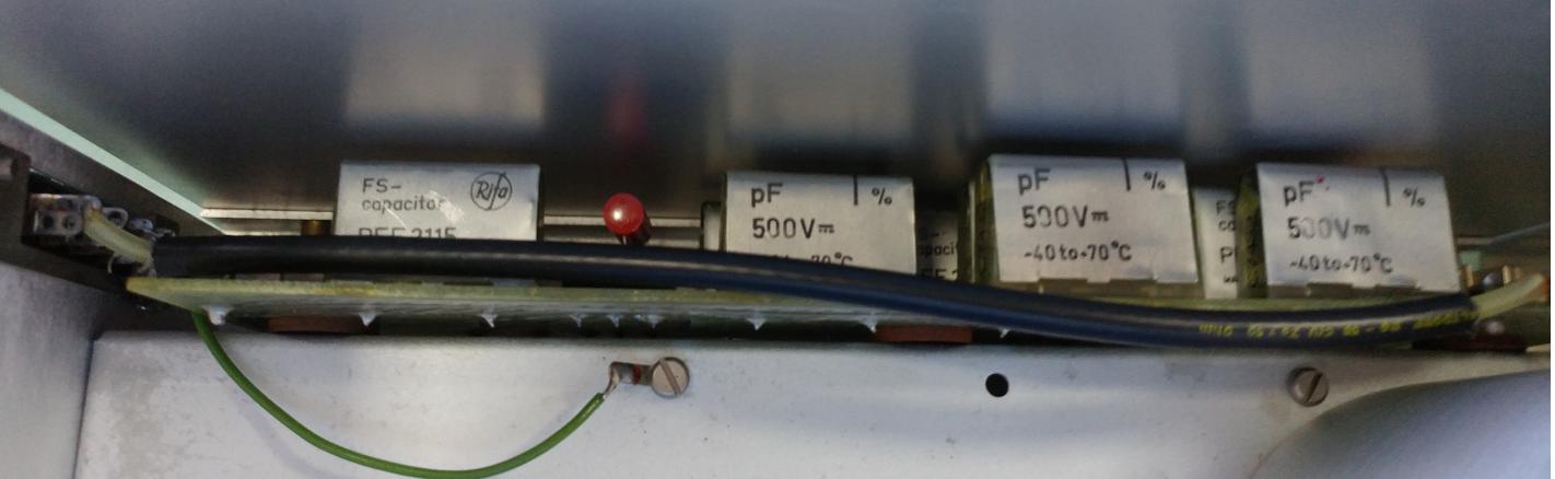

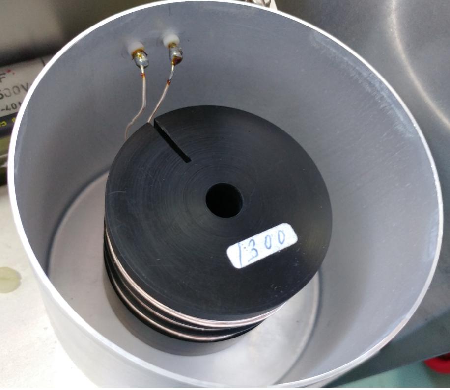

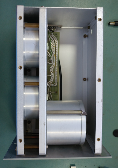

FWIW here is the circuit and construction details on the RE CLT-1 Radiometer CLT-1 low pass filter. Its a 10 KHz LP filter that helps get -170 dB at 30 KHz, at least -160 dB passing 1 Watt at 10 KHz. As I remember the internal source is .01% or -80 dB so the filter gets 80 or 90 dB at 2 octaves.
Success is all about construction details. The size of the coils and the size of the shields should help for a sense of scale. For 1 KHz or 100 Hz I don't think you need to scale directly (those would be huge) but I don't know.
There is a matching transformer in it to get to 1 KV or 100 mV into a component. Its a big pot core, almost the size of a bowling ball. Even though the instrument is in a triple case with each module in an aluminium box and the whole system is a double box its still quite sensitive to external fields around 30 KHz which was a problem back in the days of CRT monitors, especially VGA monitors.

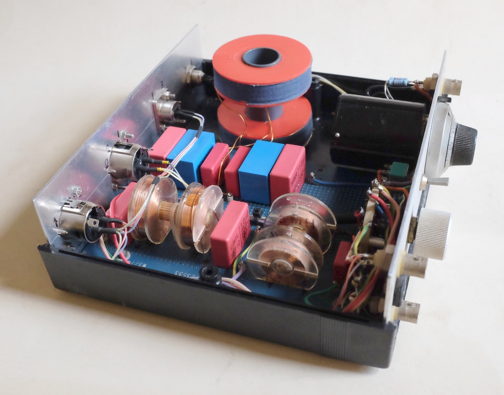

😎 😎 Building it this way, such a filter becomes a project on it's own right, let alone at lower frequencies. I really hope it can also be done with ferrite pot-cores without too much distortion.
Below a picture of my (simple) band-pass filters for 1, 5 and 20kHz (critically coupled).
E.
PS Note that the resonators are inductively coupled, resulting in a galvanic isolation between input and output too (avoiding ground loops).

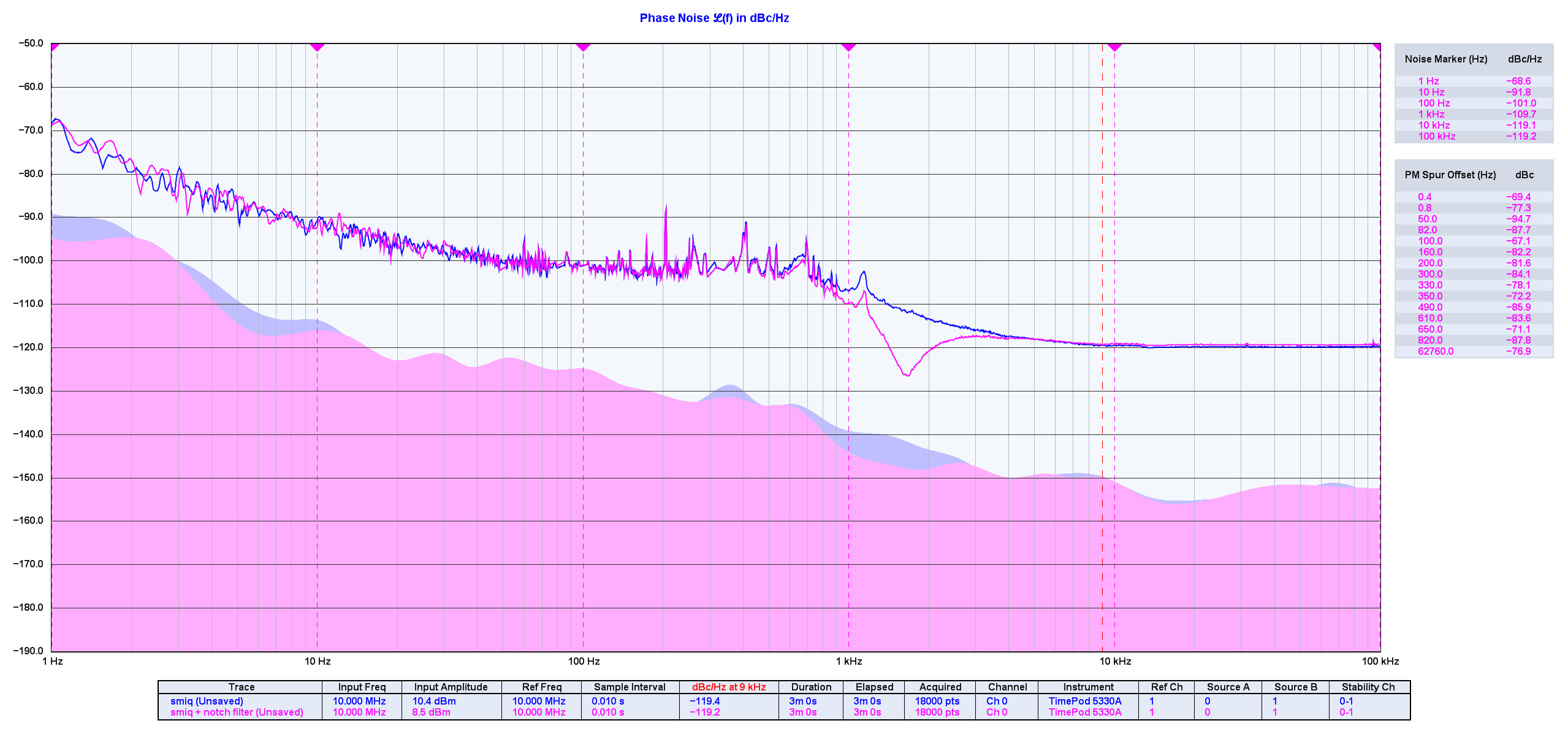

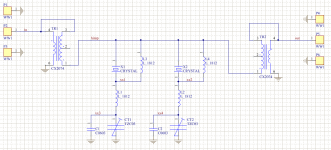

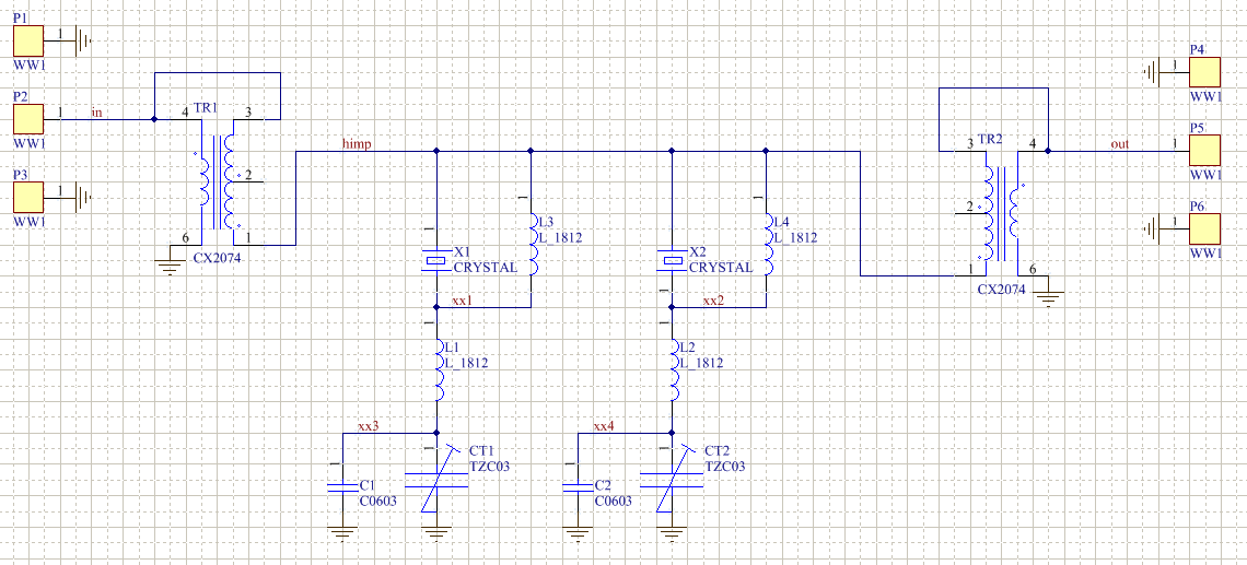

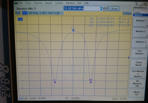

I have made notch filters for 10 MHz+-1.5 KHz to remove some phase noise at least
locally so I can get an idea where it pays to optimize.
This had to be implemented with crystals, an LC resonance would be much too wide.
But a crystal behaves like a series LC and in the KHz range LC will do.
A crystal has a loss resistance like 20 to 50 Ohms at resonance, so we need at least
a 400..500 Ohms environment to get an effect. This is done here with the transformers.
It could be done with resistors.
The crystals simply shunt the part of the spectrum at their series resonance to GND.
Since the phase noise happens equally above and below the oscillator's frequency,
we need 2 notches, one at +1.5 KHz and one at -1.5 KHz, otherwise we get 3 dB
at best.
The beauty is, that the series circuits are exited only by the little bit of noise that
happens to be at their frequency. They completely ignore the carrier. I can send
real power through that filter with no damage. If I would tune the oscillator across
the series resonance, that would shatter the crystal.
So, the distortion of the resonators at AF would only be triggered by the already
small power level of the harmonic, not by the fundamental.
