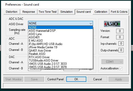

Hi Edmond,
Can you please mention (here or on your web site) soundcards that have been successfully used with DiAna?
Thank you
Thank you
used the following:
ESI Juli@
EMU 1212, 1616
Lynx L22
RME HDSP9632
RTX
QA401
Pretty much anything that can support an ASIO interface properly. Some of the above were harder to get working but that's typical with the DAW software as well.
ESI Juli@
EMU 1212, 1616
Lynx L22
RME HDSP9632
RTX
QA401

Would the EMU 0404 USB also be in this list?
Thanks!
post 946 ...
I saw post 946 but was uncertain if the USB version fell within this description. I guess it does?

Hi Demian,used the following:
ESI Juli@
EMU 1212, 1616
Lynx L22
RME HDSP9632
RTX
QA401
Could you be more specific about "Some of the above were harder to get working" ? Which one and what caused the trouble, the driver, the OS or DiAna? In case of the latter, maybe I can do something about it.
Cheers, E.

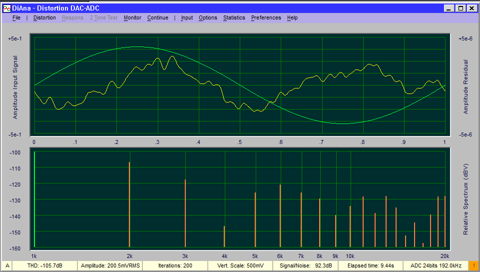

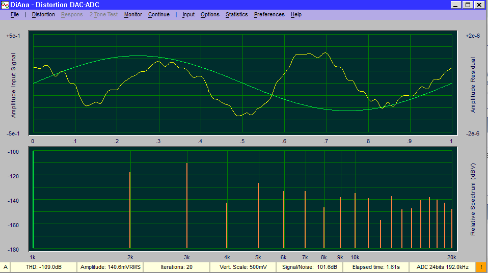

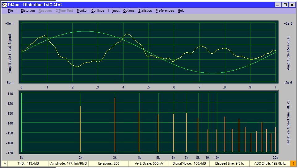

The issue with the pro cards usually has to do with 16/32 I/O channels and which are the live ones and in the EMU creating an EMU setup that will connect ASIO to the correct in and out. The latest Windows screwed up the drivers and needed to install a set of patches (E-MU 1616m, 1212m, 1820m, 0404 Audio Interface - Complete Windows 10 (1903 & Above) Installation Guide - KVR Audio) to get it working again. Its all installed now.
Everything is working (see below) on Windows 10 pro 1903.
Note that the Lynx and the EMU use the same ADC. They have very similar distortion signatures.

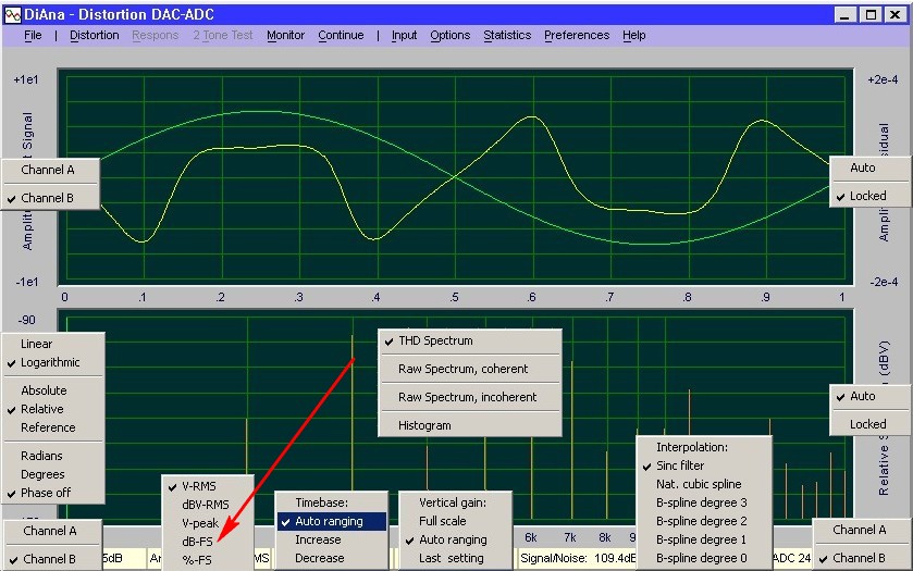

Edmund- Based on my experiece with the tests above is it possible to add a display based on dBFS? It would help when trying to determine headroom or optimum operating levels.
I'll be exploring the new version with all of this and a notch filter to see what I can learn today or tomorrow.
Hi Demian,
With a right mouse click on the amplitude pane (on the status bar) you can select dBFS.
Also note all the other pop-up menus.
Cheers, E.
Cheers, E.

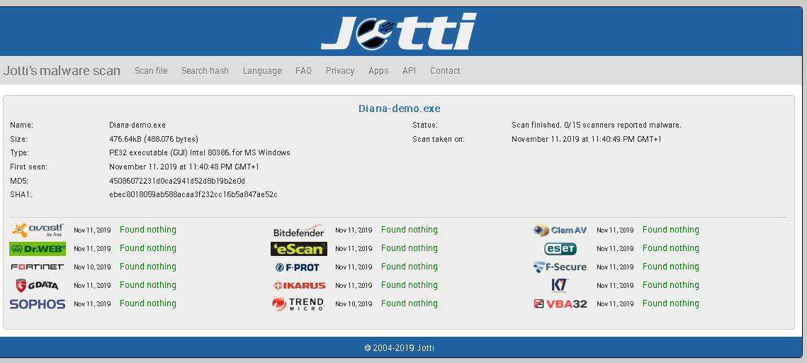

By the way, I've scanned the new version with "jotti" and it didn't find any virus (read: false positives). With "virustotal", I don't know. After too many false positives I ignore this service, because it is 'totally' unreliable (pun intended).

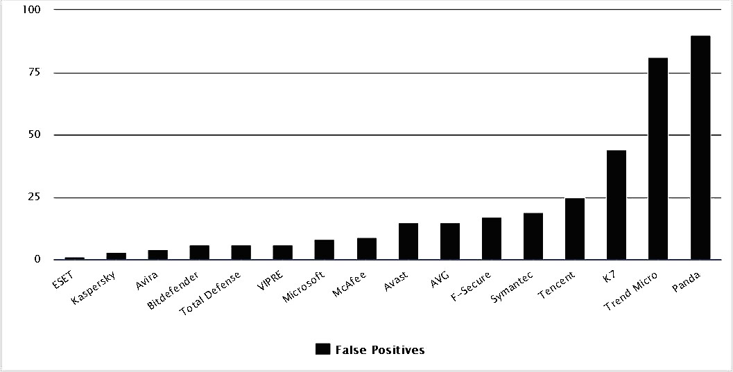

False positives
More on false positives. Please, take a look at the picture below. Some AV scanners behave quite well, for example ESET (I'm using that too), while others are horrible (like Panda).
Source: False Alarm Test March 2019 | AV-Comparatives
Cheers, E.
Cheers, E.
Hi Demian,
Cheers, E.
That's great. One other suggestion- until a formal calibration I would want it to default to dBFS since that is intrinsically "correct".
