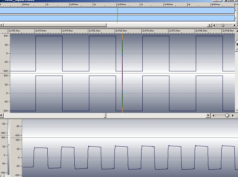

The conditions in that test:-
Top trace output cannon XLR - D-A convertor (internal). (ID digigram).
Loop back cannon XLR A -D convertor (internal)
As you can see, it's "good enough" to be considered a proper square wave.
Bottom trace output from same sound card, sent over digital SPDIF into Arcam D-A convertor.
Output from that convertor sent back into opposite channel PC card via cannon XLR A-D.(internal).
Levels were all corrected so there's no room for clipping or other nasties.
It's a valid test because the jitter on the PC sound card is clearly visible, but nothing like what comes back from the external convertor.

Which of your digital -> analog -> digital screenshots is closer?
Very clearly the TOP trace on my graph is considerably better than the one you show, with no overshoot, and only some jitter.
Your graph... is it really "as good as it can get" (?) 🙄 has massive spikes with overshoot on the leading edge, then another sharp spike on the trailing edge with loads of jitter in between.
I certainly could never use that as an audio source and/or diagnostic tool.

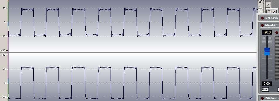

Mine has gone through a D-A then A-D, conversion, which I often use to test amplifiers at full load.
The trace I am sorry to say is far more typical of what I might expect to get back from an amplifier.
Having said that, this is what the amplifier said, which TBH is still cleaner than what you are showing...
eg.
I use such methods to test for waveforms comparing amplifiers with and without NFB to see what effect it has.
As you can see, the waveforms back from these 2 remarkably linear valve amplifiers at within 1dB of maximum power -on full chat are really quite astonishing.
They don't substantially alter the waveforms at all.

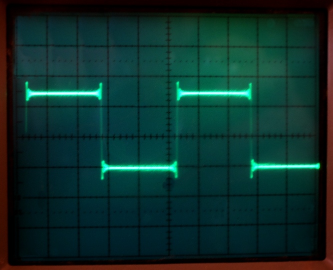

Your graph... is it really "as good as it can get" (?) 🙄 has massive spikes with overshoot on the leading edge, then another sharp spike on the trailing edge.
Yes, that is the best 1kHz square wave generated at 96kHz you can get. That is exactly what you generate in your software - a square wave bandwidth-limited at 48kHz (the Nyquist frequency). If anything else leaves your DAC, it is incorrect. Since no DAC is ideal, you will never see such symmetric and clean waveform.
Since I do not have a software properly resampling the waveform to screen pixels, resampling to 10MHz and viewing in audacity was used to view the analog/continuous-time representation.

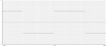

Those waveforms are a nonsense - your software interpolates/connects sample values at time points with straight lines. Just like audacity and vast majority of other tools do. If you want to see the proper waveform, resample to >= pixel density or use a proper tool.
I think you can see the sample generated in the software at 24bit resolution on the LH. (in the upper LH channel in fact.)
It looks like that going out on LH channel to analogue.
What I get back comes back in on the RH channel, direct from a voltage divider on the dummy load, so we can record the entire output for posterity.
I don't even need to re-run tests, it's all recorded in the DAW.
I think we can see on the previous posts comparing the arcam with a straight loop back, exactly what I should expect to get back.
As you can see, I don't need to do more.
Any distortion in the wave forms are easy to see.

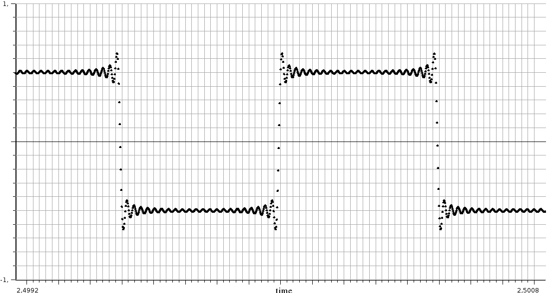

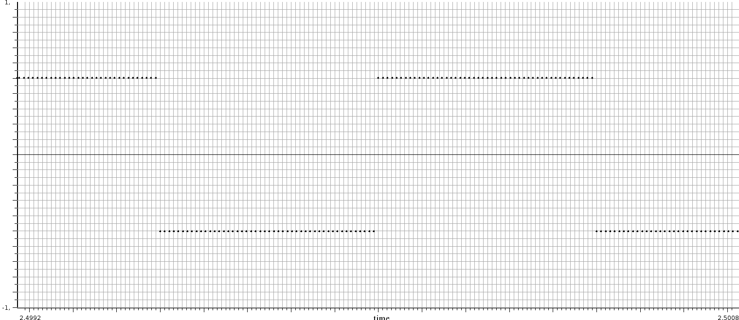

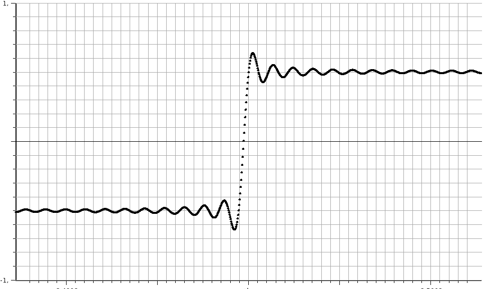

Samples are mere points - screenshot 1. D-A conversion turns these time points into continuous signal.
The 96kHz signal resampled to 96MHz, still showing sample points (the software used (snd) clearly skips some points, probably for performance purposes) - screenshot 2
The transition detail in screenshot 3 (very likely still lots of samples skipped).
Not so with DiAna. Interpolation can be done by means of B-splines (0...3rd degree), natural cubic splines (see pic.) or a low-pass sync filter. 😀Those waveforms are a nonsense - your software interpolates/connects sample values at time points with straight lines. Just like audacity and vast majority of other tools do. If you want to see the proper waveform, resample to >= pixel density or use a proper tool.

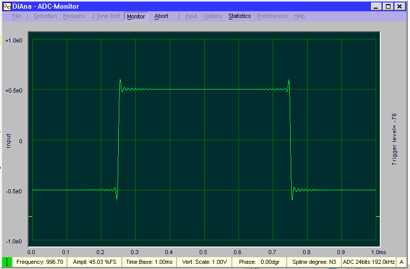

Below a square wave loop back test with the RTX at 997Hz, sampling rate = 192kHz and amplitude = 50% full scale. Note that the DAC output also shows some ringing.
Cheers, E.
Kudos to you! Very few softwares handle waveform display correctly, leading to major misunderstandings (all those NOS DAC struggles for square wave etc.)

Those oscillating symmetric square waves are typical from Delta-sigma ADC
and come from the digital FIR filtering inside ADC/DAC.
(SAR ADC's can produce much more flat square wave).

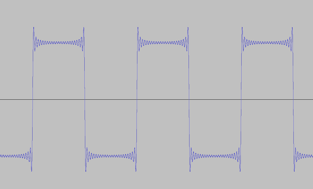

The higher the sample rate, the smaller the overshoots, i.e. the closer the sampled signal is to the analog true square wave. The higher harmonics contribute to the "sharp corner" of the square wave.
Have you compared your SAR ADC with a delta-sigma DAC outputting the same samplerate? IMO if both are correct they should produce the same output, otherwise one of them is lying (introducing distortion, i.e. not correct).

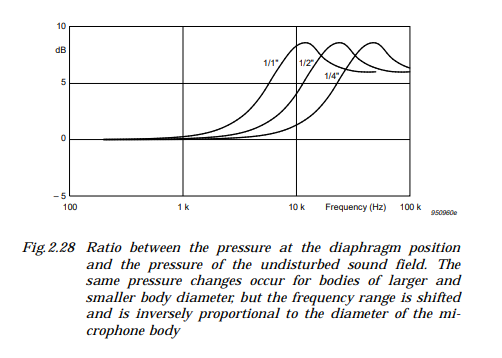

This is getting a little weird.
1) Testing an audio link through microphones and speakers looking for waveform fidelity will be really disappointing. There are many valid fundamental reasons why that won't be easy. Starting with a real world room and going on to the impact of a directional microphone. Not an easy issue to resolve.
2) Band limited square waves. Been an audio red herring for years. If you use an analog or a wide band digital scope you can see the leading edge of a real square wave. That square wave won't exist in a band limited audio chain. But audio channels are all band limited starting with the microphone, then the recording medium then the reproducing system and finally human hearing. In the analog days the brick wall was at more like 15-18 KHz and had to do with the nature of a recording head and bias oscillators. Digital had the promise of 'perfect fidelity" but only within the legitimate band and the closer you pushed to the Nyquist limit the more artifacts you have. However a real world audio link with a microphone won't have much content above 12 KHz at level and very little above 20K under the best circumstances. The distorted output from the "premium" dac was an effort for a better subjective experience as the expense of objective fidelity. Look for a measurement of amplitude and phase vs frequency to get a better idea of how faithful the channels is to the input. Acoustic square waves only exist in conditions that are dangerous to human health (and they are not square because air is not perfectly linear).
You could try recording a balloon popping with both a 1/4" measurement microphone and a normal recording chain and see how degraded the impulse is on a playback chain. However that's only really relevant to those who listen to balloons popping for entertainment. Doing the same with spoken word will tell a lot about real intelligibility of the chain which I posit is far more important.
