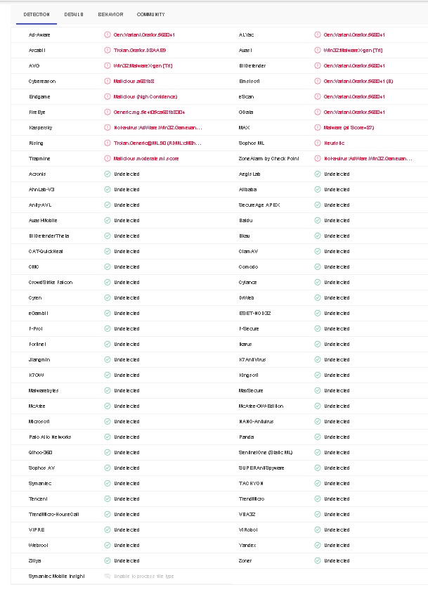

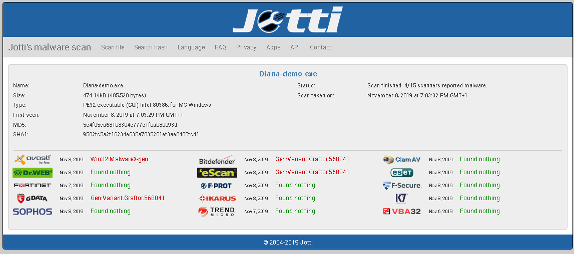

False positives
See below what the majority of AV scanners think about DiAna:
Kaspersky, for example: "Not-a-virus: AdWare.Win32.Gamevance.gen", that kind of rubbish.
Cheers, E.
Jan, I'm sorry for you. Throw away Norton and get a decent AV scanner, for example ESET/NOD32.F*cking Norton removes the file without even asking me!

Microsoft's Defender has been the best performing in many recent tests. The enterprise version is essentially the same with more ways to lock everything down. And is widely used by places that have a lot at stake and a lot of attacks. You can do worse.

Norton, McAfee, etc. are sometimes worse than malware. Windows Defender or even nothing is better. As Demian says, many large corporations are embracing Windows Defender now, it is a good product and stays out of the way.

I really like your work, don't get me wrong here, but this is 2019. You don't get awards for making small executables. Anyone could still choose to use Win32 directly for a GUI application but almost no one wants to be that unproductive. Further, it is an unsafe approach and requires elevated permissions to work, and all your Win32 calls look fishy which is why virus scanners keep flagging your software.
