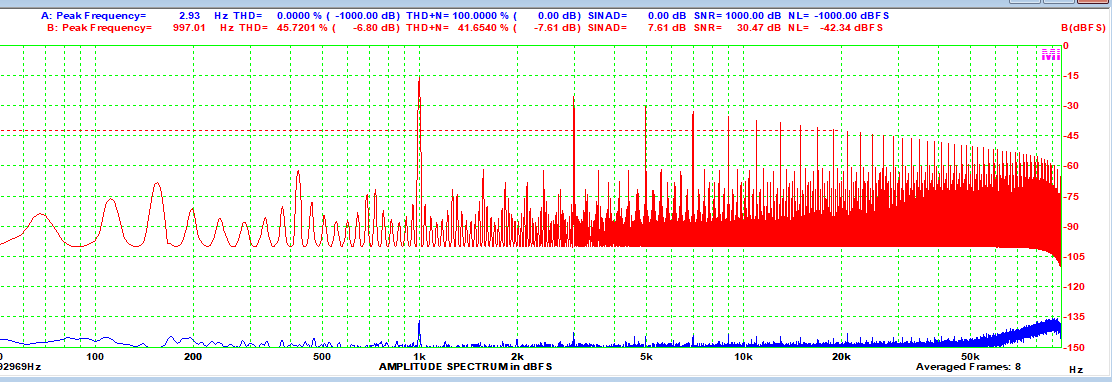

Hi Braca,
Overloading the LNA or ADC, will seriously degrade the characterization. In order to prevent this happen, you might lower the amplitude of the sawtooth waveform: just alter the NotchTestVol in the ini file. I've added this parameter in version 1.54.14 (already uploaded). But be aware that a too low amplitude will affect the accuracy of the measurement (because of a lower S/N ratio).
As for generation the harmonics, what about white noise instead of a sawtooth? Perhaps it's less sensitive to overload conditions. Anyway, I will try it that way.
Cheers, E.

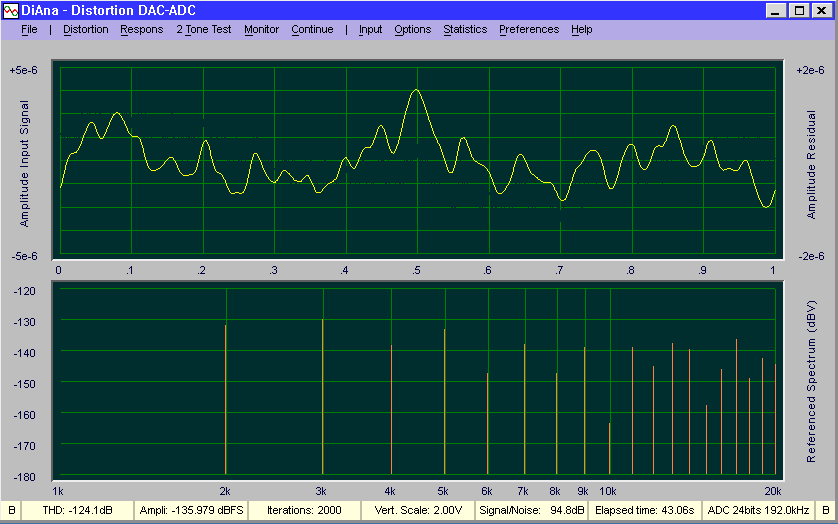

Hi Demian,
Under certain conditions this is a serious problem, because not only the fundamental, but also harmonics leak from one channel to the other. If one tries to lower the measurement floor by using a (passive) notch filter and at the same time feeding a plain sine to the other channel for synchronization (DiAna needs this), much chance that THD figures are way too high, that is, not much better then say -120dB.
The following setup clearly reveals this.
ADC-DAC: Lynx L22 @ +4dBu
DAC output voltage: 777mV (-20dBFS)
Frequency: 997Hz
THD bandwidth: 20kHz
Measurement time: 43s
ADC channel A tied to DAC channel A
ADC channel B shorted (to mimic the effect of a notch filter)
THD channel B: -124.1dB (see fig. 1).

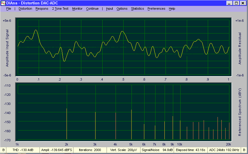

Next, I've used an ADC of a second L22 for synchronization, but still using the DAC of the first L22. Now I got:
THD channel B: -130.4dB (see fig. 2).

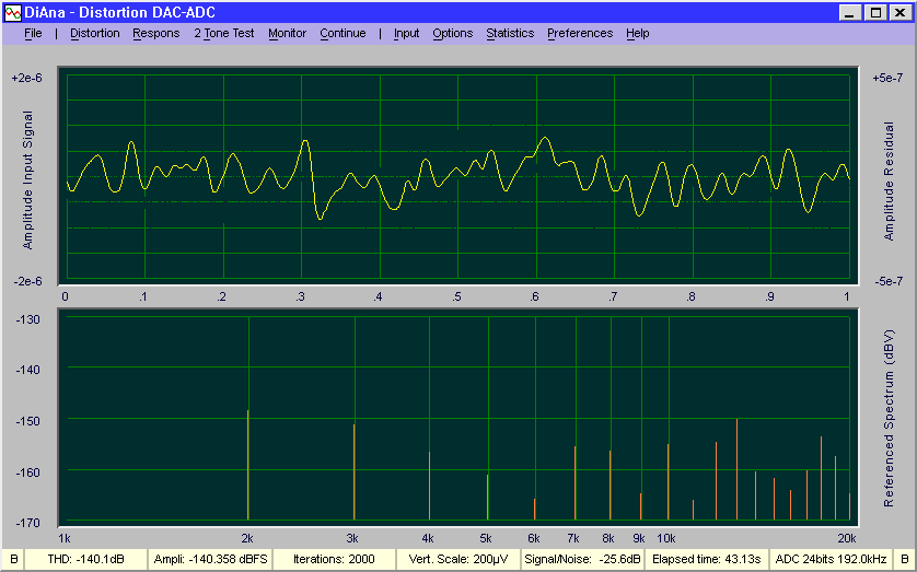

To get rid of that, one could, of course, use a DAC of the second L22, but I've added a new feature to DiAna: Using the signal generator directly for synchronization. In other words, just bypass the DAC and ADC. Then you even don't need a second sound card at all. In hindsight, this is a rather obvious solution, but for historical reasons I never thought of that before. Anyhow, using the "bypass" I got:
THD channel B: -140.1dB (see fig. 3) and by increasing the measurement time to 427s, it dropped to:
THD channel B: -150.3dB (see fig. 4).
The lower THD levels at longer measuring times indicate that these harmonics originate from noise and not from cross-talk.

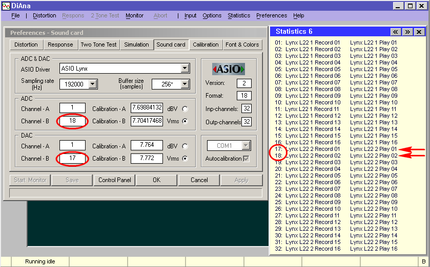

Finding channel of a second sound card
Finding the channels of a second sound card is not always straightforward. Regarding a Lynx L22, for example, it appeared to be number 17 and 18, To figure that out I've added a new statistics page (#6) which shows all channels of a specific sound card. These data are loaded when opening the Preferences-Sound card menu and selecting an ASIO driver, see picture below.

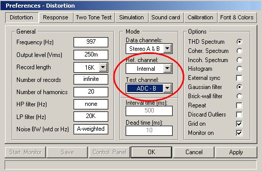

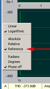

As mentioned in post #816, the ADC and DAC of one of channel can be "bypassed". Go to Preferences->Distortion, set Ref channel to Internal and select the (test) channel which will synchronized by the signal generator.
Except Absolute and Relative to which the THD level can be referred, now you also can select Reference in which case the Output level as shown in the menu will be used for that purpose (see pictures).
Cheers, E.
