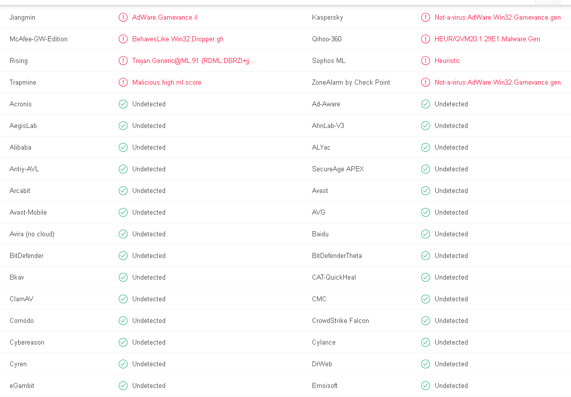

don't get me wrong here, but this is 2019. You don't get awards for making small executables.
Agreed. As nowadays memory is inexpensive, I don't expect awards for compactness, but I hope to get awards for speed. Generally, as you know, bloatware runs slower, compact software runs faster.
Anyone could still choose to use Win32 directly for a GUI application but almost no one wants to be that unproductive. Further, it is an unsafe approach and requires elevated permissions to work, and all your Win32 calls look fishy which is why virus scanners keep flagging your software.
I'm not convinced that direct Win32 API calls are responsible for false positives. Besides, contemporary high level languages produces code that rely on these calls just as well. The only difference is that they are hidden to the programmer behind wrappers etc. More over, these "unsafe" calls are still the backbone of Windows. So, for any Windows executable, it's impossible to not use them (one way or the other).
Instead, I've strong evidence that the false positives are compiler related, because I got different (number of) false positives when using another compiler or compiler options. Currently, I'm using an old Symantec compiler, while today almost any other C-programmer is using a Visual C compiler. So I can imagine that some AV scanners, who are not "accustomed" to my code, erroneously, and only based on heuristics, "think" it has something to do with a virus.
Anyhow, in case you still don't trust DiAna, just submit it to your AV company with a "false-positive white-list request".
Cheers, E.

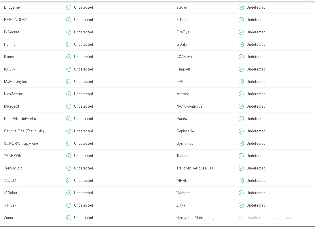

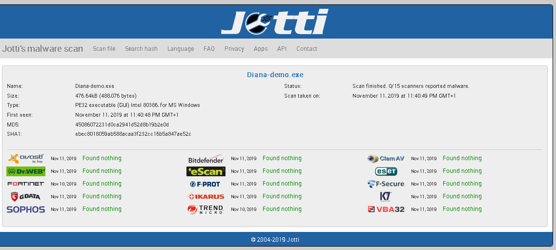

New version
Again a new version is available (1.58.10). From now on DiAna is "UAC compliant". That means you don't have to specify explicitly to run the program as administrator, as this option is already embedded. I have also repaired a minor timing bug (with the RTX + ASIO buffer size < 128 + reference mode) and relocated a few pop-up menus.
Now that the "admin rights" are built-in, the funny thing is that significant less false positives are reported. According Jotti zero, and Virustotal only 8 out of 70. Again, these weird results prove that you can't trust those whining AV scanners.
Cheers, E.

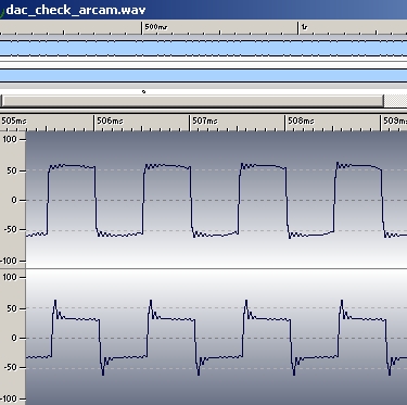

Actually, I had audio ADC's in mind (instead of DAC's). My apologies for confusion.
And Why? Because of the low-pass reconstruction filter behind the ADC. This will inevitably distort square waves.
Coming back to DAC/ADC, this is a perfect example of what I consider totally unacceptable (and expensive too!).
I have tested a lot of different sound cards & convertors, ISA, PCI, Sony DAT machines etc
(the top trace is on loop back and is clean 1khz, but no good beyond 5khz, it's an old professional broadcast PCMCIA device in my notebook, I use every day ).
The arcam one was complete crap, so you can imagine the demolition job it does on steep transients.
Funnily enough the local hi end shop turns up its nose at my notebook output, claiming their's is lots better...
I really struggle to find a DAC/ADC that behaves itself at 24-96, because the only band which shows up amp behaviour properly is in the 5-15khz band.
