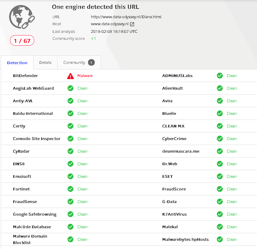

False positive
Getting a web side alert ... mira :wave:
BB
Out of 67 AV scanners, only Bitdefender thinks my website contains malicious stuff, see below. You better throw away that POC.
Cheers, E.

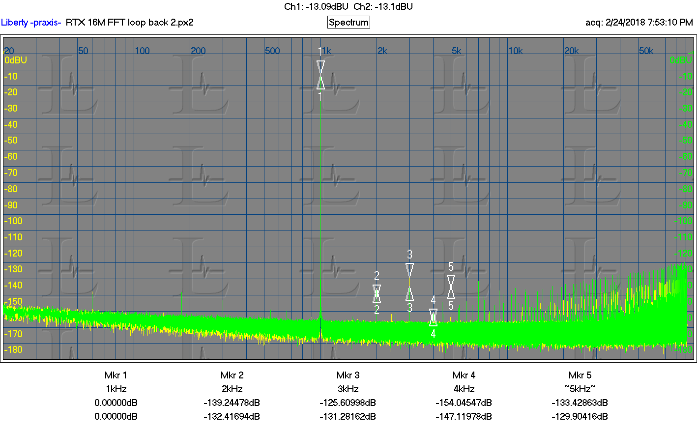

I finally had a little time to play with Diana on the RTX. It seems to work OK except for some problem rendering the fonts for the frequency in the plot. That and the scaling are not too clear in either the screen or the PDF attached. A few more reference lines at log spacing for frequency would be helpful.
I used exactly the same setup with Praxis (the other plot) and I think there are no major deviations in the distortion levels.

@Edmond = Nice work. Have you in mind that the control panel of driver doesn't work inside from DiAna. The same was and at the previous version 1.48.1
@Martin = For statistics window seems that you had 20-20K range (20K LPF), Fs_192K, gen_997Hz. Do you keep the rest of the DiAna setup? DAC/ADC calibration for specific knobs settings and the output level?
All I changed from the default was the bandwidth. I have not even looked into how the calibration process works. I'll try to show the RTX + Diana compared to the Shibasoku and the analog FFT on its output from a low distortion and a high distortion source in the next few days. They are really similar in how they present the data.

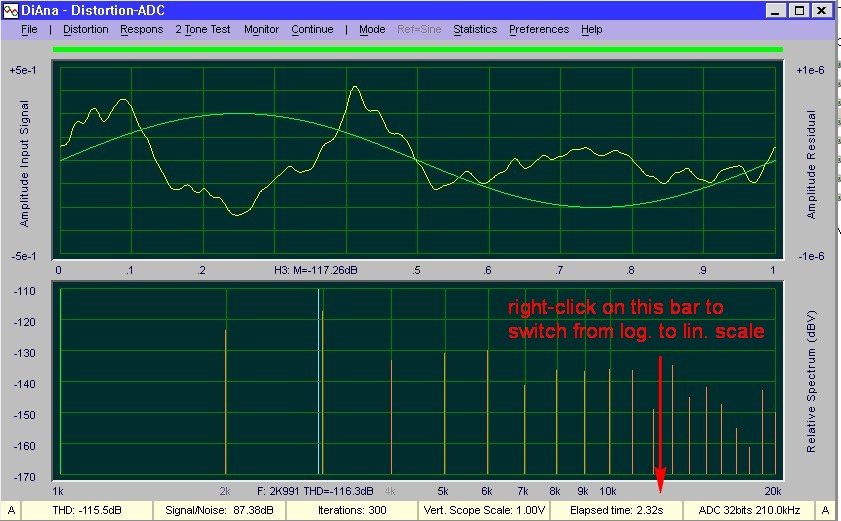

Hi Demian,
First, thank you for spending some time to review the new version of DiAna.
Indeed, there is a problem with the font and number of reference lines. Thx for pointing this out. It's a new bug and probably the result of recompiling the program with Symantec C++. I'll try to fix it as soon as possible. See pic below how it should look (and did look before recompiling).
>the scaling is not too clear...
Without calibration, scaling is 1.0V referenced to the peak amplitude (full scale) of the ADC and DAC respectively, i.e. V(FS), as the calibration factors are set per default to 1.0. These factors can be adjusted in the preferences->sound card menu. Please, see also post 55, 116 and 122.
Cheers, E.
