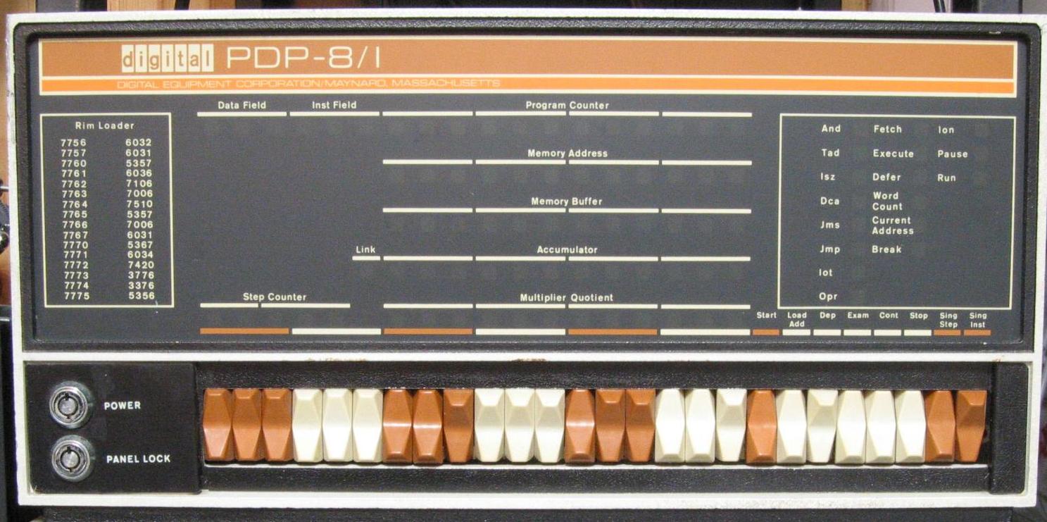

I still remember how we toggled every morning those switches (see pic).[...]
The boot loader was keyed in through 24 toggle switches in the front panel.

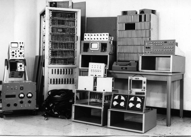

This is the forerunner of the PDP series that I worked on at Washington U. in St. Louis. It is the Classic LINC for the Lincoln Labs of MIT, and was the first product of the New company called DEC.
Notice the Oscope and the computer have similar sized output screens.

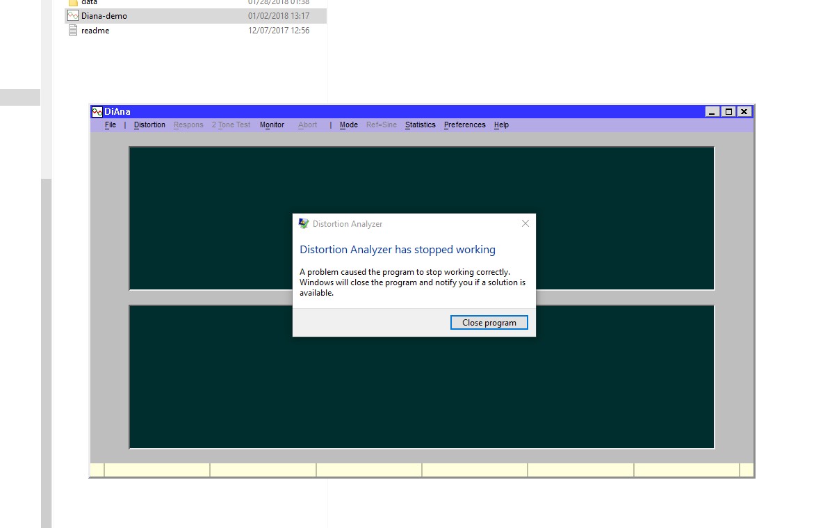

Hi to all.
What is going with Diana, the project is continue?
I have changed the OS on my lab PC, from XP Pro to 10 Pro.
Unfortunately, I have a major problem with the Diana and I don't know how to resolve it.
The initial running goes well (running as administrator), follow a small popup window with Y or N and rapidly closed and the Diana "stucked" in loop with the window prompt as the attachment file.
Unfortunately, the .ini file dosen't exist and I can't change the parameters, and I was no any lucky with the registry values.
I forget to say, that I have make the right setup on Windows Defender for the Diana, also I have tried to running the Diana with the compatibility to older OS (WinXP-Win8)

Hi Manolis,
I'm sorry to hear there are issues again.
Which version are you currently using? The latest version on my website is 1.47.7
Of course I've also run the program under W10 (64 bits) and encountered no problems. It also runs fine under various compatibility mode. So I have no idea what goes wrong. Perhaps a wrong or fake ASIO driver?
In the mean time I've built version 1.47.8 Should I send it to you?
E.
edit: According to the screen shot, the program hangs right at the beginning. Right?

How well? Can you select/initialize a sound card and run a analysis?I have changed the OS on my lab PC, from XP Pro to 10 Pro.
The ini file is created (or updated) when closing DiAna normally. So when the program hangs no ini file will be created.follow a small popup window with Y or N and rapidly closed and the Diana "stucked" in loop with the window prompt as the attachment file.
Unfortunately, the .ini file doesn't exist and I can't change the parameters,
I'm not sure what you mean byh that. Anyhow, DiAna doesn't write to the registry. In only reads ASIO info from the registry.and I was no any lucky with the registry values.
When you start the DiAna, are you able to select an ASIO driver before the program hangs?I forget to say, that I have make the right setup on Windows Defender for the Diana, also I have tried to running the Diana with the compatibility to older OS (WinXP-Win8)

Hi Edmond.
I changed OS because the RTX6001 haven't any driver for the XP, unfortunately.
I am with Windows 10 Pro, 64bit for now.
Yes, I can't select any ASIO driver because the program hangs, for that reason as you very right said the ini file doesn't created.
I used the last version probably, I download it before 3-4 days.
OK, I will send my email by pm for the 1.47.8 version.

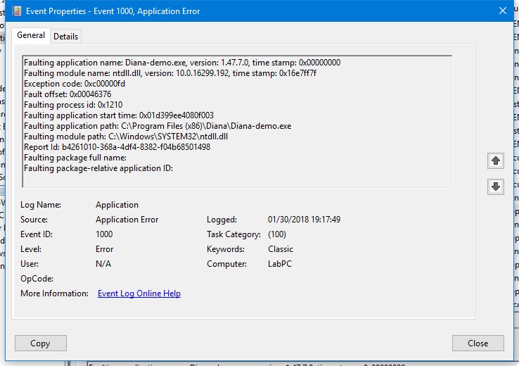

A more precisely description of error by OS event viewer.
It seems that run the 1.47.7 DiAna version.
A library file ntdll seems to crash with the program.

Hi Manolis,
Maybe you have already figured it out by yourself, but the "Exception code 0xc00000fd" means a stack overflow. Now the question is who did it: ntdll.dll or diana?
