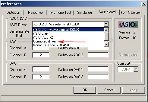

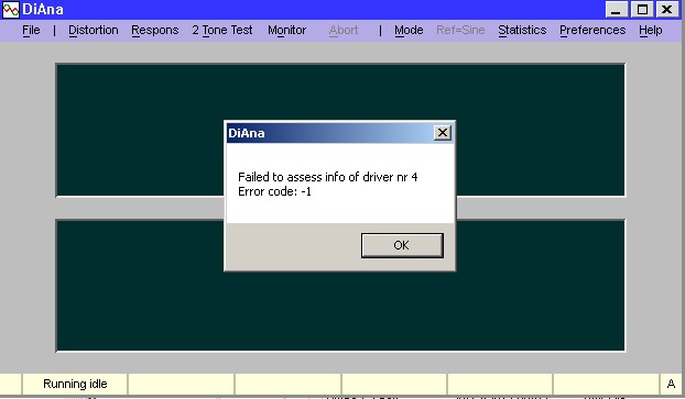

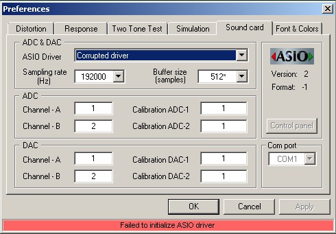

Another annoyance were the error messages during start-up. These were mainly caused by fake ASIO drivers. To be more specific, they were caused by remnants and traces in the registry of deleted drivers. During start-up, DiAna looks for ASIO drivers in the registry and, of course, fake drivers will trigger an error msg. For those not knowing what exactly was going on (me included), that was rather confusing. This error msg (see 1st pic) has been removed now, and instead of that, fake drivers are marked as Corrupted driver in the list of ASIO drivers under Preferences-> Sound card (see 2nd pic). Only when selecting that one will give an error msg (see 3rd pic).
A few other error and fatal messages will still appear during start-up, like memory error or no driver found at all.
