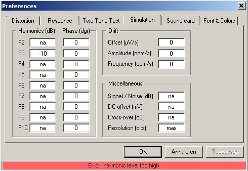

Enfin, Go to Preferences->Simulation, fill in some harmonic level (and phase), set Mode to Simulate data and run a Distortion analysis. Try different levels of distortion and see if the analysis is still in accordance with the specified levels. Harmonics above -20 dB will give an error message, see pic. You can overrule this error by clicking another four times on the OK button.

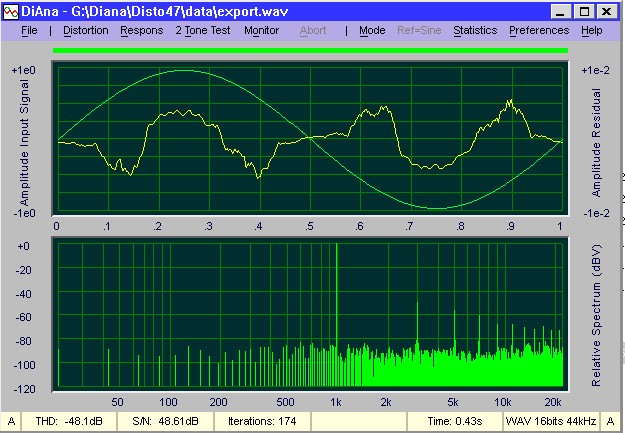

Apparently, but why??? 1sec. should be long enough.Edmond I have my spice simulation setup to output to a ,wav file. I ran off 1 sec of 1kHz 1Vp to a file and imported it to DiAna. I get a message 'premature end of file'. Is the file too short.
Weird!Also the best LTspice will do is 16 bit 44.1k. DiAna reports 16 bit 96k.

DiAna wasn't designed to read and process wav files from LT spice or any other simulator (let alone to cope with a corrupted registry). Nevertheless, after a minor tweak, I was able to analyze David's wav file (see pic). There wasn't a bug at all, only one of the setting was incompatible with a sampling rate of 44.1kHz and 16 bits resolution. More on this tomorrow (as it is bedtime now).

Externally generated wav files
Hi David,
The error message 'premature end of file' popped up because the program tried to determine the frequency within too narrow limits: +/- 0.1ppm. If the wav file is generated by DiAna itself, this narrow limit creates no problem, but when externally generated, this limit is too stringent. So I have relaxed it and set it to 10ppm. I have also changed the error message to: "unable to settle initial parameters". Hope this is less cryptic. Also make sure that the frequency as specified in the distortion preference menu, doesn't differ to much from the real frequency, say no more 10%, and set the Record length to the lowest possible value, i.e. 1K.

Indeed, 96k is wrong. Apparently, this was the sampling rate of the sound card. Now the program (correctly) displays the sampling rate as specified in the wav file. An updated version (1.47.7) can be download from my website.
Last but not least, reading and writing wav file was a last minute addition in order to cripple the demo version. As it appears too cumbersome, I've removed this restriction and re-enabled the Full duplex mode in more recent versions. Actually, this means that the possibility to handle wav files becomes a superfluous and obsolete feature. Nevertheless this feature is still there as it would prove useful in the future. But please don't blame me or DiAna if this "encore" doesn't work under unforeseen conditions.
