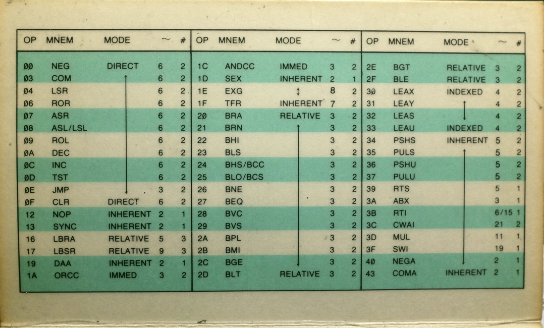

PS: Real men program in Assembler 😀
I get the tongue-in-cheek 🙂 But...
No, they don't. As one who has programmed a lot of assembler and worked with compiler teams I would not underestimate a good compiler.
Mogens
That's how I started: reading hex hex code form a instruction maps and typing them on a Teletex. See one of these maps below (Motorola MC6809). Perhaps old geezers under us still remember those good old days. 🙂Or Machine Language😎
Cheers, E.
