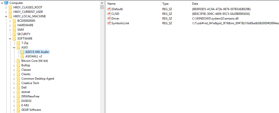

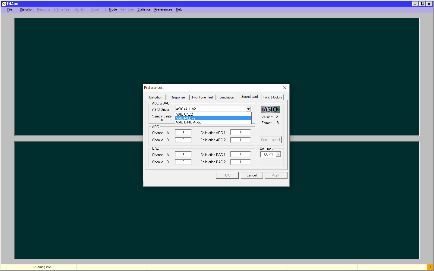

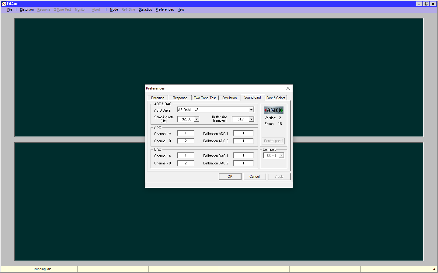

@Edmond
I deleted the ini file and started again. The error message at start still occurs and here are some screen shots for the rest including the only ASIO drivers on my machine.
Hi Edmond,
The error message is before selecting a driver. It's there at start up.
Nothing happens after selecting a driver. That part works fine.
I updated the previous post with my register entries. Only two driver are there and DiAna is showing three. This area of the registry is were we are supposed to be getting our ASIO driver list from and CLSID.
https://www.google.ca/url?sa=t&rct=...entries.html&usg=AOvVaw3qJud6URVNAjdCIg2Vjtgu
Having three drivers listed in DiAna suggests DiAna is getting the info from some other area of the registry.

Now we are getting somewhere, but also something weird is going on:
>"Having three drivers listed in DiAna suggests DiAna is getting the info from some other area of the registry."
The only entry where DiAna looks for driver names is: HKEY_LOCAL_MACHINE -> Software -> ASIO (in C: RegOpenKey( HKEY_LOCAL_MACHINE, "software\\asio", &key ); ), in the same way as prescribed in the ASIO SDK.
So the big question is: where does the 3rd driver name, ASIO UAC2, come from?
What about a search on ASIO UAC2 in the registry? Maybe the entry or location of this fake driver will gives us a clue.

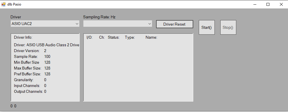

Edmond you are right it is the ASIO UAC2 diver. I removed the driverabout a year ago. I was using it to test the ASIO software I was working on at the time. It does exist in other areas of the registry. I manually removed it from the said directory.
This machine has gone through a number of win10 updates since then. So it is possible win10 is messing with DiAna if MS changed something in the handling API.
A search found WOW6432NODE/ASIO but this is an uninstall entry.
Driver info is spread all through the registry. never just in one place.
Might there be a hidden entry in the registry? Can't imagine why.
