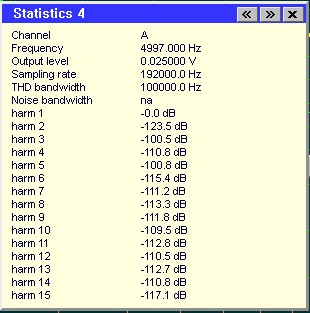

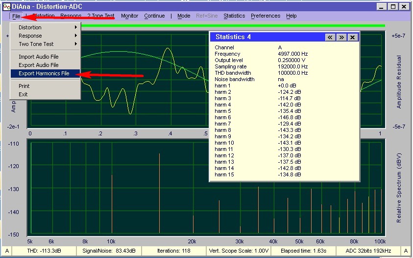

Harmonics export file
Prefer simple numeric values or DB scale than Log values - can be confusing to many users not using maths so much
Something like this will be preferable
0.006% or -105 dB
Okay. In that case dB's will be used when a logarithmic scale was chosen, but I will keep the scientific notation when a linear scale was selected.
>"can be confusing to many users not using maths so much" Do you really believe that? 🙄
Cheers, E.
export
How about this: (whether dB's are dBV or dBFS depends on the calibration)
Cheers, E.

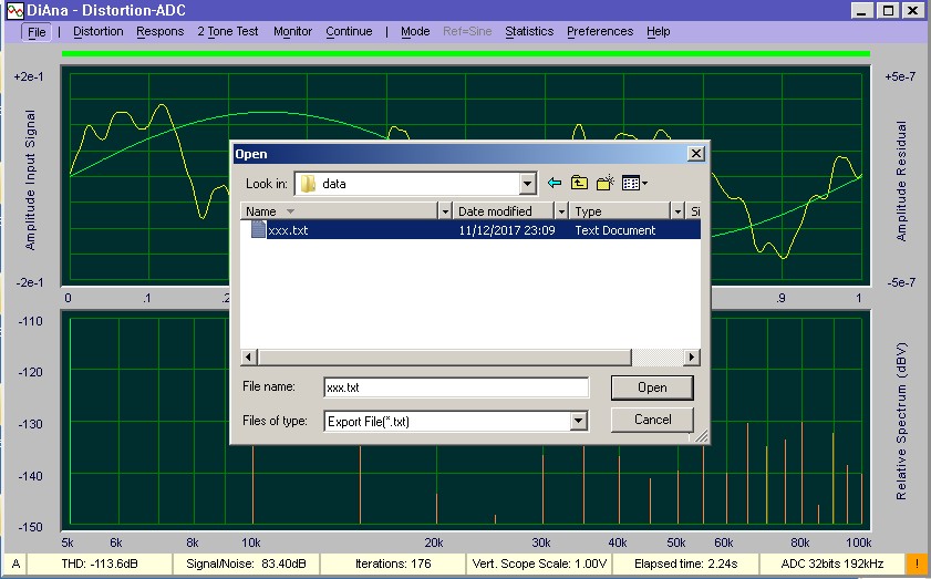

I was thinking more on the sort of universal way the likes of AP and dScope, as well as, I believe ARTA and others do it.
They offer the option to export (as well as import) data as 'comma-separated values' (or using another separator like a period or a tab).
This appears to be a universal method to export data in its original, non-processed form to allow external processing. It also allows importing similar files to put them into a graph for comparison with current data.

To all,
Thank you for your input. For the moment I stick with the format as outlined in post 146. Regarding file import, I will implement that later, as some bug repair is more urgent. The delimiter of the CSV export file is a comma (hex CD), but it can be altered in the ini file under the parameter "DSVdelimiter". If you opt for the "=" character for example, set DSVdelimiter=3D. Use hex values, as some characters are non printable. The new file has been uploaded on my website and has version number: 1.46.8. Please disable, or even better throw away, MS Security Essentials, as this stupid virus scanner deletes my program. Strange enough, MS Defender has no issues with my program.
