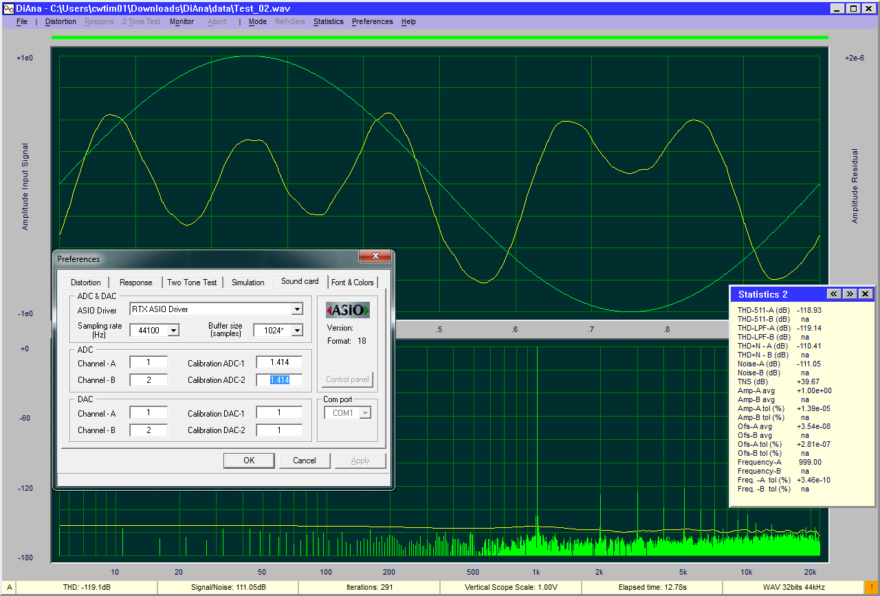

I'm still confused about the calibration though. I choose 0dBV out and 0dBV in at the RTX, and my DMM has confirmed that at this setting 0dBFS equals 1Vrms, so I set "Calibration ADC-1/2" to 1.414 (as shown in the screen capture).
However, under this setting, I'll have to set "Output level (Vp)" under Preference->Distortion to be less than 0.707, or else the input becomes over range and end up with very high distortion.

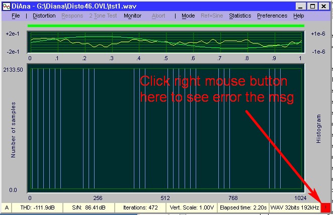

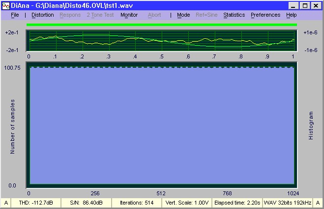

Let me explain how averaging works and why "sample rate is whole multiple of frequency"should be avoided.
Input samples are mapped into a fixed interval, ranging from 0 to 2pi (by means of modulo 2pi arithmetic).
In order to make this stream of data manageable, this interval is subdivided in 1024 bins (actually an array 1024 x 80 bits) and each sample, after the fundamental has been subtracted (leaving only the residual), is accumulated in one of these bins. Clearly, the phase of the samples could have any value between 0 and 2pi, but they are categorized in limited number (1024) of discrete values, giving rise to a sort of round off errors. How to deal with that will be discussed later on.
After all data are collected, the residual is normalized by dividing the content of each bin by the numbers of samples stored in it. Bins might be empty, in which case these gaps are filled by means of interpolation, to be more precisely, by means of a periodic cubic spline.
Gaps arise when the sampling frequency (fs) is a whole and relative small multiple of the signal frequency (fi), e.g. 192kHz respectively 4kHz. They seldom give rise to problems, but it is better to avoid them anyhow. In such case one should choose something like 3.999kHz or 4.001kHz.
To what extent the bins are filled with data can be checked by selecting the Histogram (in the lower window). The first picture shows the histogram obtained with 4.001kHz, all bins are filled, which is okay.
The second picture is obtained with 4.000kHz, that is not okay, as the bins are sparsely filled. Also note the small square in the lower left corner. The red color signals an error condition. Click on it to see the error msg, in this case: "Too many gaps", i.e. too many bins with no data, which ultimately leads to an ill defined residual. BTW, depending on the sparsity and distribution, this is not always catastrophic.
Cheers, E.
As for the DAC, 0.707 is correct, being the reciprocal value of 1.414. This is also explained in post #55. Nevertheless, I see it leads to confusion. So should I change the program, so that for the ADC as well as ADC the same calibration factor can be used? Please vote on this matter everyone who uses DiAna.
The exact full scale input and output voltages are conveniently displaced at the front panel.
I use 0dBV (1Vrms) output and 0dBV input for my test.
Assuming that this figure is indeed the full scale value, then set the ADC calibration to 1.414. If the I/O level on RTX is set to another value, needless to say that calibration factors in DiAna have to be adjusted accordingly.
Cheers, E.
