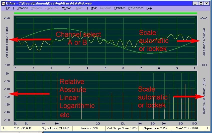

Right click to the Y axis (left) for the switch between Relative Spectrum and Absolute Spectrum.

Click with the right mouse button on the lower left border.Thanks, I can get the spectrum and residual graphs now 🙂
BTW, how can I switch between Relative Spectrum and Absolute Spectrum (I notice it can be done from lemon's screenshot before)?
