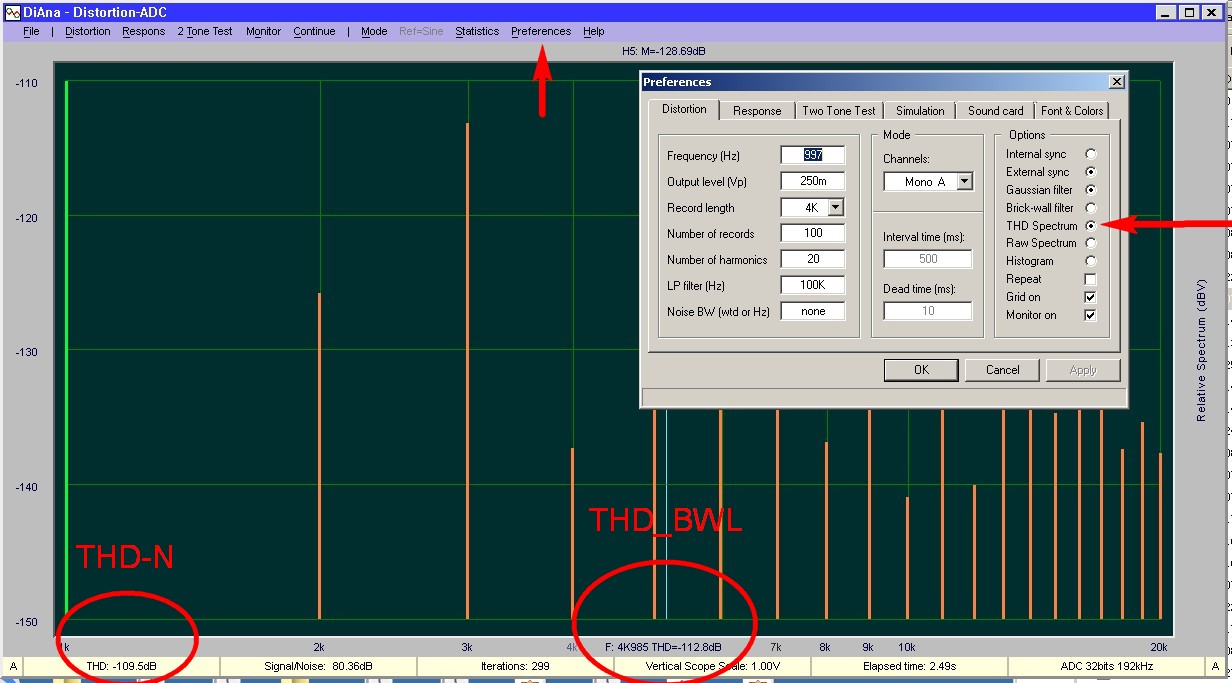

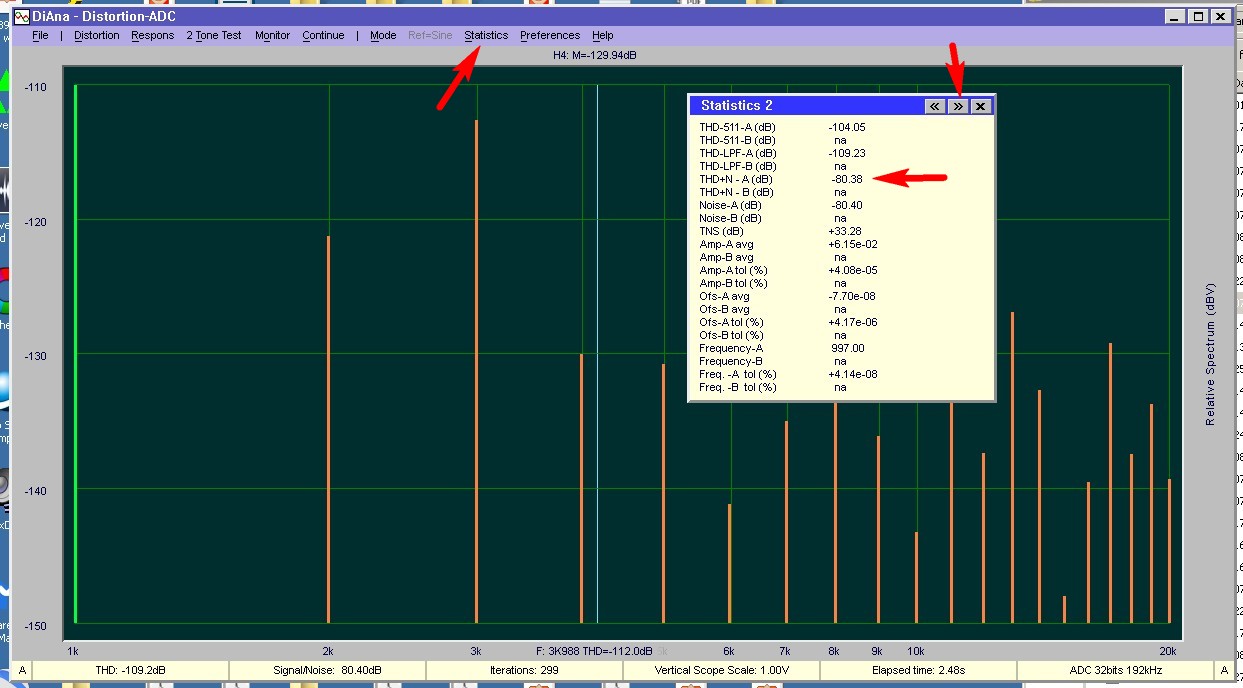

"THD+N"? Now we're down to business, finally. 😉
Look at the 2nd page of Statistics where you can find THD+N. See the 1st picture, where the arrow tells you how to get there.
Hey, WTF, the upper window is vanished ! That's right. You can move the so called middle bar up and down with the cursor. In this case it's moved to the top.
Back to THD, as there are more variants: THD-N and THD_BWL
First, select THD-Spectrum in the preference menu to get the spectrum of exclusively the harmonics (remember, DiAna is a distortion analyzer, not just a spectrum analyser)
In the lower left corner of the 2nd picture you see THD-N (without noise) and below the cursor (a thin cross-hair) you see the THD_BWL (bandwidth limited), that is, the sum of all harmonics left to the cursor.
There are more kinds of spectra, which you can select either from preference menu or, more easily and more choice, by clicking on the lower window with the right mouse button.
BTW, If you click on the upper window, you will get the preference menu. Note that there are six other regions who will respond to the right mouse button. Please, just try it out by yourself and have fun.

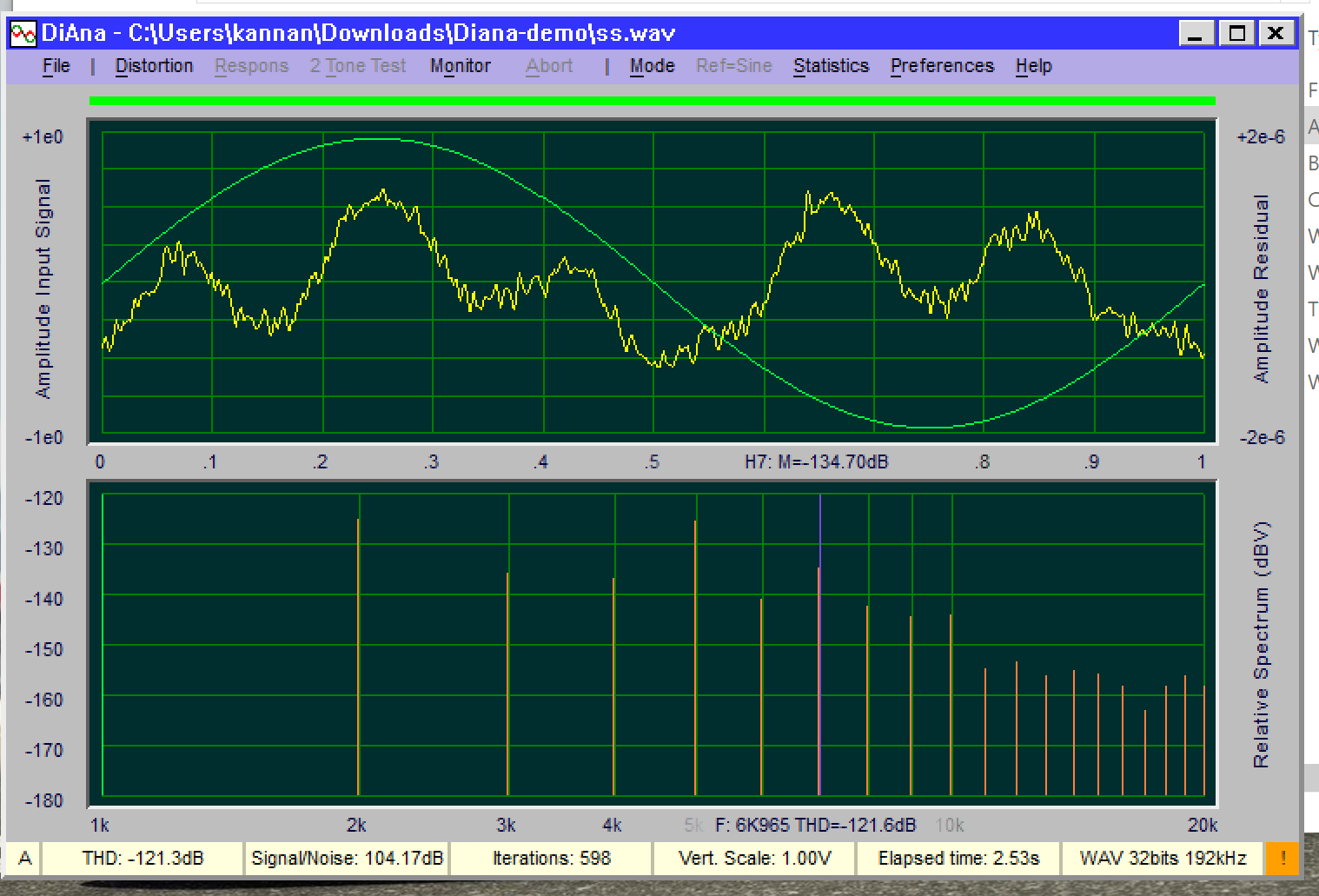

I figured out these already as it is working - after setting AsioBufLen=512 in the ini file ( manually editing it!)
I assume these steps are correct?
1. Set Mode to Write to File after setting the preference
2. Click ' Distortion 'button to write ? ( this where you can make a changes to the user interface for easy understanding )
3. Set the Mode to read from file.
4 Click "Distortion" button again to read the file to display the Distortion ?
This is what had done so far

The steps as described above are almost correct: certain modifications should be made before you write to file, i.e. between step 1 and step 2, and should be done in the preference distortion menu, where you can specify frequency, amplitude, record length, number of records and mono/stereo (the other parameters may also be modified now or after step 4). and then click on the distortion button again.
After this step, i.e. the actual analysis, you can still modify the "other" parameters, i.e filter type, bandwidth, kind of spectrum, etc.
"Peak or RMS" It's peak, not peak to peak or RMS. But as already remarked elsewhere, without calibration (i.e. all calibration factors are still set to 1) the numbers don't represent to the actual (peak) voltage, rather relates to the peak voltage the DAC can maximally output, respectively the ADC can maximally accept (without being overdriven) . Let me give an example: If the output level (Vp) in the preference menu is set to 250m, then the output voltage of the DAC will 0.25 x full scale voltage. How much that is, depends on the DAC and if not specified by the vendor, it should be measured with an accurate voltmeter. Most of the time the full scale output level is specified in dB, How to translate that to volts is a story in its own right, as there tens of different kinds of dB's (more on this later).
But back to the startup issues. Do I understand correctly DiAna works after you have changed the ini file manually? If so, does it mean that if I can manage that the BufLen parameter will be set correctly by DiAna itself, the program really works? Is that correct?

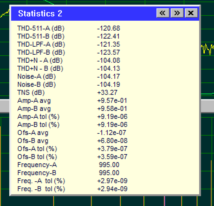

attached is the RTX6001 . needs still calibration etc but a good start
values in statistics shown

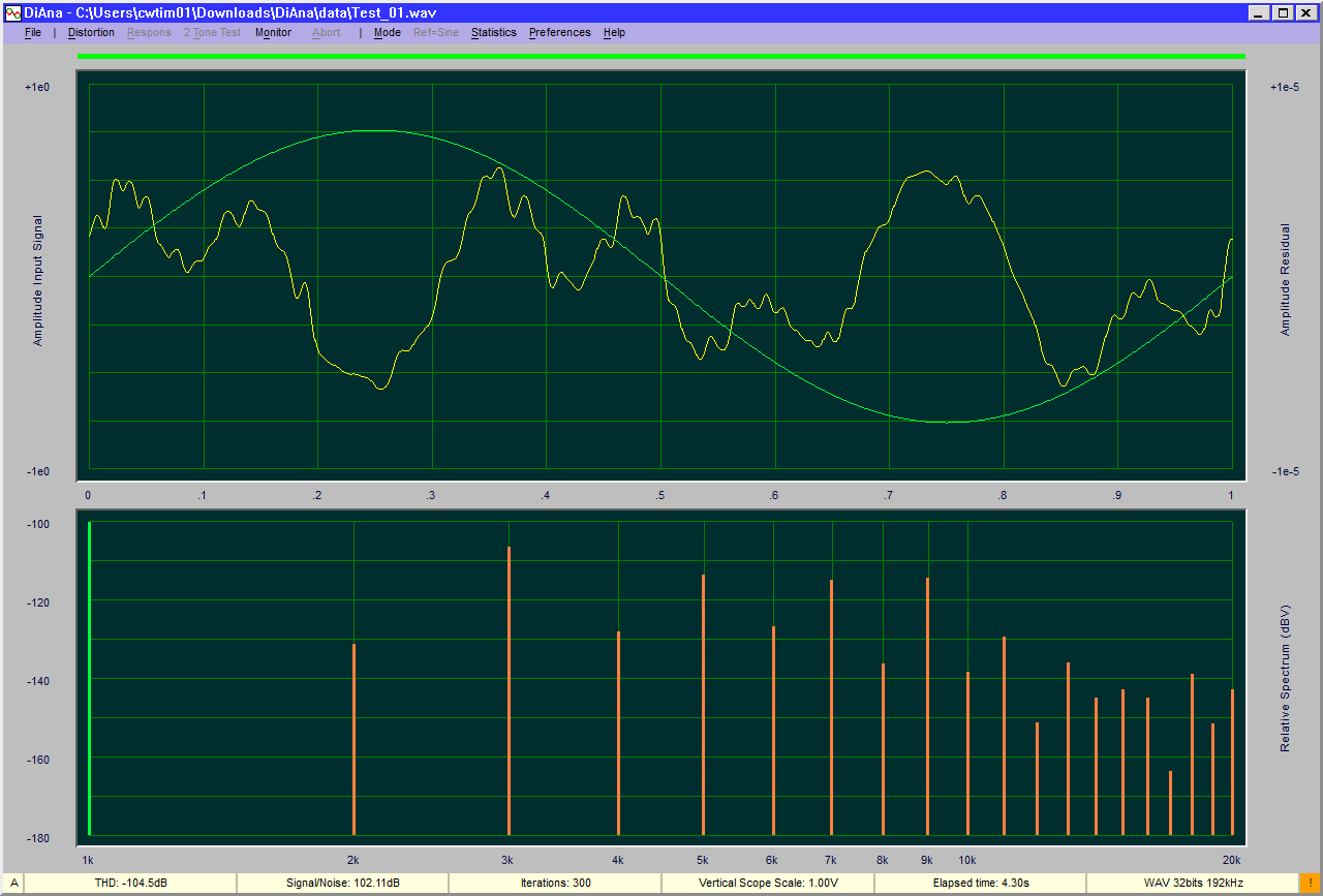

Thanks, I can get the spectrum and residual graphs now 🙂Please see post 70 and 71.
BTW, how can I switch between Relative Spectrum and Absolute Spectrum (I notice it can be done from lemon's screenshot before)?
