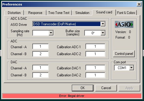

It is nothing to do with DiAna, this driver is useful to foobar player for SuperAudio CD or DSD files playing.
For some kind of reason, the DiAna sees this driver in starting and not the EMU asio driver and gives error.
Never mind, the program works fine...don't worry, perhaps something goes wrong with registry of OS.
In that case I will block/skip the DSD transcoder driver by a check on the first three characters (i.e. DSD).
As already told, on my PC the program hangs when selecting this driver, that is, under Windows 7. Under Windows 10, it doesn't hang. So I wonder which OS are you using?

Illegal driver
In the next release (not yet uploaded) you will see this error msg. Okay?
Cheers, E.
XP-Pro 32bit...
Yes, it is OK...

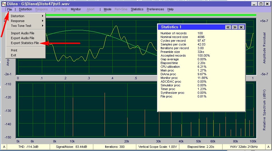

Hi Manolis and kannan,
A new file has been uploaded with version nr 1.46.9
Although the DSD transcoder driver can still be seen, it can't be loaded any more. Hope this helps.
All 'statistics' pages can now be exported. How? See pic.
How about TAB characters in the export file (to let it look nicer). Are they allowed or should I do it with spaces in order to align the variables?
Cheers, E.

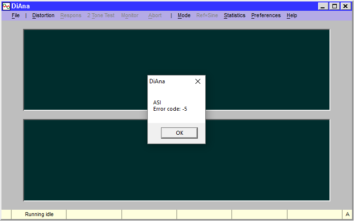

Hi Edmond,
I get this message upon opening DiAna.
I get break up recording at 192k and it doesn't seem to record or playback anything. It does work with 48k or less but still no response to playing back the file. I just get a flat line on the upper pane. Everything was working at or below 48k with prior versions. I hadn't check it at 192k with prior versions.
The break up might just be the EMU driver. I get this with the EMU and ARTA as well. Not sure what the issue is.
Edit: Just tried the .wav file with another player. It is recorded at 0Vrms level or digital silence if you like.
