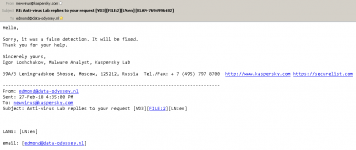

PS: The new version triggers a few more false positives on virustotal.com. I get totally mad at those silly "random generators" Happily, virusscan.jotti.org reports no viruses at all.

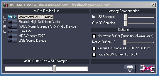

Edmond, I saw today that the asio4all works with DiAna, but you need to setup the input-output configuration outside from DiAna.

Hi Manolis,
If I understand you correctly, you couldn't access the asio4all control panel (from outside) when in "write to file" mode. Right? Well, I have to admit, that is an "unintentional omission", which I've corrected by now (version 1.48.4). The asio4all control panel can be accessed via the asio4all icon in the system tray. Now, this icon (see pic) will appear when switched from "Full duplex" to "Write to file" mode or vice versa.

NB: After the tiny modification of the program, virustotal reported 13 out of 68 PUP's. Again, these are all false positives, of course. Apparently, these AV scanners "infect" themselves with the exchange of erroneous signature data bases. Perhaps I should report these false positives to those AV companies, but then I have to do this again and again after each modification of the program, I'm afraid.
A new version is available (1.48.5), which -according to jotti- is totally clean.

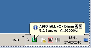

ASIO contrl panel
Hi Manolis,
You could re-enable the ASIO control panel by setting the parameter AcpEnable in the ini file to a nonzero value, but beware of possible issues, see post 39.
Cheers, E.

Hi Manolis,
Cheers, E.
Yes, I had forgotten this. Thnx!

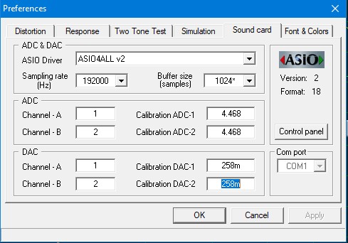

At the last, I would like to give an example with real DUT like dac that today tested and DiAna calibration procedure.
If I set the ADC input of RTX at 10dBV or 3.16Vrms (FS) then I must set in the Diana Preferences ADC area 3.16*1.414= 4.468 (Vp)
If the FS output of DAC in 200K input impedance (RTX input Impedance) is 2.74Vrms or 3.87Vp, then the the right value on Diana DAC output will be 1/3.87 = 0.258
Am I right?

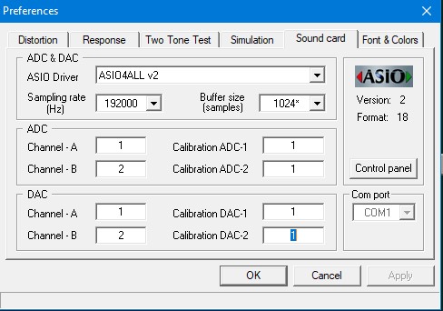

With 250m gen output I had the above results
But if I reset all the values to the initial default, then the results will be much better.

That's correct.At the last, I would like to give an example with real DUT like dac that today tested and DiAna calibration procedure.
In the past that would be correct (see post 55), but not any longer. Entering the reciprocal value of amplitude was a source of much confusion, so I've changed that. Now you can enter just the full scale peak voltage of the DAC (and diana takes care of the inversion), see post 116. I should have more clear on this point, my apologies for this.If the FS output of DAC in 200K input impedance (RTX input Impedance) is 2.74Vrms or 3.87Vp, then the the right value on Diana DAC output will be 1/3.87 = 0.258. Am I right?
Most likely because of wrong calibration factors for the DAC. I hope you will get better results with the correct factors.But if I reset all the values to the initial default, then the results will be much better.

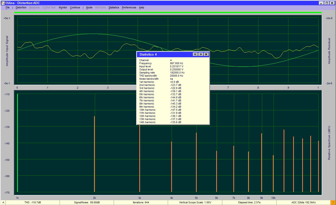

With the right calibration now I am almost 118.5dB.
With twice load DiAna, I select at the 1st with Amanero driver the monitor button but at the 2nd DiAna with RTX driver which button I must to select? I tried first to "write to the file" and then the "read from this file".
Is that the right?
Is that the right?

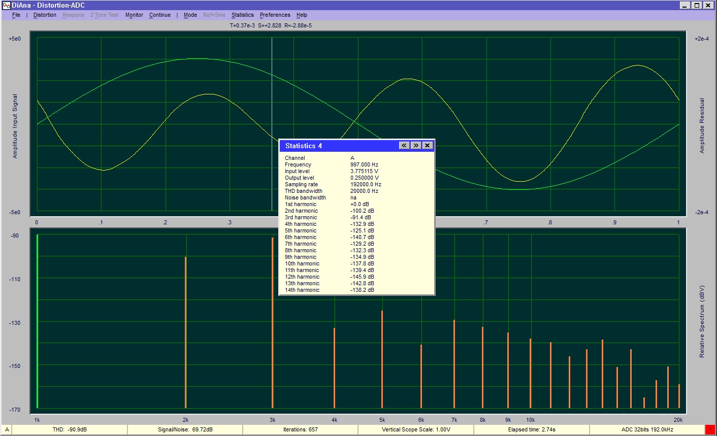

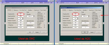

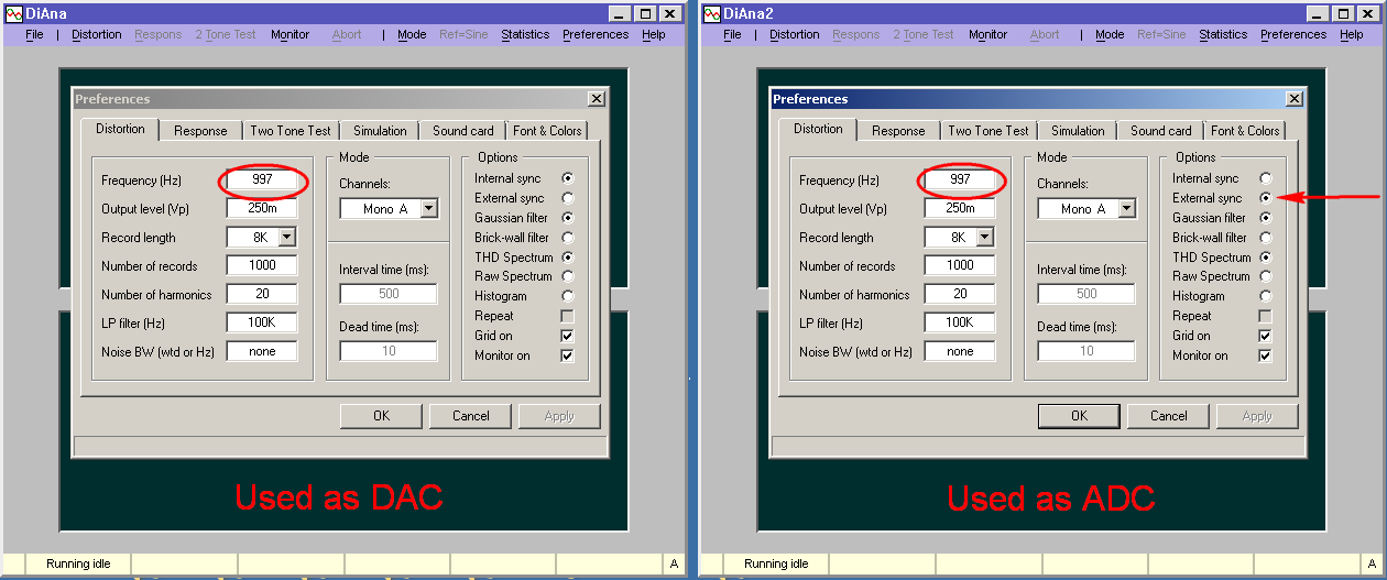

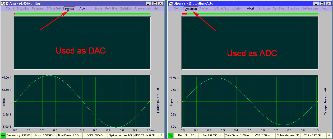

Hi Manolis,

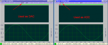

Optionally, in order to observe the signal in the lower pane, make not only a loop-back connection form this DAC to the ADC used by DiAna-2, but also to the ADC of DiAna-1.

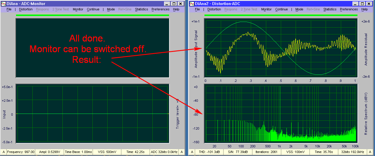

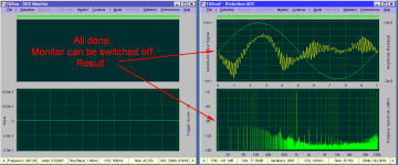

Use Diana-2 for input, also select Full duplex and start the ADC by clicking on the Distortion button. Now, the signal(s) should be visible in the lower pane(s), see pic 3.
When all done, either done by clicking the Abort button of DiAna-2, or when all number of records are processed, you can stop the DAC by clicking the Abort button of DiAna-1, see pic 4.
A few more hints:
Make sure using the same signal frequency for both instances, see pic 2.

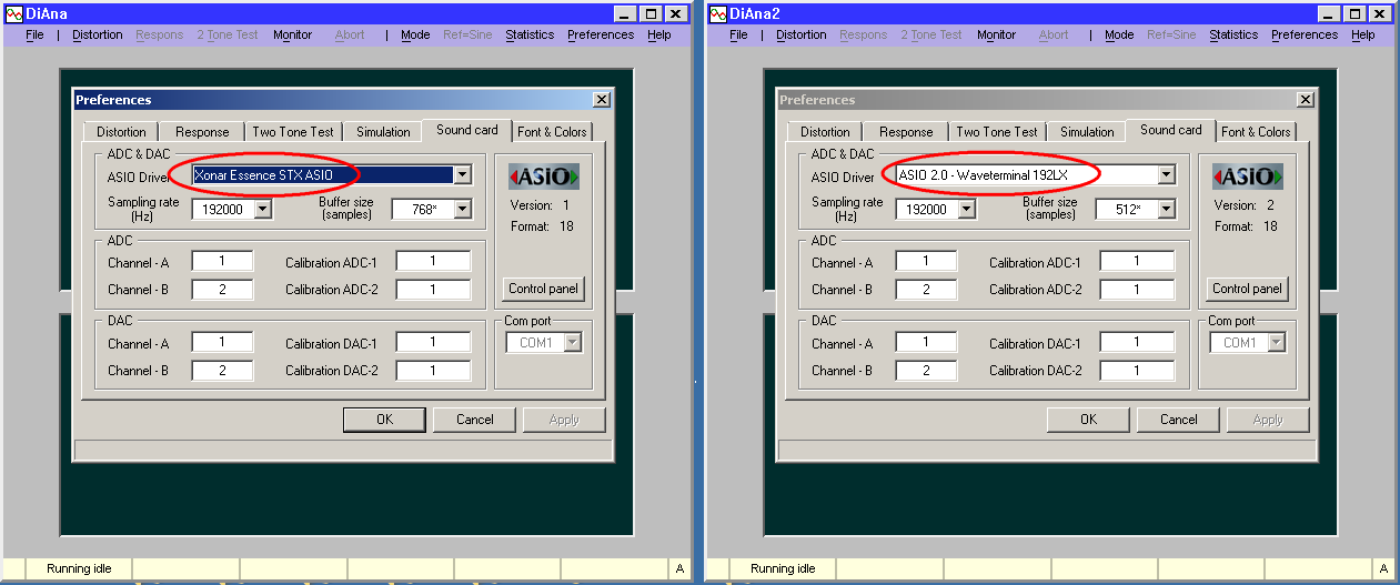

In case of a Xonar Essence STX sound card (definitely not my first choice!), make sure this one is selected and activated by the 1st instance of DiAna. When done, load 2nd instance and select the other sound card, see pic 1. Doing it the other way around might give unpredictable results or even a system hang (courtesy of asus ).
Cheers, E.
That "sounds" much better.Nice information.
Maybe you can do it by swapping the data via disk, but it can be done much simpler. Use DiAna-1 for output, select Full duplex and start the DAC by clicking on the Monitor button.With twice load DiAna, I select at the 1st with Amanero driver the monitor button but at the 2nd DiAna with RTX driver which button I must to select? I tried first to "write to the file" and then the "read from this file".

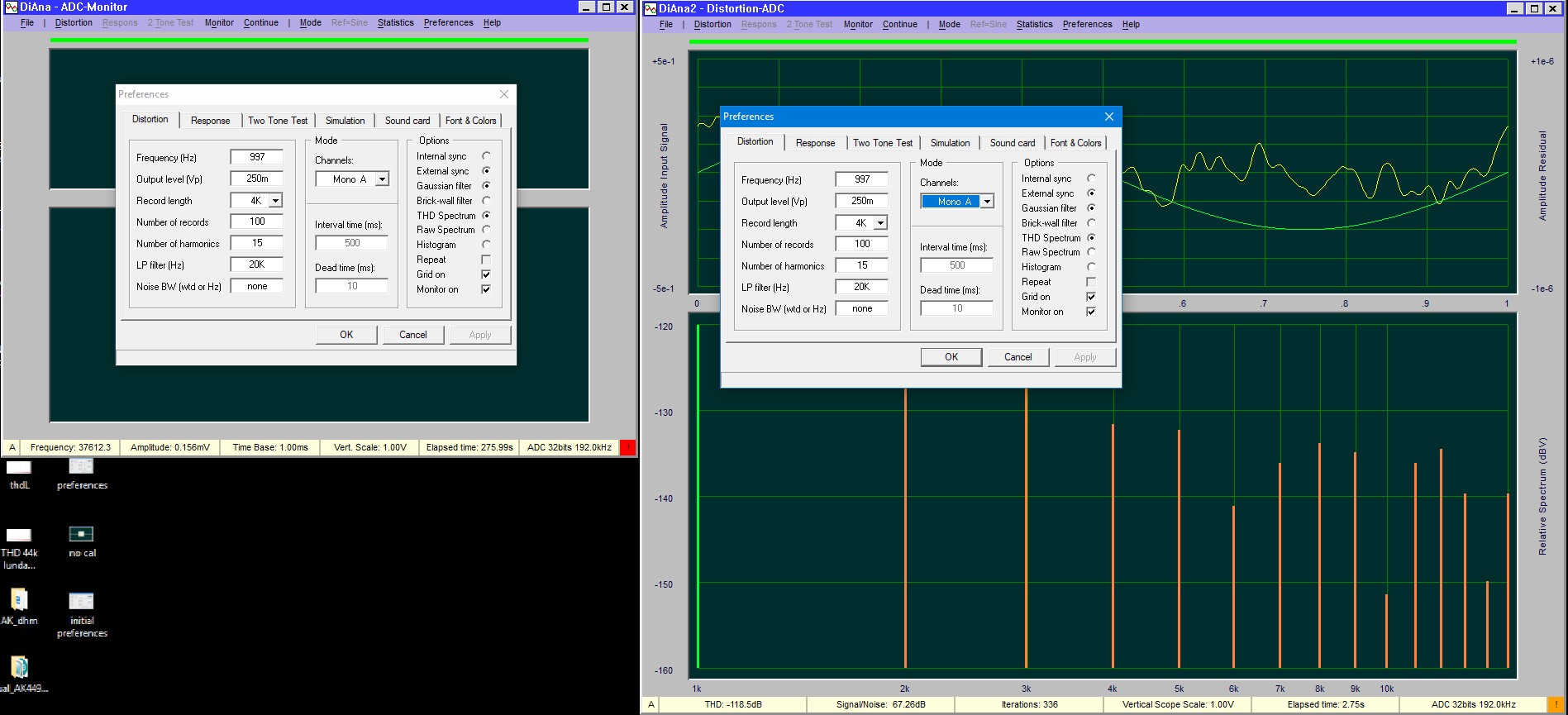

Edmond, you are very kind and I appreciate your time to available to us.
I follow your steps and I have done some measurements with that method (double DiAna).
This is what I have done with the setup in Preferences.
The small DiAna wnd have the Combo384 Asio, this is the asio for the Amanero Usb to i2s card (DAC).
The bigger DiAna2 wnd have the RTX Asio driver, this is the ADC.
Here the same like before but this is Distortion Setup.

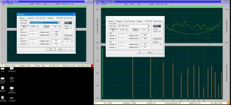

- It is strange, I have select the 997Hz as gen_freq as you see, but the left lower corner at Diana1 shows 37612. This is a bug?
- I pressed the monitor button of the left DiAna and left it to run all the time. In the meanwhile I took measurements (Full Duplex) with the right Diana2, here the results:
infdB
-116.7
-117.3
-116.1
-120.4
-120.3
infdB
-120.3
infdB
-115.7
infdB
-118.5
Is that normal or this is related with the following.
At the right down corner there is indicator with red color.
The values on it are: Dropout error, DAC underrun, Outlier error
What is the meaning of these and how correlated with the THD measurement.

Hi Manolis,
Dropout error: One or more records were not captured or processed in time.
DAC underrun: The sine wave synthesizer was too late to deliver the next record of samples.
Outlier error: The amplitude, offset voltage or frequency deviates too much from the average values. Normally, you will get this error msg. too, as a result of the other two errors.
Cheers, E.
edit: Is you PC fast enough to handle two instances of DiAna? Have a look at " CPU utilization in "Statistics-1" and/or Performance figures of the "Windows Task Manager". Above 50% means troubles, as Windows is not a real time OS.
No, it is not a bug. The frequency you see here is based on what the ADC (of DiAna-1) is receiving. As the amplitude is only 0.156mV, this indicates that the ADC is disconnected. As a result, the program is unable to calculate the frequency and you will get a readout based on noise. To remedy this "bug", simply make a loop-back connecting from the DAC to the ADC (of DiAna-1, of course).Edmond, you are very kind and I appreciate your time to available to us.

This is certainly not normal, especially "infdB". I've never seen this before.- I pressed the monitor button of the left DiAna and left it to run all the time. In the meanwhile I took measurements (Full Duplex) with the right Diana2, here the results:

Now I'm a bit confused, because DiAna-1 is "red", which is normal, as the ADC is apparently disconnected, while DiAna-2 is "orange", which means your PC was also busy with other things (that might be DiAna-1 or something else as well). But if you got these error msg. from DiAna-2, these are serious errors.At the right down corner there is indicator with red color.
Above errors have no large impact on THD figures, as faulty records are simply discarded. But "infdB" indicates that more is wrong, just a bug? On the other hand, the THD spectrum looks quite normal. Perhaps you could put the cursor on the successive spectrum lines to readout the values and compare them with the values of the table in "Statistics 4".and how correlated with the THD measurement.
Cheers, E.
The DiAna runs on Win'10 64 bit with Intel Core2Duo T7400 and 2Gb RAM (probably I upgrade to 4Gb RAM, if the RAM module that I will receive these days plays well).
In reality, some errors like these, there are and with only one DiAna.
The infdB is happening often!
If you see my previous captures with alone DiAna wnd, all of them almost, have a red indicator at the corner!
Edmond, I will prepare a demo about these and upload it.
Hmm.. Not the fastest CPU out there, but it will do, provided that no other task are running (in the background).The DiAna runs on Win'10 64 bit with Intel Core2Duo T7400
DiAna doesn't need that much of memory.and 2Gb RAM (probably I upgrade to 4Gb RAM, if the RAM module that I will receive these days plays well).
Till now, I've don't have an explanation for this weird error.In reality, some errors like these, there are and with only one DiAna.
Could you compare the infdB harmonics with the height of the corresponding spectral lines in the THD plot? As far as I can see, they are okay, so the error must occur in the "statistics-4" routines.
I'm not sure how your version of W10 behaves on your PC, but on my PC it is busy with a lot of rubbish during the first 5 minutes or so after startup. During this time DiAna experiences a lot of dropouts. So I have to wait when W10 stops with "Windows Modules Installer Worker" or "Antimalware Services Executable" etc. Please, also google "Optimising your PC for audio on Windows 10" in order to stop these useless and disrupting background tasks. Also disable (or even better remove) Telemetry and Data Collection by removing CompatTelRunner.exeIf you see my previous captures with alone DiAna wnd, all of them almost, have a red indicator at the corner!
I hope this will help. Good luck.
Cheers, E.
NB: I'm away for one day.
