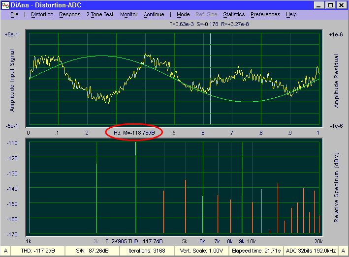

DiAna, a software Distortion Analyzer
Could you compare the infdB harmonics with the height of the corresponding spectral lines in the THD plot? As far as I can see, they are okay, so the error must occur in the "statistics-4" routines....
Yes, they are seem like normal.

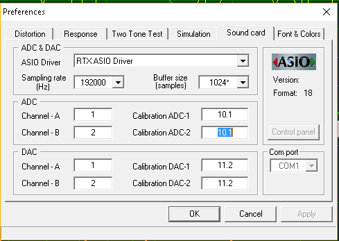

Demian, about the calibration procedure.
The Vrms Victor 994Hz oscillator output X 1.414 to DAC-1/DAC-2 area (DiAna Preferences). If the Victor output was 2.496Vrms, then 3.529
The RTX set input e.g 3.16Vrms X 1.414 = 4.468 to ADC-1/ADC-2 area (DiAna Preferences) and so on to the other knobs settings.

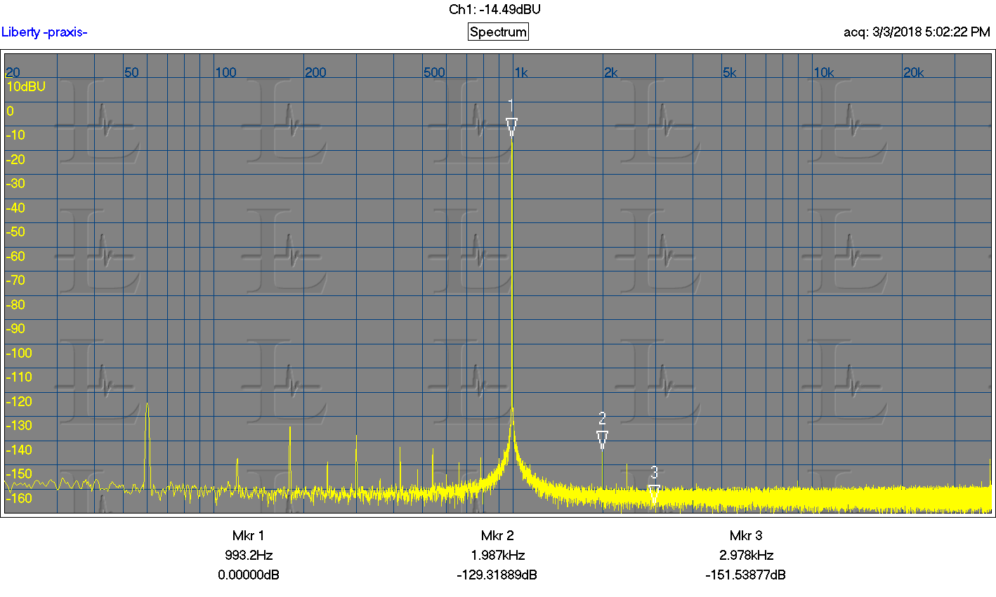

Figured out the measurement problem. Reading through the notes I saw the reference to external sync. I found the selection (right hand side of the distortion menu) and retested. Now the numbers match Praxis.
You also might say: Now the numbers of Praxis match DiAna. 🙂 See below.
That plus the display is really nice.

Regarding the accuracy of the spectra, DiAna also offers two other spectra: a so called raw wideband spectrum with coherent averaging and one without coherent averaging. The are calculated independently from each other, So if the amplitudes of a harmonic in all three spectra are same, you can be pretty sure that the figures are correct.
In addition (in case of doubt), you also might check the accuracy by means of simulation: Set mode to "Simulate data", edit the Simulation page under Preferences to generate some well defined distorted sine and run a Distortion measurement.
Below you see the three possible spectra with the cursor put on the 3rd harmonic. The height (in dB) of this harmonic is in two cases the same, while the 3rd spectrum (a lousy one without coherent averaging) shows a tiny deviation of about 0.1dB.
Cheers, E.
NB: These spectra can be selected with a right mouse click on the lower pane (or -to some extent- in the preference menu).

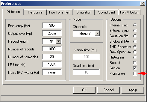

As a last resort, you might try to make DiAna less "hungry" is by disabling the oscilloscope function. That saves about 50% of CPU usage. Uncheck "Monitor on" in the "Preference->Distortion" menu, see pic. Maybe you will get less dropouts.

Edmond, thanks for the info about "Monitor on", I will try tomorrow.
In my situation when the DiAna runs, the dwm consumes until 30% of the CPU!
The two open DiAna is a dream for me with that CPU consumption.
With the one DiAna, the CPU Usage the most times goes to 60-80% and the red indicator light on.
30% for the dwm, 20-30% DiAna and the rest various processes of OS!

With the turn off the "Monitor On", the DiAna drops at the range of 6-15% of CPU Usage.

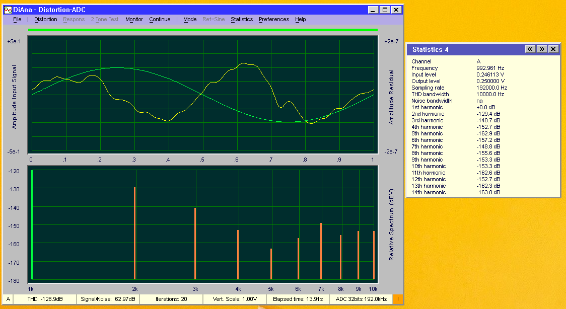

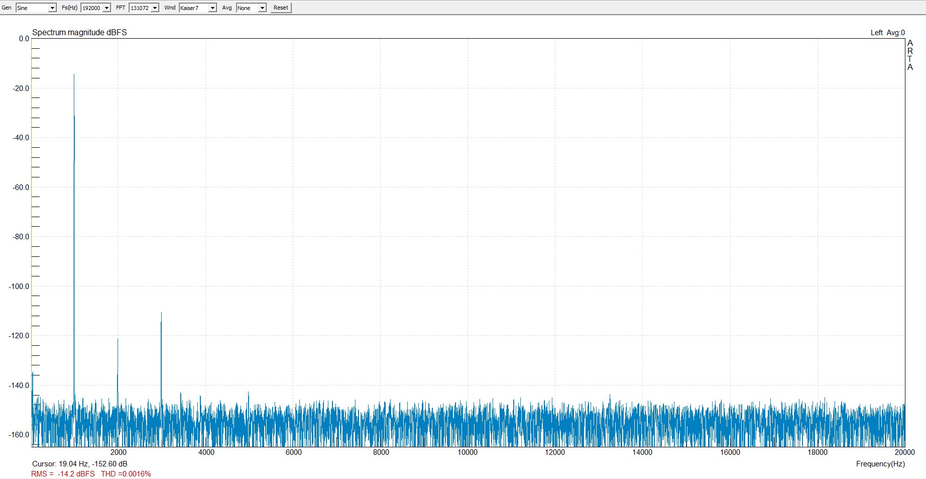

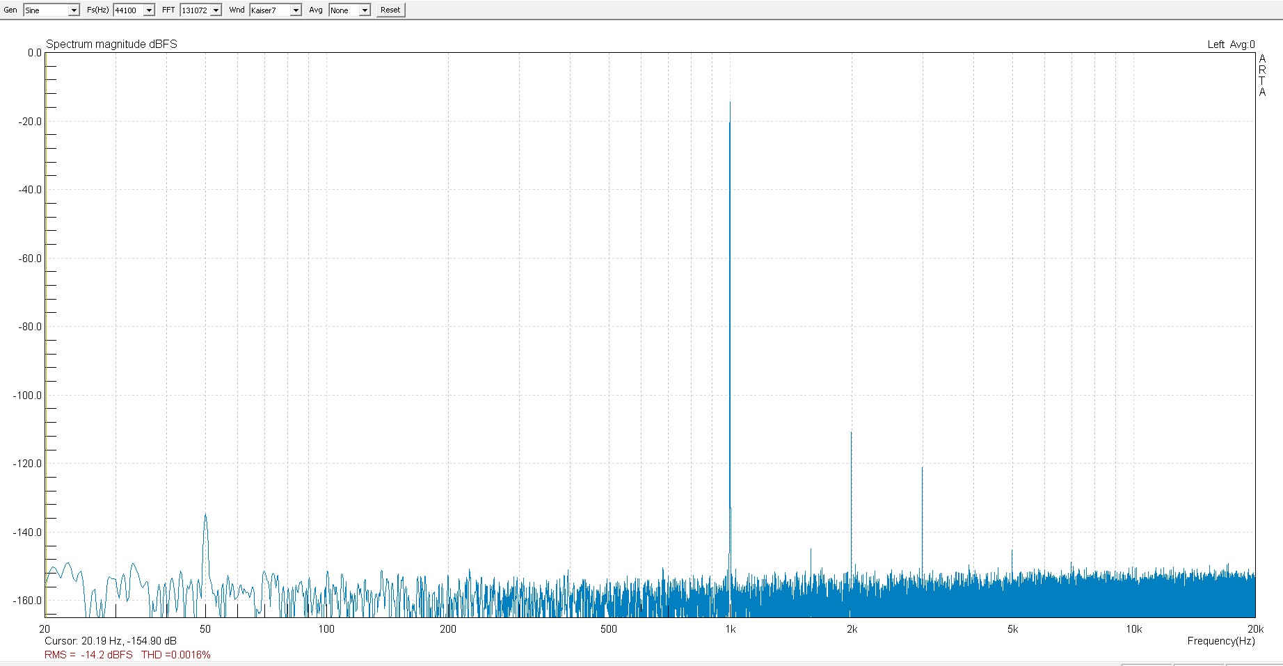

All the FFT that I have (Arta, AudioTester, Rew...) gives a 2nd dominant at THD test (1KHz gen) when I measure a diy dac on AK4490.
The following is from Arta, asio4all with Combo384 ouput (this is Amanero usb->i2s card) and RTX driver as input.
But with the asio4all and same setup (monoA), DiAna gives a 3rd dominant. The same from my lab PC, the same from my laptop.
Is there an explanation about this?

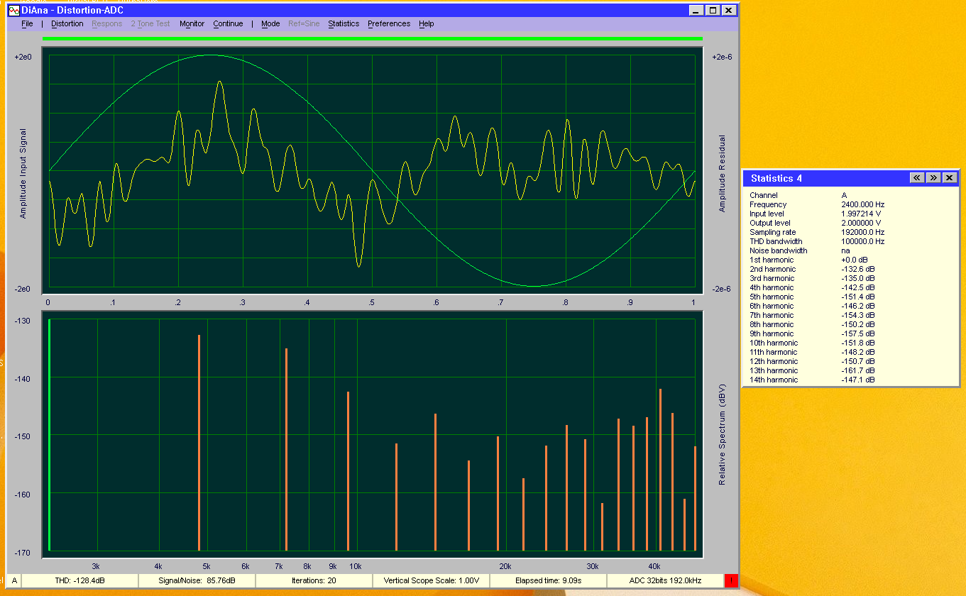

RTX loopback tests at 10V range and 2V levels. (And cal settings to get 10V out and 10V in.)
The performance looks correct to me. At these low distortion levels a small change in level can alter the distortion signature significantly.
I would like a more straightforward calibration method. My preference would be to measure a known signal auto correct the ADC and then use the ADC to measure the DAC in loopback to generate cal factors.
I saw a suggestion for saving different "profiles" I think. I could not find it in any setting however. I use several different soundcards and would like to be able to save settings for different cards and different ranges for the cards.
When the statistics say 2V is that RMS or peak? I think its RMS

Demian, If I remember well, all the values to calibration area are in Vp (peak voltage).
For this reason, I suggested you to put the Vrms values of RTX X 1.414 (see post #364)
Also, I see that you have a red indicator at the right down corner of the software, must to see what happens!
Edmond will be feedback us about this, of course.
Perhaps you overlooked it, but the first measurement was done at a sampling rate of 44.1kHz, whith DiAna however, it was set at 192kHz. Whether this is the only reason for the difference, I'm not sure, but I do know that the sampling rate have a major impact on the distortion signature.
Cheers, E.
... but the first measurement was done at a sampling rate of 44.1kHz, whith DiAna however, it was set at 192kHz. Whether this is the only reason for the difference, I'm not sure, but I do know that the sampling rate have a major impact on the distortion signature.
Cheers, E.
Edmond, you have a "good eye"!
Just I running the Arta with SR to 192K and the results are same 🙂
With a range of 10V -being an rms value- the full scale peak amplitude is 14.14V. You should use the latter value as cal factor.
Sure, I observed that too and with al my sound cards. So this seems to be normal.

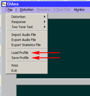

What do you mean by "auto correct the ADC "?
I saw a suggestion for saving different "profiles" I think. I could not find it in any setting however. I use several different sound cards and would like to be able to save settings for different cards and different ranges for the cards.
Of course you couldn't find it, as there are no provisions for that, that is, till now: I have a new version waiting for you, which does have provision to load and save the configuration (=ini) file under different file names (see pic). Should I send it to you?
