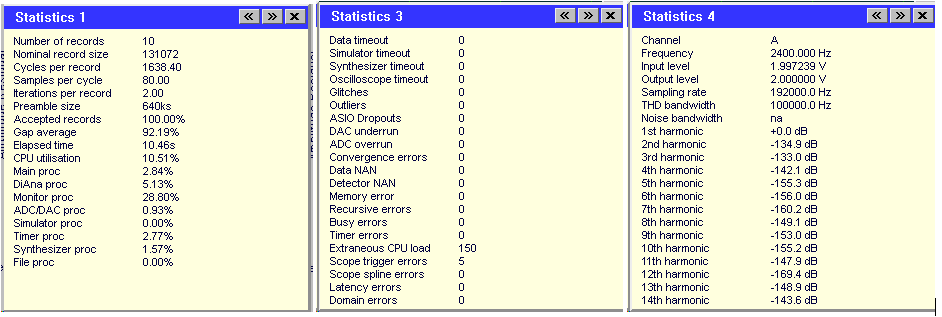

For what its worth I just tried a test from cold start to a finished measurement (with Diana like those above) with the RTX6001 took 1 minute and 47 seconds on a Win 10 system (AMD FX-4350 + SSD). No errors or dropout.

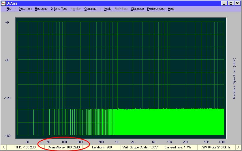

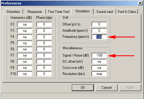

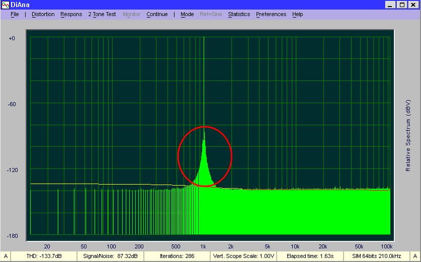

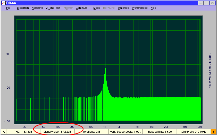

When in simulation mode (done with 64bits precision), noise figures seems to be exact. In this mode, the fundamental is as pure as can be. See pic-1 and pic-2 for setup. Pic-3 shows the noise spectrum without frequency drift and the SNR is 100.02dB, almost exactly equal to the setup value.
Next, I've mimicked some phase noise by setting the frequency drift to 100pp/s (see pic-2) in order to create a "skirt", see pic-4. Guess what? The SNR dropped to 87.32dB. So a skirt has a large impact on the SNR (QED).
Now the big question is: should we exclude this kind of noise from SNR calculation? What do you think, Demian?

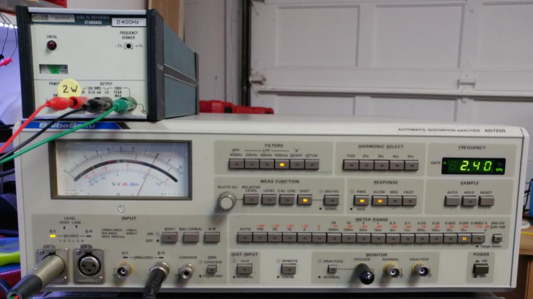

I also get higher noise levels with a Lynx L22 compared to the specs.These are analog measurements of the THD+N with a 100 KHz bandwidth at about -102 dB (or .0008%) and HD2 at about -130 dB. We need to be able to understand significant disdderences and their origins. I believe on the Diana measurement the level was reported at 3.16V or -10 dBFS so some SNR goes away there. However that suggests the noise floor in 100 KHz of the RTX is maybe -81 dB? I don't think that's correct either.
Perhaps it is indeed the skirt that is responsible for the excess of noise. To figure this out, I could suppress the skirt by means of a notch filter tuned at the fundamental.In the past these errors surface as measuring the skirt of the fundamental. Its an analog oscillator so it does have a much wider skirt (phase noise) than a crystal controlled digital oscillator.
BTW, also some simulations support the "skirt theory":I tried this with a digital source and got really close agreement between Diana and the Shibasoku.
Cheers, E.
PS: The new version of DiAna is still not ready to release, as I've still issues with the ASIO control panel. This time in conjunction with Roland Quad and Octa Capture interfaces.

Skirt power
Since a moving average of the noise is already available (see yellow curve), it is probably much easier to determine the excess of noise by calculating the power of "grass" around the fundamental and above the average noise (see red circle). If I subtract this "skirt power" from the total noise power, I hope to get SNR values more in line with the real SNR (that is, without phase noise from the fundamental).
@Demian: Thank you for pointing out that something is wrong (or at least confusing) with the current calculation of the SNR.

2.39kHz is also a sweet spot on that analyzer.
That analyzer was in my possession for a few years.

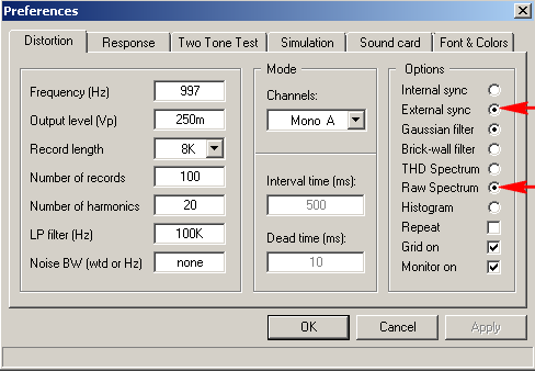

As for the so called Raw Spectrum, the FHT size (pair of bins) is equal to the record length (in your case 128k). This applies to coherent averaging as well as incoherent averaging. In these two cases, the spectrum starts at a frequency of sampling rate / record length (instead of the fundamental).
But in all cases, the fundamental is subtracted form the incoming signal before doing an FHT. During processing of each record, the frequency, amplitude, phase and offset of the fundamental are (out of necessity) held constant, of course. In case of no phase noise, this works fine. But if some phase noise is present, there are only 10 opportunities (in this particular case) to adjust the parameters of fundamental, resulting in side lobes (skirt).
Keeping the total numbers of samples equal, but processing 20 records of 64k instead, there are 20 opportunities to adjust the fundamental. As a result, the side lobes will be smaller (have a try).
BTW, making the record length too small will cause convergence errors*.

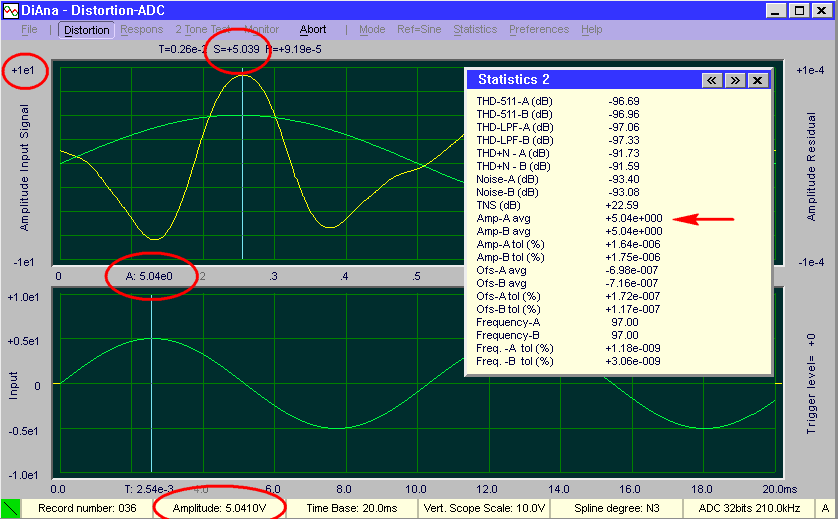

I did change them for proper measurement of a signal. With a 10V input it measures correctly but the waveform is completely off the fixed 1V scale.The scale of the incoming signal (i.e. the green curve) is fixed, unless you change the cal factors.
This is really weird and should never happen. Right now, the only thing I can think of is a corrupted ini file. You might delete it and start all over again.I did change them for proper measurement of a signal. With a 10V input it measures correctly but the waveform is completely off the fixed 1V scale.
As for the "fixed 1V scale", is it always 1V, regardless the input level?
It should be adjusted automatically in steps (1, 2, 5 etc), in the same way as for the residual.
>"With a 10V input it measures correctly" According to what? There are four ways to read out the amplitude, see pic. Are all of them correct? (the two values in the lower pane were obtained during data acquisition, the other two after analysis. I/O levels were 0.5FS and ADC cal fac set to 10)
