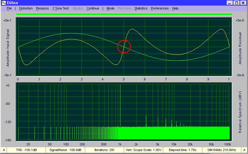

What is the phase relationship between the reconstructed residual waveform and the fundamental Especially higher harmonics.
The phase relationship is undistorted, or at least, it should be. Basically, the residual waveform is not a reconstruction, as it is obtained by subtracting an ideal sine from the input signal directly. So the phase error should be zero. But in a sense, a reconstruction takes place when the residual is filtered, which is done by means of an FHT, followed by an inverse FHT. Filter characteristics can be specified in the Distortion menu under LP Filter (Hz), Gaussian filter and Brick-wall filter.
it can be really useful to determine what part of the cycle is distressed to know where to look.
Sure! And that was one of the main reasons to start this project anyhow. 🙂
Cross-over distortion, for example, is easily detected by means of the residual, see simulated picture below (which also shows a correct phase relationship).
BTW, are SNR figures better now?
Cheers, E.
PS: The phase of the 3rd harmonic is -179.98 degrees, so almost correct. 😉

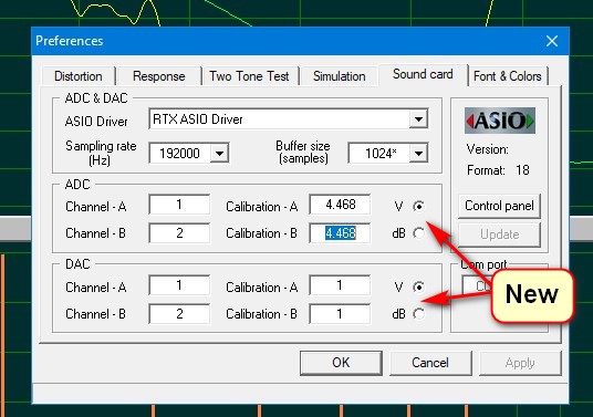

Calibration factor
Hi Edmond,
Just I download the new 1.48.9 version.
I see a new calibration or it is something else?
The V is Vp still or Vrms?
What is relation of "dB"?
Hi Manolis,
At the moment, it's still Vp and the relation is simply dB = 20*log10(Vp).
The only new thing is that you also can enter the cal. factor in dB.
In the next version however, these values will be interpreted as RMS and, to avoid confusion, you will see "Vrms" respectively "dBV" in the menu.
