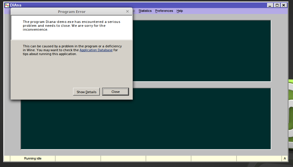

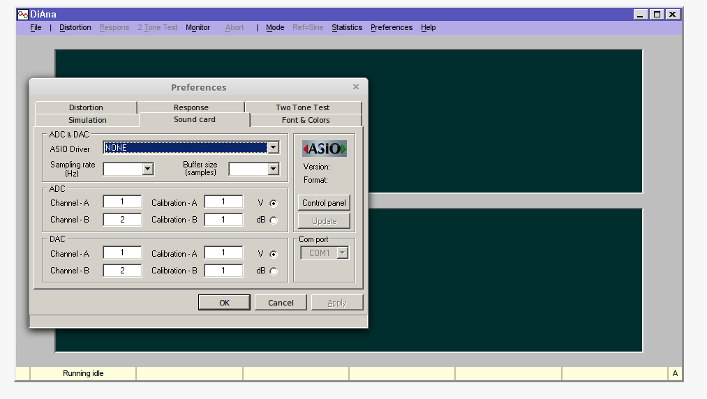

Just, I tried the Diana 1.48.9 with Wine 1.6.2 on Linux Mint (last version)
The first time that the Diana runs, you have the message "erroneous driver number" and something like "the .ini file is corrupted".
Probably, there is no any ASIO and the procedures corrupts the ini file.
Then next time, Diana opens normally, you can click on Preferences and tabs in it, but just to close it...the Diana crashes.
I have enclosed some of these.

Hi Manolis,
So your updated Wine has also issues with the property sheets (just as Kean)
In the meantime I started already to re-write this part of the program. Let's pray this work-around does work.
Thanks for testing.
Cheers, E.
