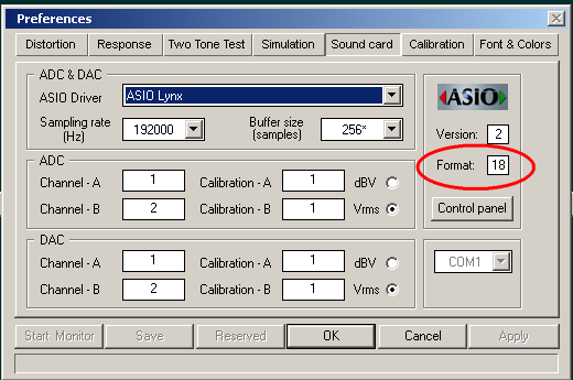

Hi Demian,Edmund-
The ASIO works with Lynx and RME. It doesn't work with EMU or the QuantAsylum. Something about unrecognized ASIO format. I'll capture the details if that will help.
Did you see a format code (see fig.)?
E.

Juli@ sound card
I'm trying to make this work with a Juli@ sound card. Set to default (ADC channel 1/2, DAC channel 1/2), it will use analogue ADC and analogue DAC of the Juli@. This works. ASIO ver 2, type 18. I'm using win7 64bit USA.
However, I want to measure the performance of an external DAC, Juli@ can use channel 3/4 for SPDIF in/out. When I select channel 3/4 for DAC in the preferences, no signal is send over the SPDIF, it's silent. When I stop monitor, it says error code 103 while closing the DAC. If I try a few times, everything hangs.
I think this might be caused by ASIO being forced to do 32 bits, which SPDIF cannot do.
The same setup (ADC channel 1/2 and DAC channel 3/4) does work in ARTA.
What can I try next?
Hi Rob,
As I don't have a Juli@ sound card, I can't reproduce this error and can't offer a solution. But you might try to redirect the data stream via ASIO4ALL.
You got error code 103 because ASIO was apparently not opened. In that case DiAna couldn't close it (of course), hence the error msg.
Cheers, E.

SPDIF issue
Hi Rob,
Please check the following parameters in the ini file:
CurInputChannels
CurOutputChannels
If set to 2, change it to 4. If this solves the error I will update DiAna accordingly.
E.
Hi Rob,
CurInputChannels
CurOutputChannels
E.
You have to support packed 24bit to use SPDIF.
