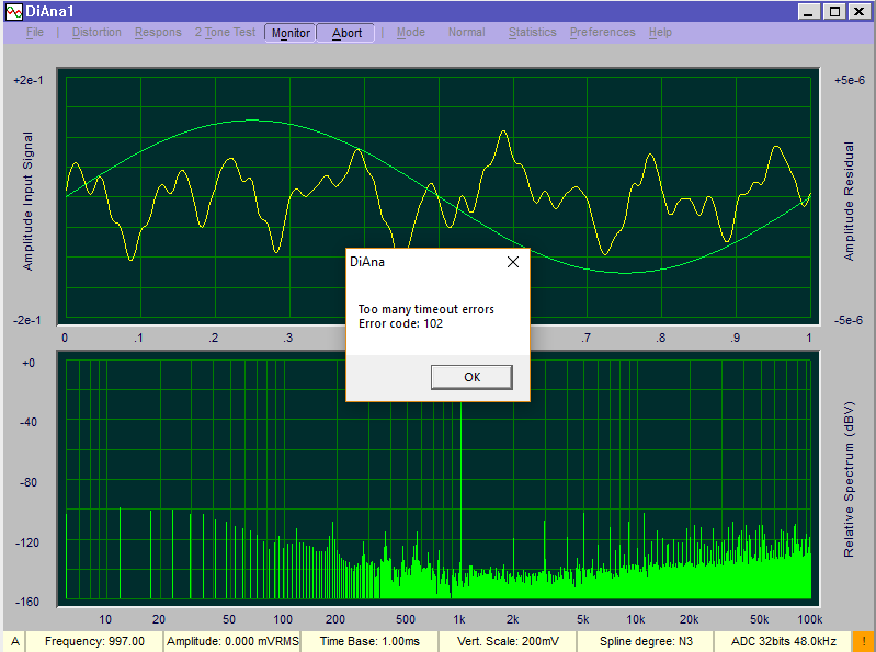

That wasn't the case. However, you also get this error message if the sound interface didn't process any data.

You got error code 103 because ASIO was apparently not opened. In that case DiAna couldn't close it (of course), hence the error msg.
E.

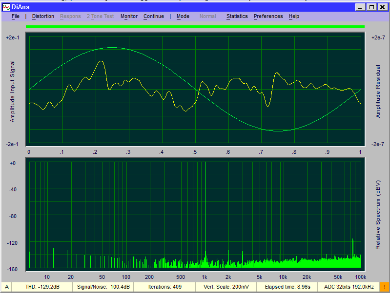

New version

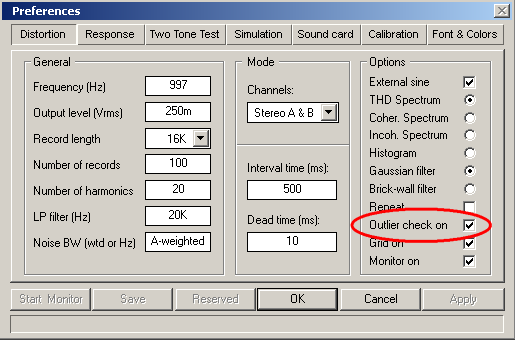

A new version of DiAna is available (V1.51.9). Internally, a lot has been changed and two minor bugs repaired. Externally, only two extra items are visible: A popup menu to select the interpolation method for the monitor (fig. 1) and a check mark (fig. 2) to disable the outlier and glitch test, which enables to process 'difficult' (noisy) data. The SPDIF issues reported by Rob have also been addressed.

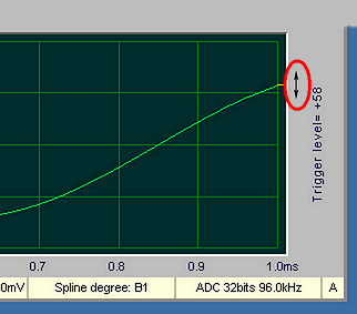

And lastly, here is one of the easily overlooked features: When the monitor is running, you can adjust the trigger level by moving the mouse (left button down) inside the lower left or right gray border (fig. 3).
Cheers, E.
NB: The interpolation method can also be selected by using the page-up and page-down keys, that is, when the cursor is positioned on the lower pane. In order to clearly see the differences, select a pretty high frequency: about 1/4 of the sampling rate.
Cheers, E.

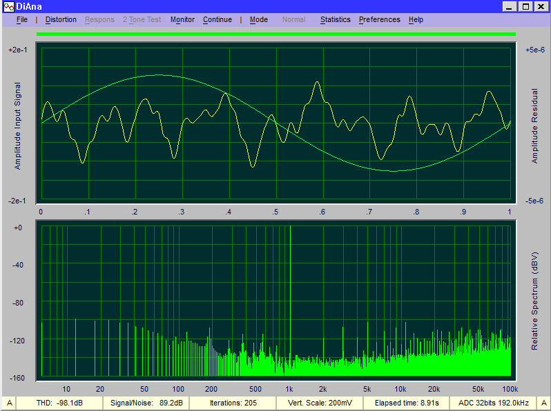

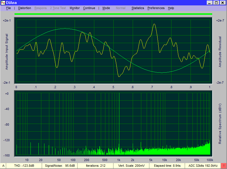

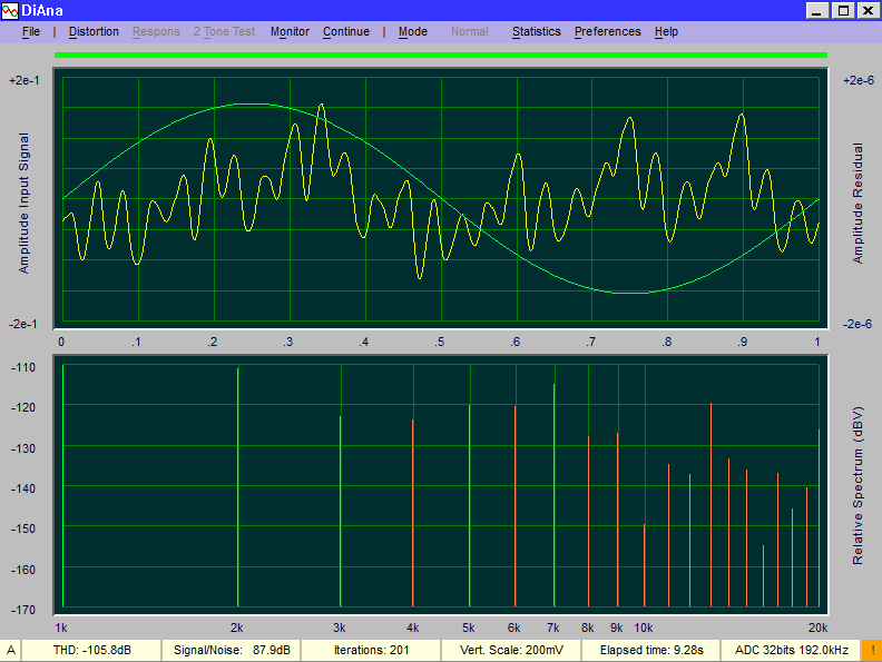

A quick test with the latest version.
The RTX as usual is exceptional on this test.
The EMU needs a little patience to setup. it has the most complex control panel, being a mini DAW.
The Hammerfal is quite goos even though its converters are a step down

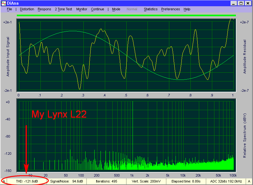

I could not get the Lynx to work. I think it was working earlier. Seems to be an ASIO problem on the Lynx side.

Your Lynx is better. 😉Lynx loopback after a restart which seemed to fix the ASIO issue.
