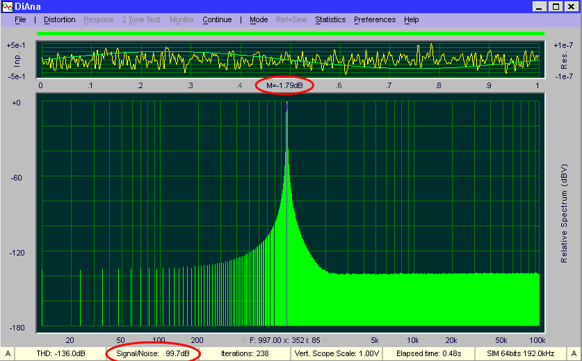

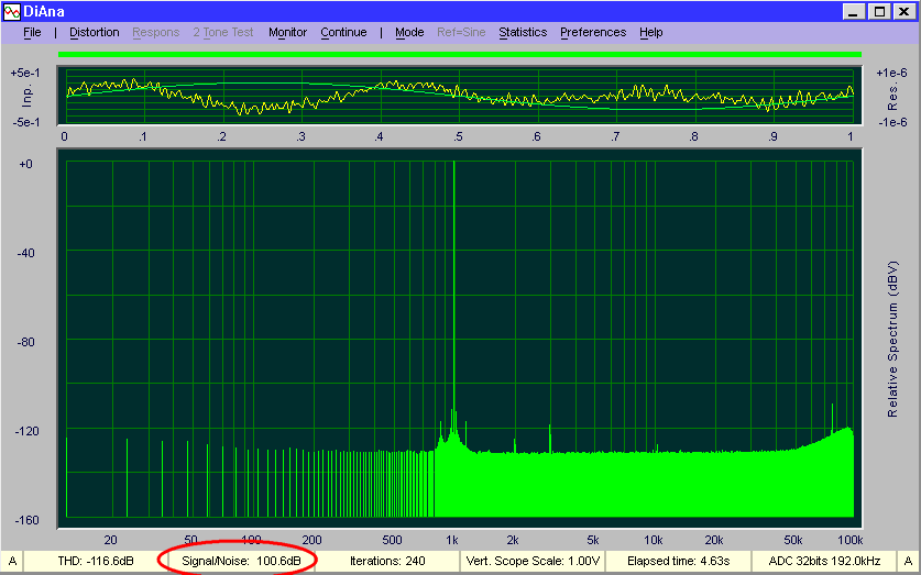

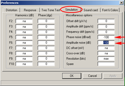

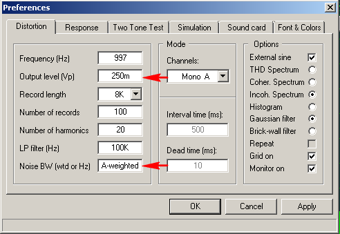

Hi Demian,
The horizontal scale (time base) and vertical scale (gain) are easily adjusted with the left or right cursor keys, respectively with the up or down cursor keys. Note: This only works if the mouse cursor has been moved to the lower pane first.
As for the ACP, a new button -update- has been added (see 1st pic). This button becomes active after launching the ACP or when the ACP is closed again (depending on the actual implementation of the ACP, as they all behave differently!). After clicking on this button and settings have changed, the apply button becomes active, click on the apply button to save the new settings.

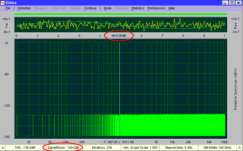

As for the calculation of the SNR, a different route has been followed: First, a moving average is constructed in such way to differentiate between meaningful spectral lines (e.g. harmonics) and just noise. Then, only the "noise bins", that is, the spectral lines below the moving average, are integrated except in the region around the fundamental frequency (f0), which might contain phase noise components. This region is (currently) defined as 0.5 * f0 to 1.5 * f0. The power of these "fundamental bins" is skipped and replaced by the mean power value of the moving average.
A simulate test shows very favorable results. See pic-2 for setup, pic-3 for the uncleaned raw spectrum and pic-4 for the cleaned-up spectrum: exactly 100.0dB SNR, just as specified in the menu (btw, how to get an uncleaned spectrum I will tell another time).
Also the SNR of the Lynx L22 is finally well in accordance with the specs, see pic-6. Note that the Distortion menu is altered: the "radio buttons" internal sync and external sync are replaced by a single check box: external sine. Also note that the A-weighted noise bandwidth (simply type a or b or c), see pic-5.

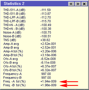

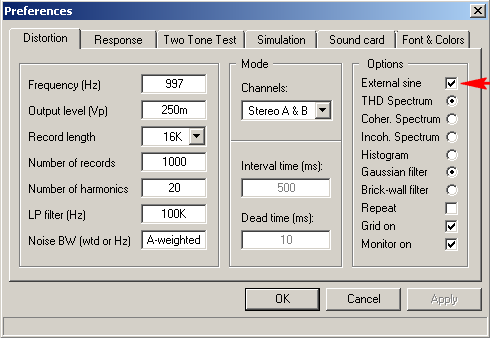

Jitter
Hi Demian,
Yes, it can, provided that the external synchronization is enabled (see pic 1). At the bottom of the statistics-2 page the RMS value of the jitter as a percentage of the nominal frequency is shown (see pic 2). BTW, these figures cover the Lynx L22.
Note that the outcome depends on the Record length (in this case 16k). Also note that in this particular case, where the ADC and DAC share the same clock, the shown jitter figures don't represent the real clock jitter, rather the jitter as a result of amplitude noise (the lower the signal level, the higher the apparent jitter).
Cheers, E.

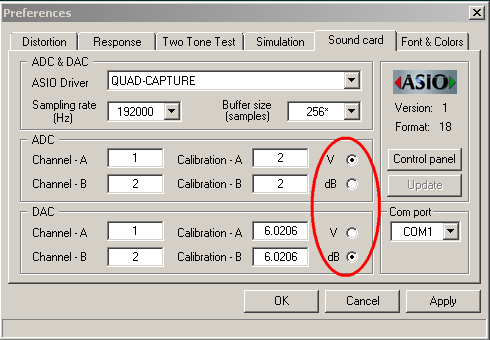

Hi Mogens and all others who are interested,
I've just uploaded version 1.48.9. New features are included as described here.
In addition, cal. values can also be entered in dB, see pic.
After installing a new version, the old ini file is most of the time not valid any longer. In this case, as usual, default parameter are loaded. But in the new version, also the old ini file is deleted automatically, instead of just updated. Nevertheless, it's better to delete the old ini file in advance anyhow. Better safe than sorry.
Good luck.
Cheers, E.
edit: Opposed to previous version, also under W10, DiAna is visible in the so called alt-tab list.
