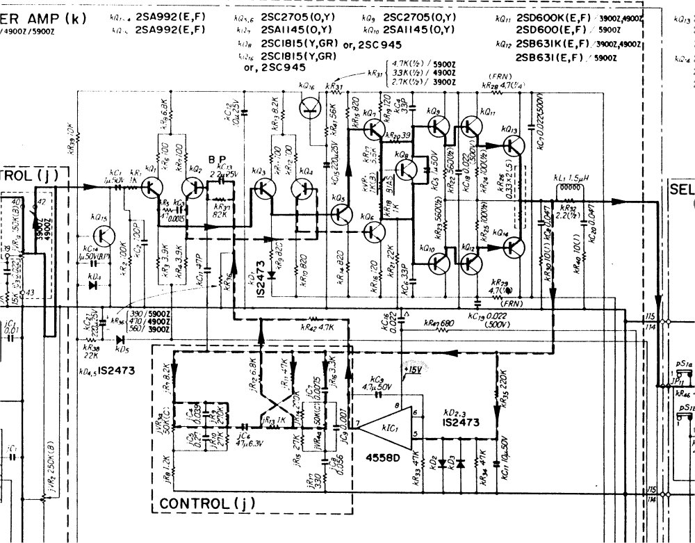

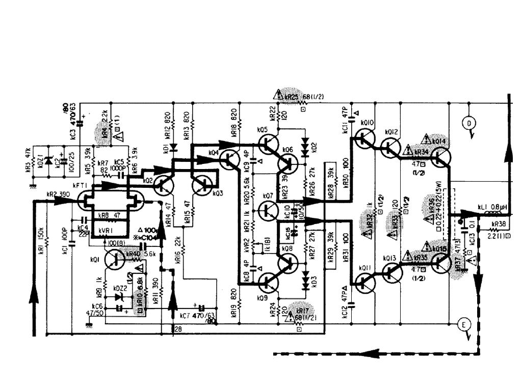

That was probably the Sansui marketing department who called it so, the name appears here in 1979 :
Ralisation d'un amplificateur classe A de 20W
Historically interesting, in the same article, there is the schematics of one of the first CFA of the word, the Hiraga's class A power amp, which input circuit configuration is now known as "diamond".
Amp which input circuit configuration use buffer with common collector complementary pair (diamond buffer) named: 'diamond amp'
Amp with emiter connected full complementary differential circuit in second stage named: 'diamond drive'.
Sansui use non symmetrical j fet input in 'Sansui Diamond Drive' and I use symetrical full complementary dual differential input circuit named 'Apex Diamond Drive' 🙂

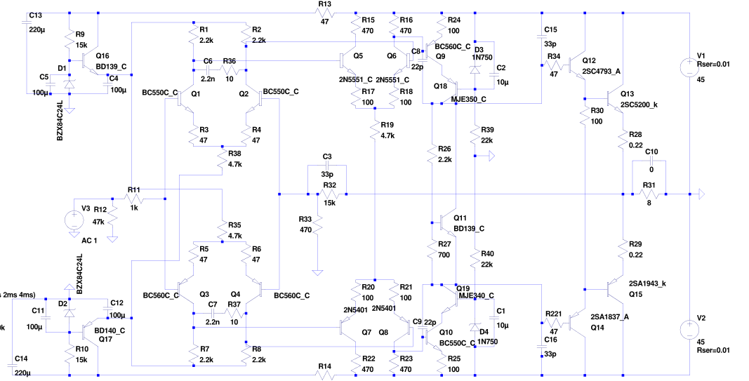

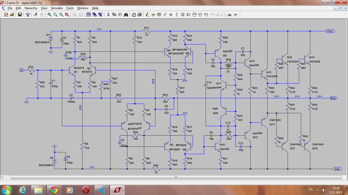

I have checked:
x50 - front stage
x20 - second stage
- VAS - single transistor
Above configuration was stable, no oscilations but clipping above 4k with sine (with square was ok) was very bad.
The enhanced cascode has had better performance on measurements so I am going to test it on monday. Bellow corrected test board an schematic (gains will be checked at real amp to get best performance).

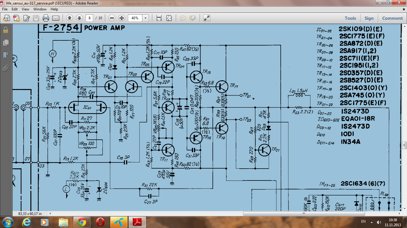

I use similar topology (pure push-pull vas) in AX11, it can be upgrade with j-fet input stage like in Sansui AU317
Quad Complementary Pair Transistor MPQ6700 can be used in input stage if available.

If compare GLA (Sansui Z3900) and this HD50 in progress amps are similar only HD50 is symmetrical, amps use 2 bjt differential gain stages with local NFB. Sansui Z3900 use gain 39X in 1 stage and 8,2X in 2 stage, this give good stability with almost any usual transistors in DIY.Been following this as well as this http://www.diyaudio.com/forums/solid-state/243842-gla-good-little-amp-survivor-8.html. It would be nice to have someone compare these amps

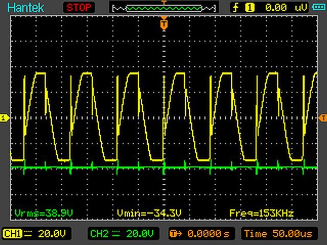

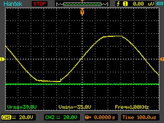

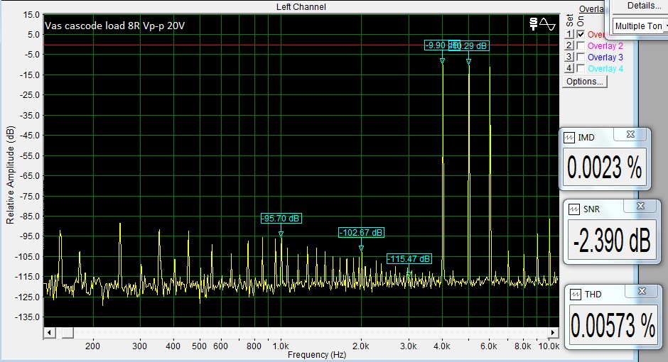

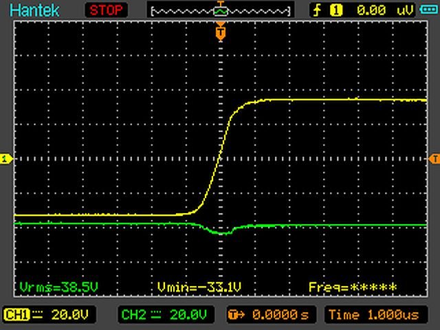

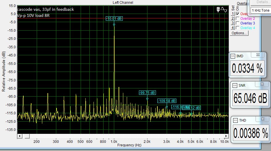

Another day of testing. I must say that it is not easy to stabilise fully the amp.
Bellow:
-1st stage x22
-2nd stage x4.7
-vas - standard cascode with zener 5.1 (bypassed with 4,7uF)
-feedback cap 33pF
What I like:
-sound of it
-the sound comming out of it
-sound
-and sound
-apex dd drive
What I do not like so far:
-clipping with siuns signal over 4kHz (square looks fine)
-I can not use the biggest advantege of it - ability to get very high gain at first stages (If multiplied gain of 2 first stages goes close to 200 it is hard to stabilise - for me).

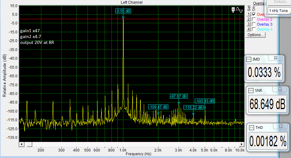

Bellow
gain1 at 47
gain2 at 4.7
compensation cap 33p
I think my sound card is not able to measure distortions anymore.
Perfection need time 🙂
Regards
With symmetrical 2 stage circuit diamond drive VAS directly without add pure push-pull circuit (Q5 on Sansui Z3900 circuit)

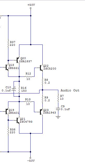

did you try TEF output stage from post #71 ?
Yes ofcourse I have tryed it. It performed not as good as cascoded one, higher thd measures, harder to get it to stabilise but it sounded kind of better (maybe due to different thd spectrum). Another think is that cascode version is keepeng low thd up to very high output amplitude (tef version thd is rising with output amplitude). It looks like the voltage gain there is important.
I had to keep 100pF in feedback with TEF version.
Did you try cascode VAS and TEF output stage?
Mile
My mystake, I did not tryed TEF stage, I have tryed only the basic setup (same as bellow but without Q18 and Q19).
I tryed enhanced cascode and standard one --> I can not see any difference on the measurements. I still have the 1st protototype so will try the TEF this week.
The CFP can be tested too, but for now I do not have much time.
Another small question - can bias the cascode transistors with one resistor ? (R39 R40 --> put one instead and disconnect earth connection )
Yes, this don't change anythig.
missing 1000uF cap
where is the 1000uF feedback cap, at your schematic it is missing...?
As I know we can omit it when we using DC-servo 🙂
Regards
