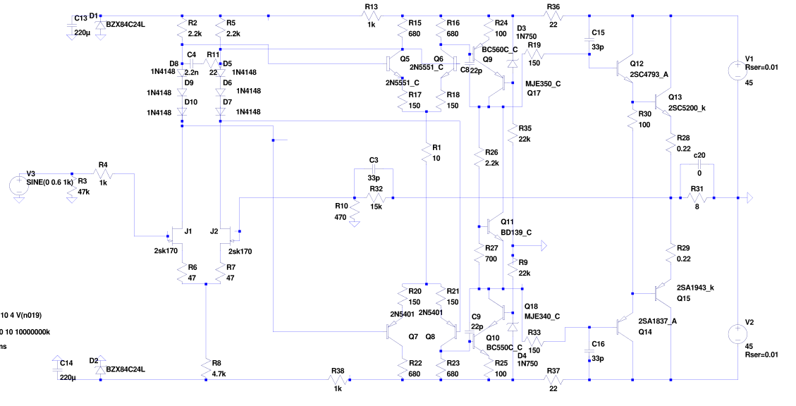

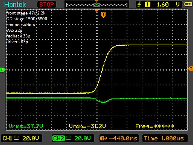

I have upgraded slightly my previous board to single j-fet input.
Config:
-j-fet input (47R/2.2k) around 4mA total
-DD (150R/680R) 5mA
-vas cascode (standard not enhanced) 9mA
-darlington output 150mA
Mile if you can take a close look and tell me which area will need improvement please.
Maybe higher freq thd needs some ??
Can you post schematic with compensations?
The prints from 2 posts back are from amp exacly as bellow. Prapobly tomorrow I will test different setup. With single pair of outputs I will use as simple as possible circuit (if only will pass all tests).

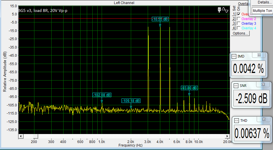

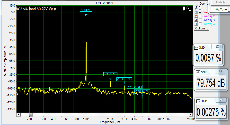

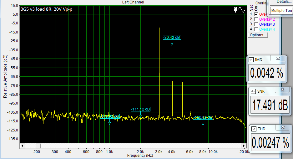

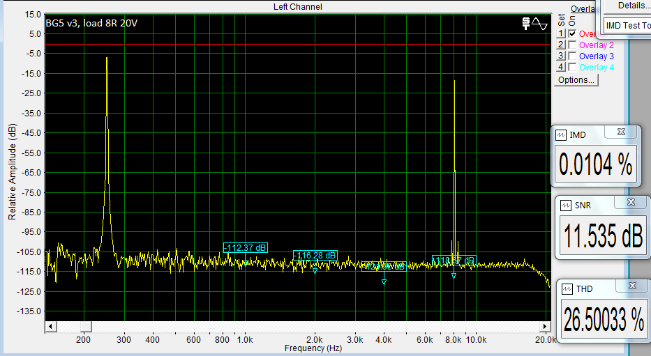

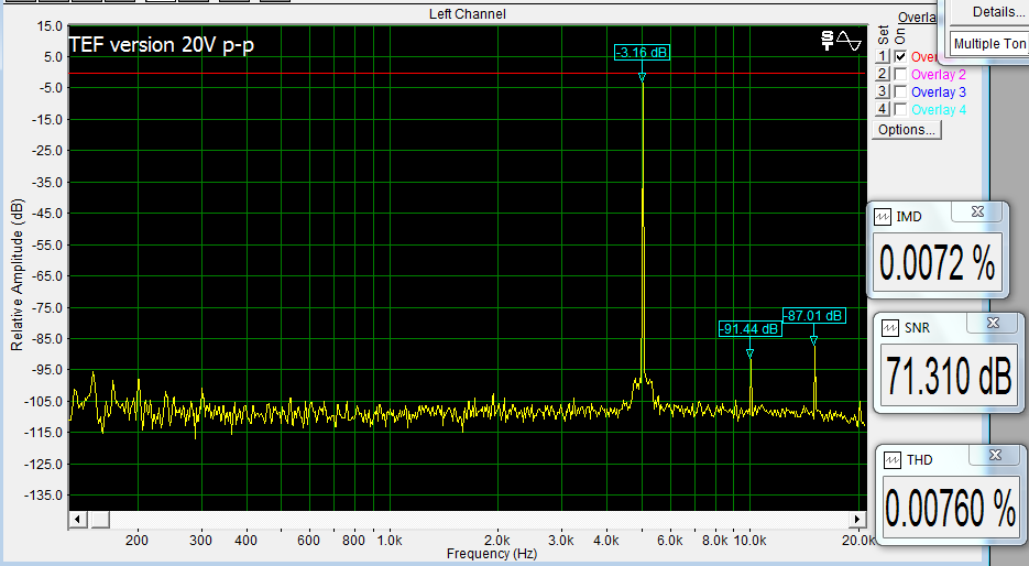

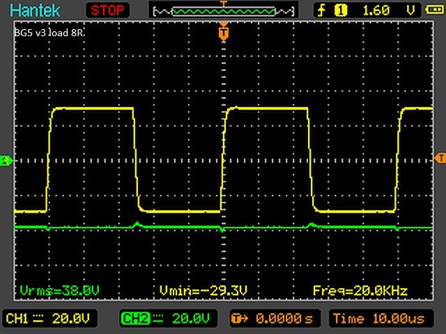

Today another day of hard work.
I have changed config a small bit:
-input stage 220R/2.2k
-DD stage 22R/680R
-VAS compensation 10p each, feedback 33p, drivers 33p.

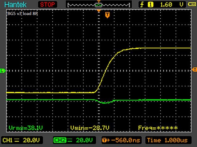

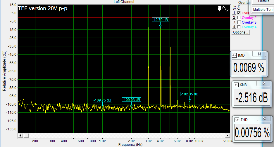

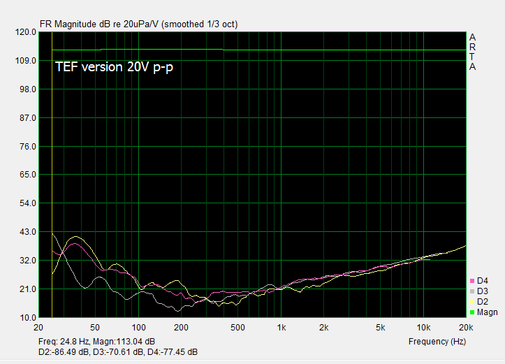

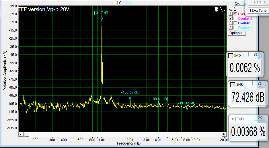

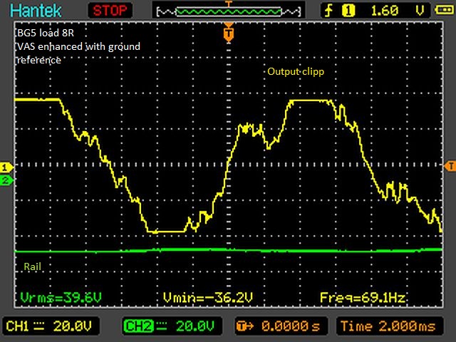

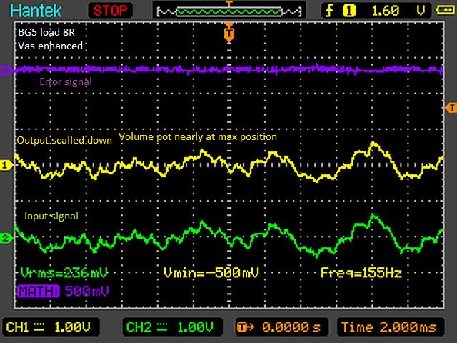

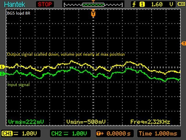

The clipping issues are gone!! So in next few days I will do the cosmetics on the amp only. The harmonics spectrum is OK (I think). I am missing higher order harmonics --> would be recommended to have a small amount of 4th and 5th harmonics too ?
Bellow results. The previous version SR is on the last scope reading.

Nice results, SR over 20V/us is ok for me.
Regards
OnAudio

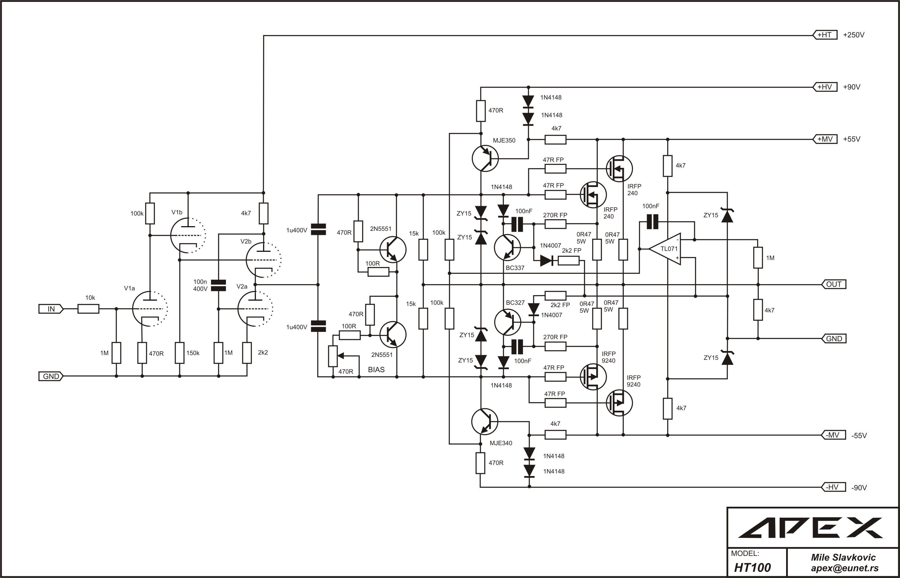

apexaudio
I have one prototype with TEF atatched to single transistor vas so will try it.
I will prapobly make 2-3 output stages on separate boards to speed up the work 😛

This company is unknown for me, can you post schematics?
