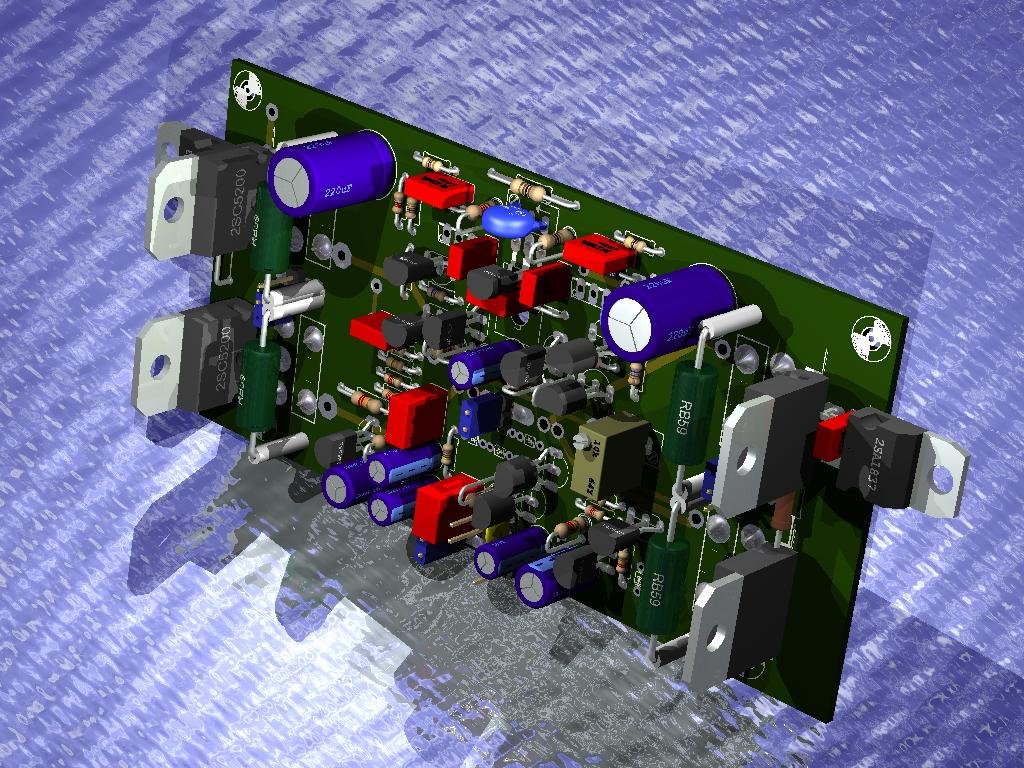

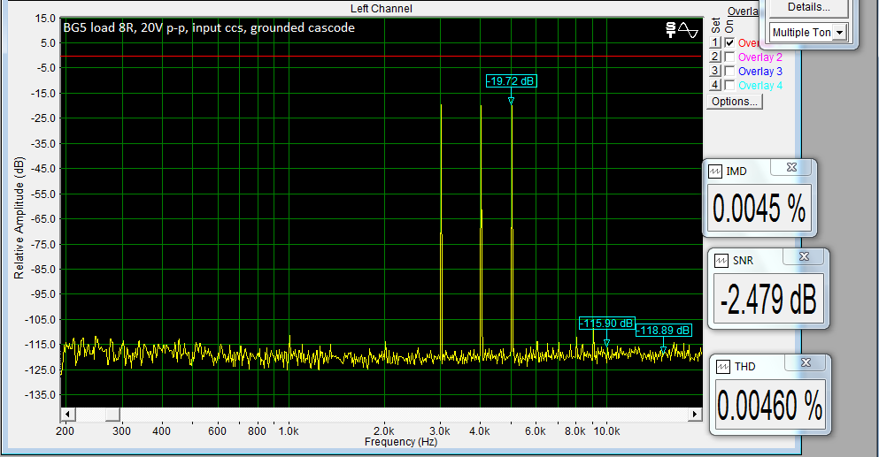

I have made small changes and will prepare a final pcb. Nearly all produsct are going 100dB bellow signal - so it is good enough. Amp has good parameters from low output till clipping - all power spectrum.

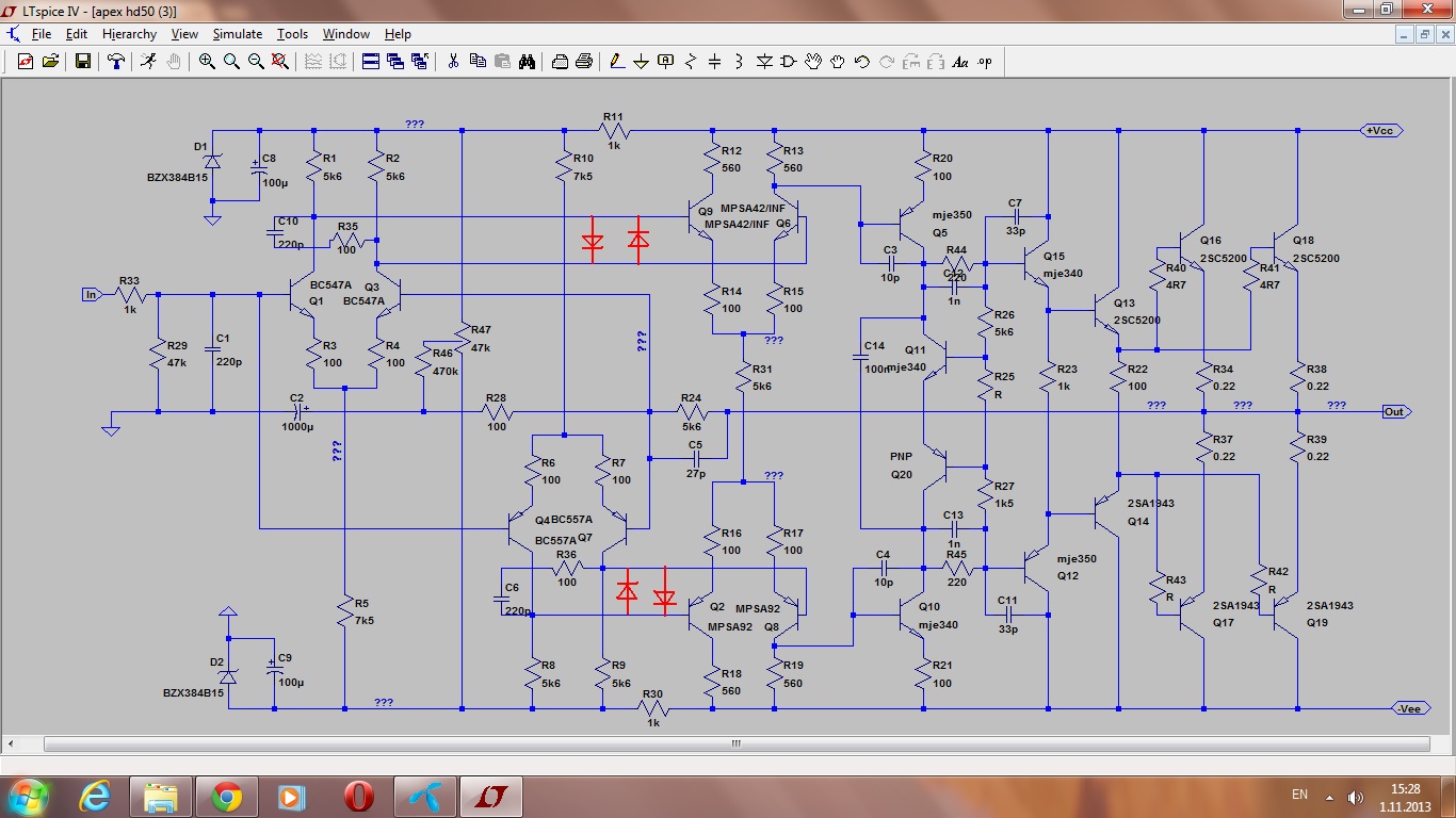

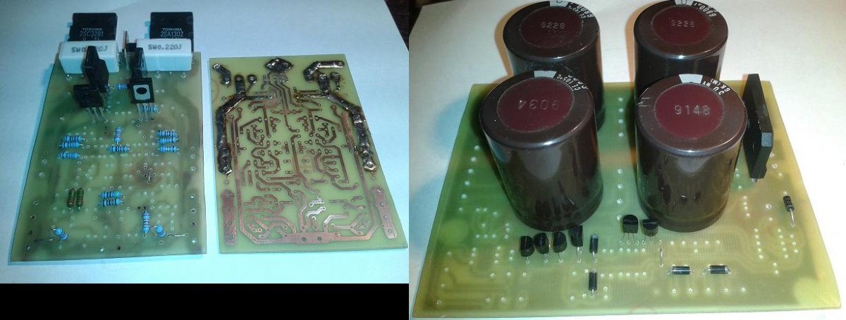

The BG4 was with 2 LTP's at the front of the amp (development has stopped cause lack of my knowlage to sort out clipping issues). BG5 is version with single j-fet LTP at the front of the amp. So far it looks like on schematic bellow.
I just substituted two zeners in cascode with double leds. After I will do all tests Ill post whole documentation anyway.
Regards

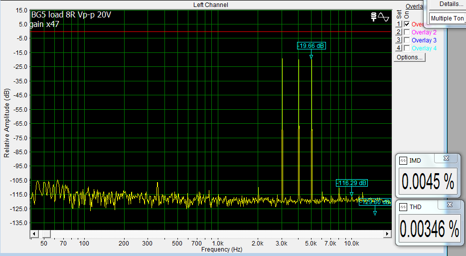

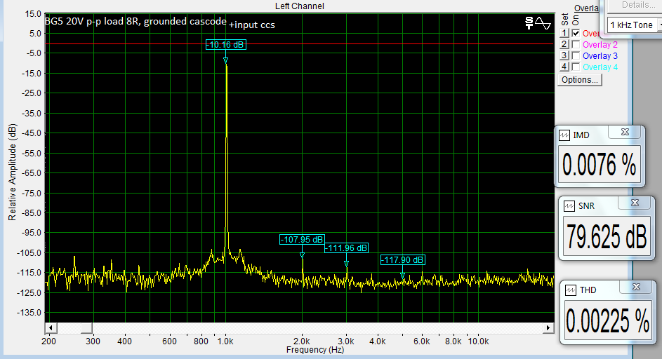

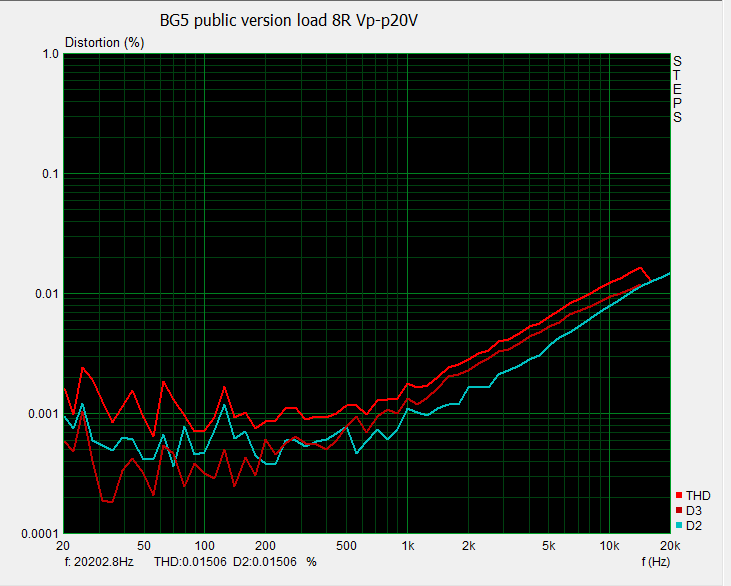

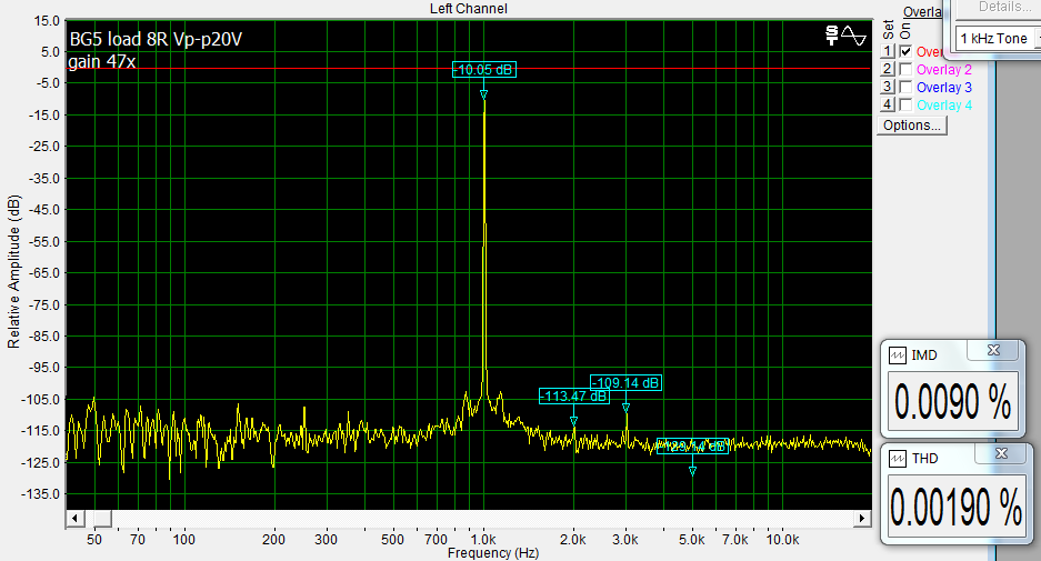

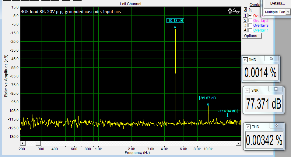

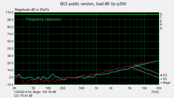

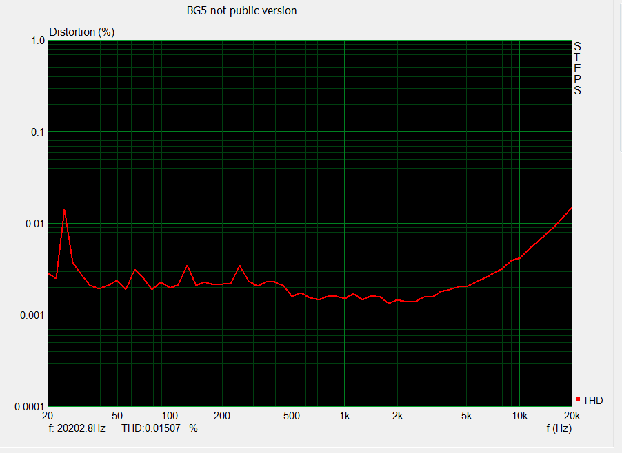

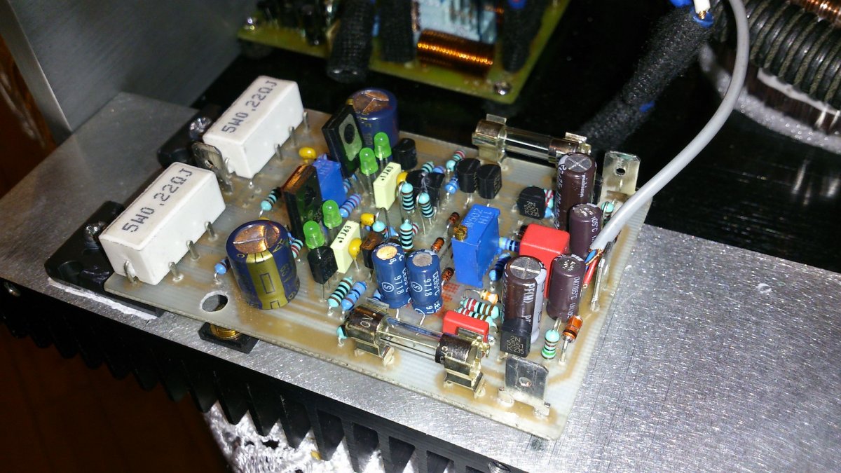

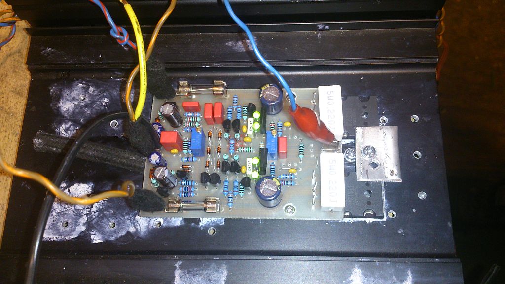

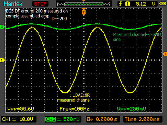

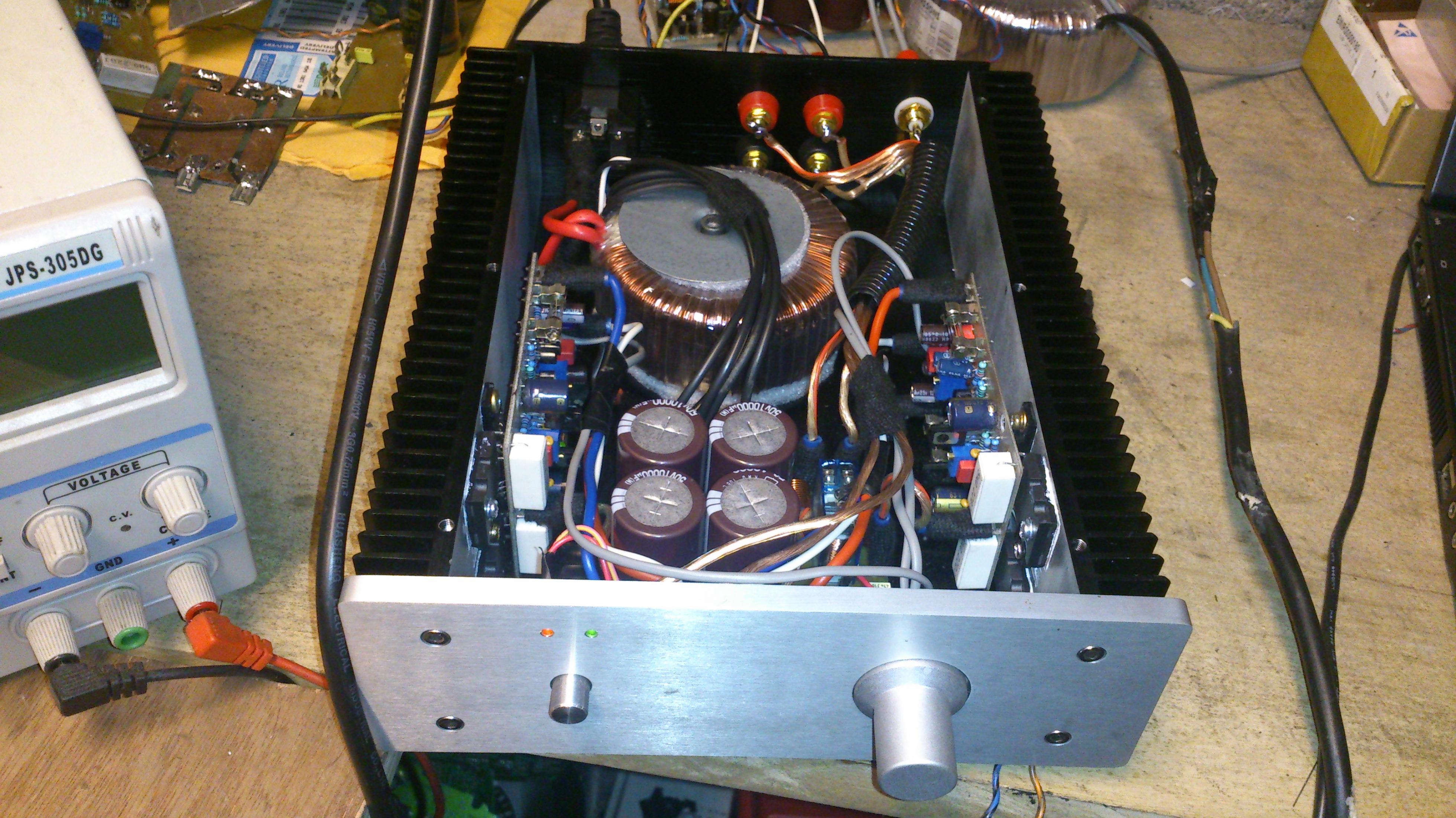

Small update, I have managed to stuff the enclosure with amp boards (two different versions Left and Right). Now i will have to make a listening test to make sure that all is OK.
DF was measured on finished amp after protect relay and inductor coil. I have seted the gain at x47 cause I am not going to use any preamp. After I will listen to It for a while I will post all schematics, thermo-transfer files etc.
So far it looks like bellow.

Borys did you try to add 4x1N4148 on this prototype?
It was so long time ago that I do not remember, but it should help a bit, sansui was using some diode clamps at the VAS stage as far I remember. Maybe the diode clamps at the DD stage will be more helpful ??
Your desingn with 4 LTP's is very good, low Vce transistors can be used in all LTP's.
I have had MJE340/350 at the VAS stage and they are a bit slow recovering from saturation (sticking), better transistors here would help too.
